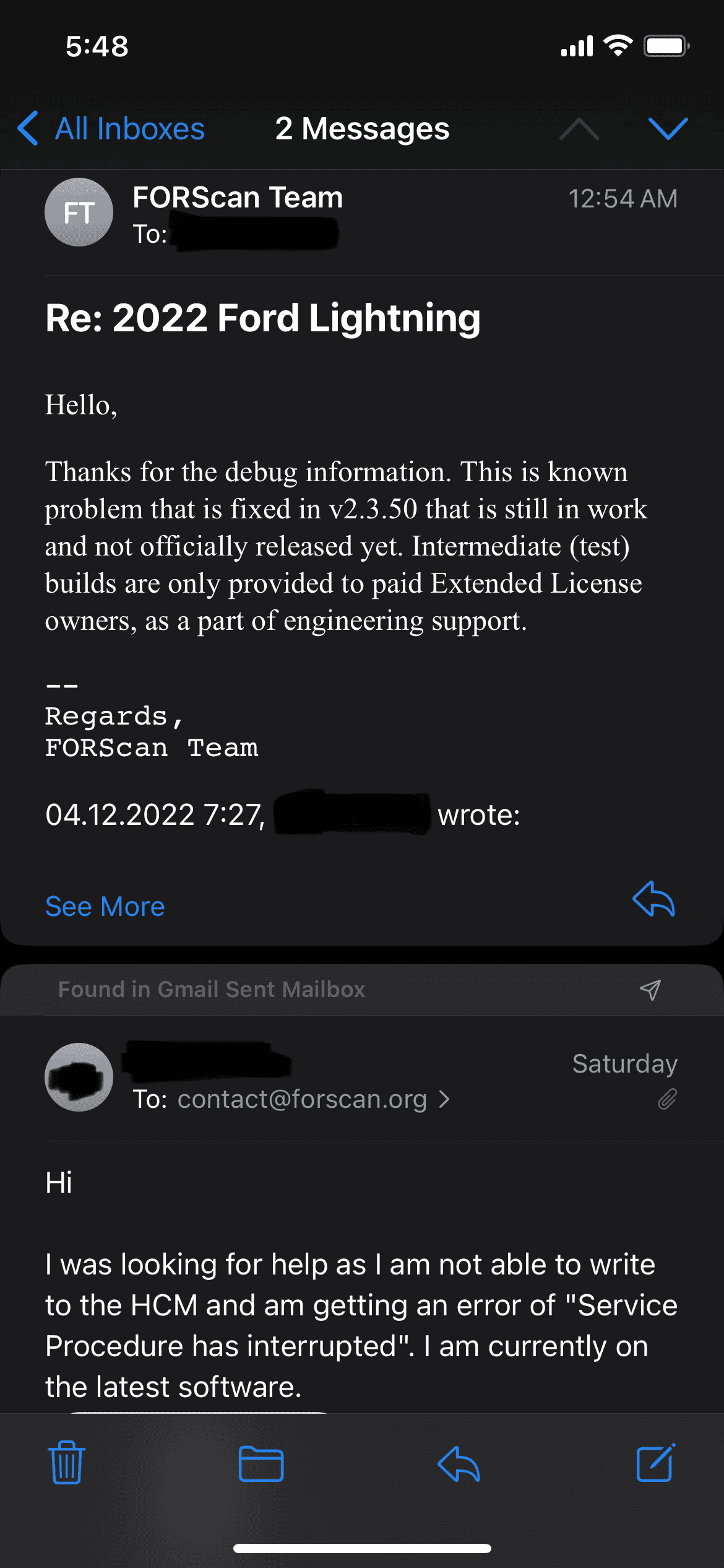

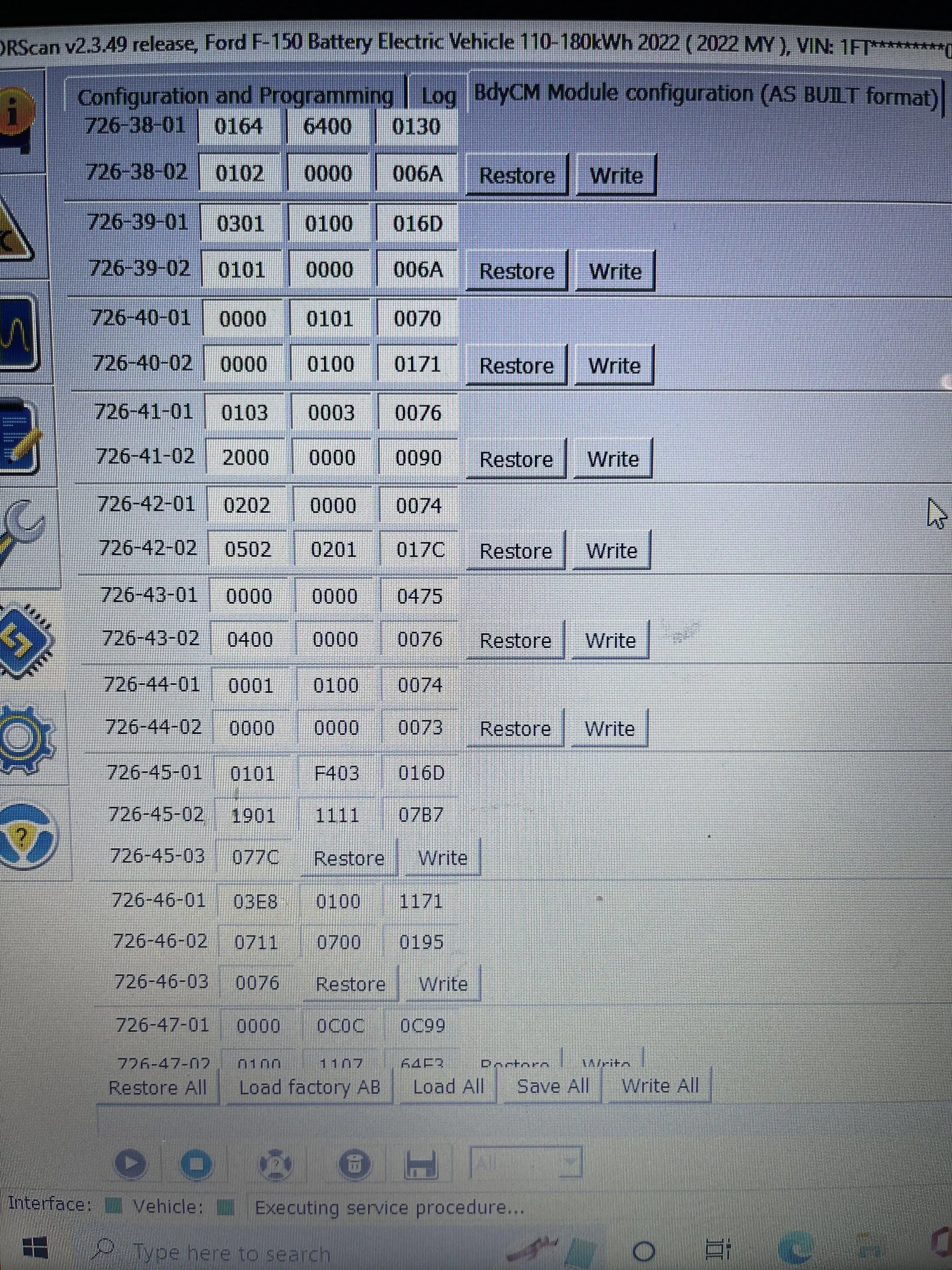

I'm having an issue with HCM changes for the glare free lights. All the other modules were able to be changed with no issues. I changed the lightbar, the seatbelt chime, the global windows, and all of the other modules for glare free, just not the HCM changes. "Service procedure has been interrupted" in the log every time I try.
I have an extended range lariat. Not sure of the build date. OBDLink EX cable. Using v2.3.49. Should I contact forscan or is there another possible fix I can try first?
I’m seeing the same error trying to modify the HCM module. I have the same cable and software version. Hopefully there is a fix to get the Glare Free headlights.

Does anyone by chance still have the 2.4.6 beta from Forscan they can upload? I’m thinking the current version is the issue I’m seeing with writing to the HCM.

Received a response from Forscan. Looks like the current software is the issue that we can’t write to the HCM. I can’t get the updated beta software since I’m not a paid user. Could anyone help with that?
I have not asked for an update in a while, but maybe worth the $12 to support them. I believe that is all it was a few months ago when I signed up. Well worth that to make these updates to my truck.

I bought the extended 1 year license and can confirm the new software fixes the issues writing to the HCM. I made the changes to add glare free lighting, remove the double honk when leaving the truck with it running, and one other add on option that I will create a write up for hopefully this weekend. ;)
