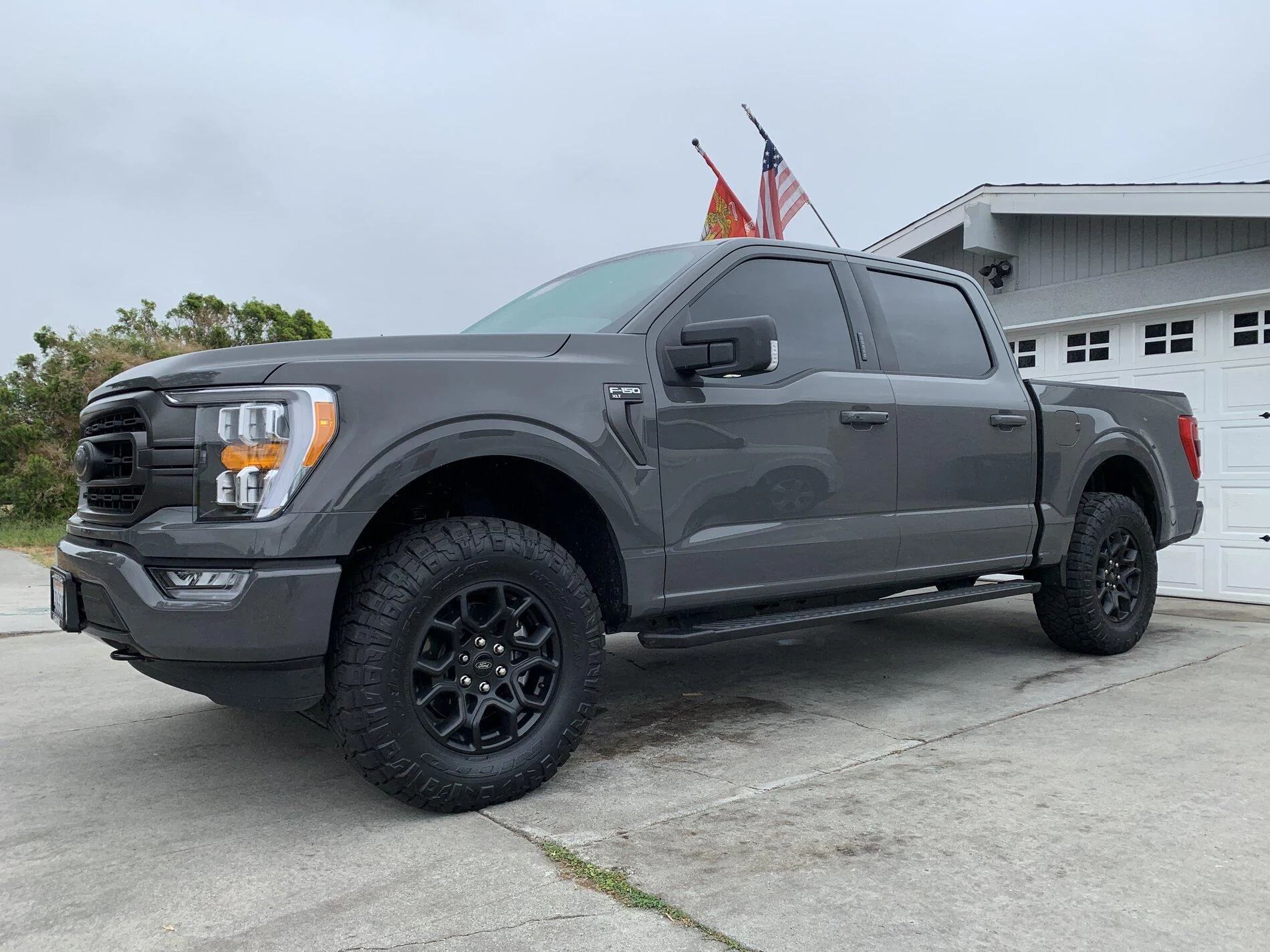

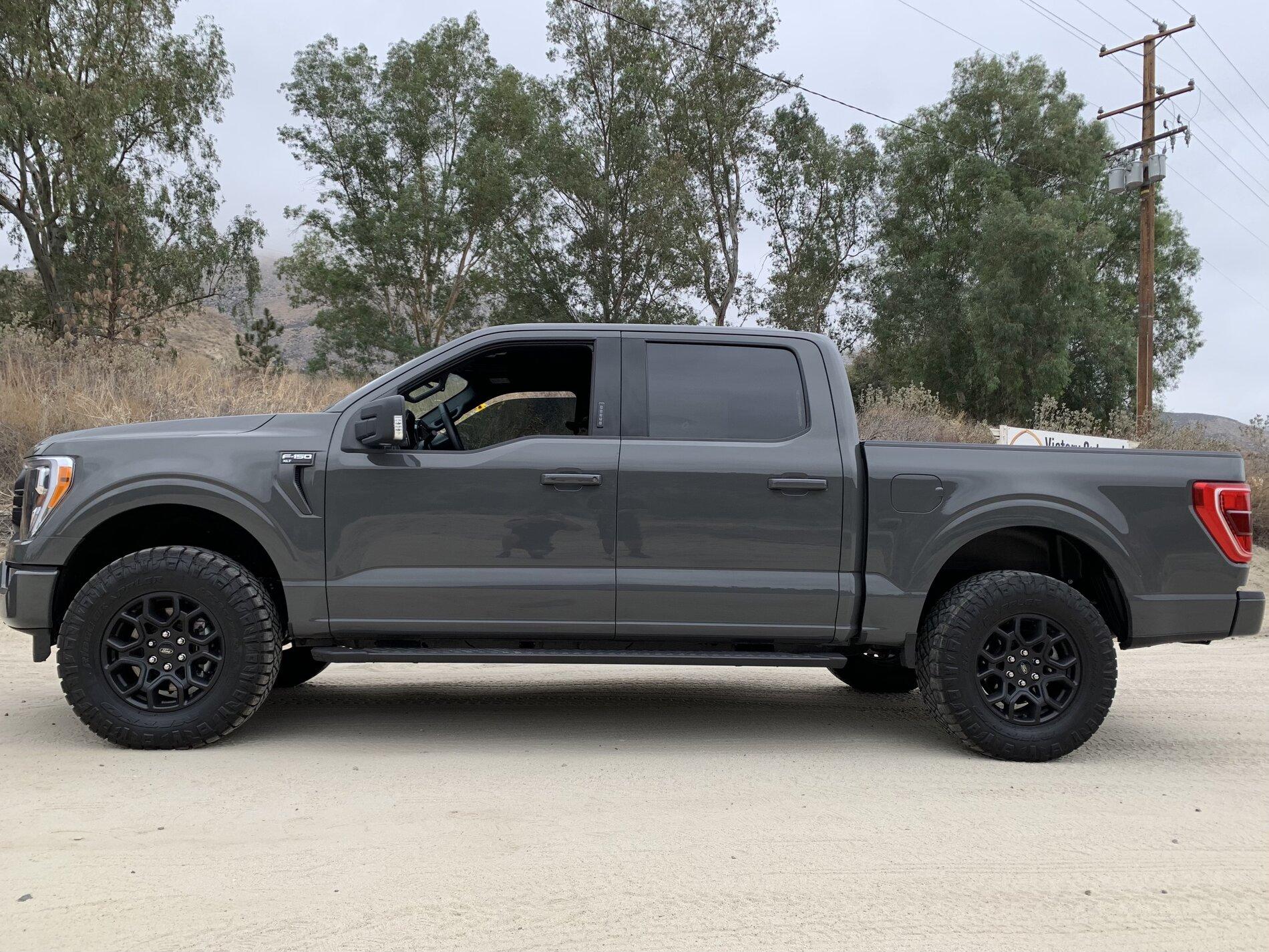

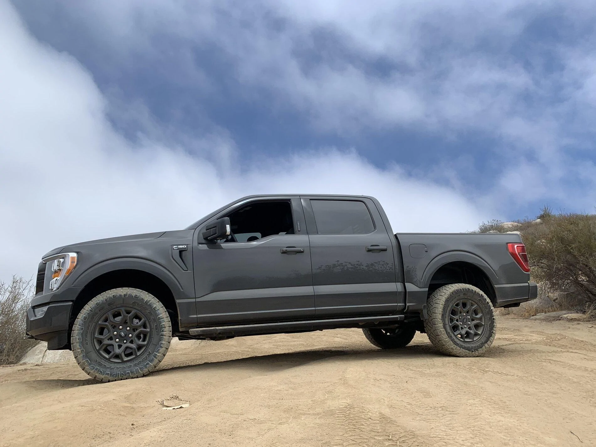

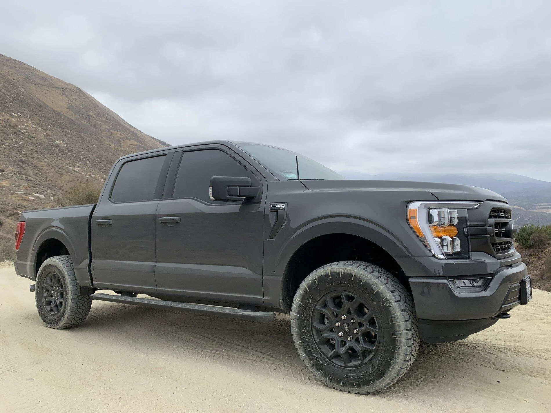

More pics of blacked out stock 18inch sport wheels with 295/70/18 nitto ridge grapplers.
I thought those were Tremor wheels at a very quick glance. Looks amazing! Extra glad I went with the 18"s if I want to go this route in the future ?
Thank you! I love the tremor/raptor style wheels and these look very similar in design. Black them out with $30 worth of plasti dip and you have a very similar look at almost no extra cost since these wheels come with the truck. I love the end result!

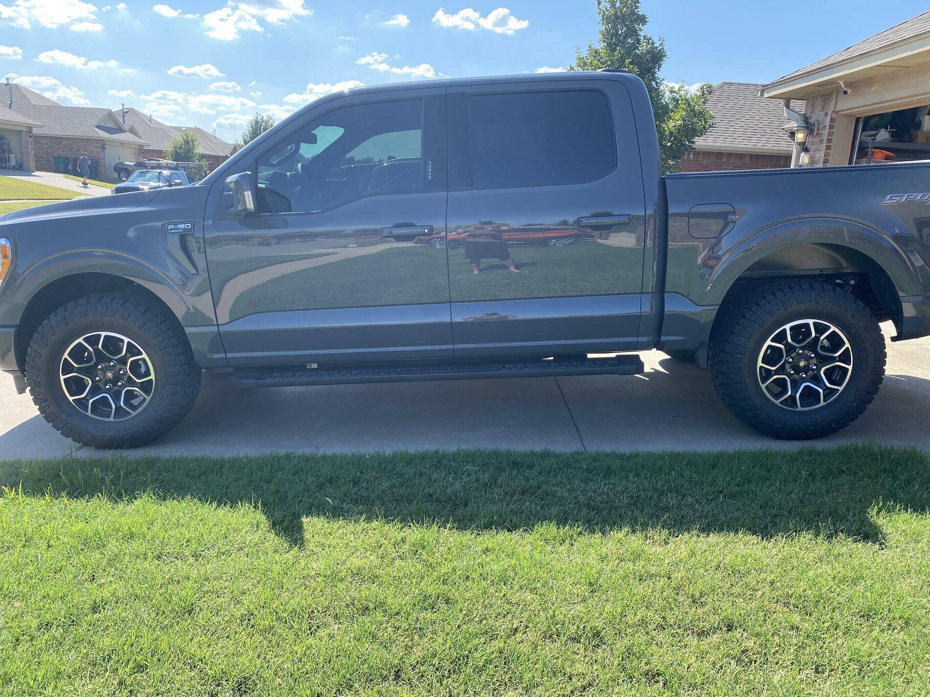

At discount tire, changed my mind to Ridge Grappler 295/70/18… taking bets to see if it fits at this time..

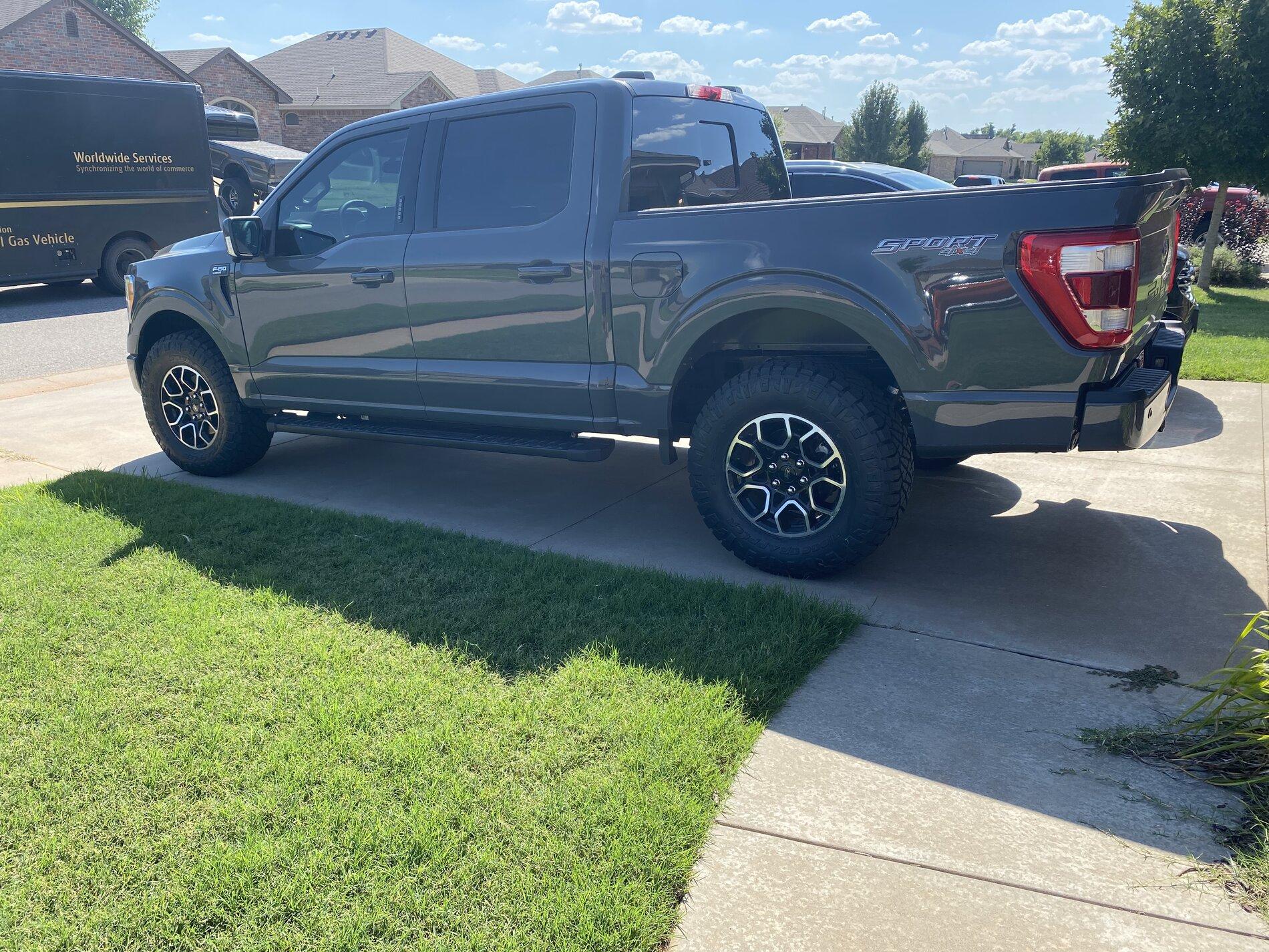

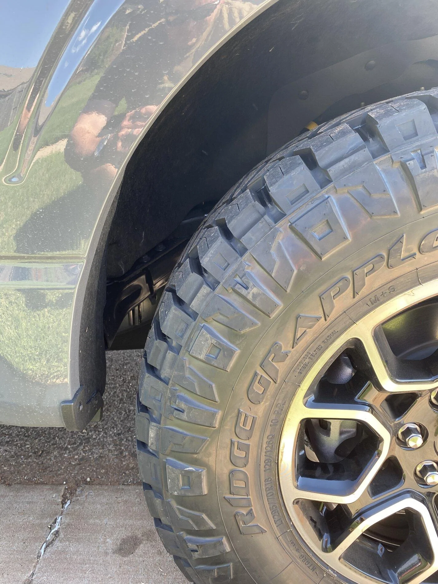

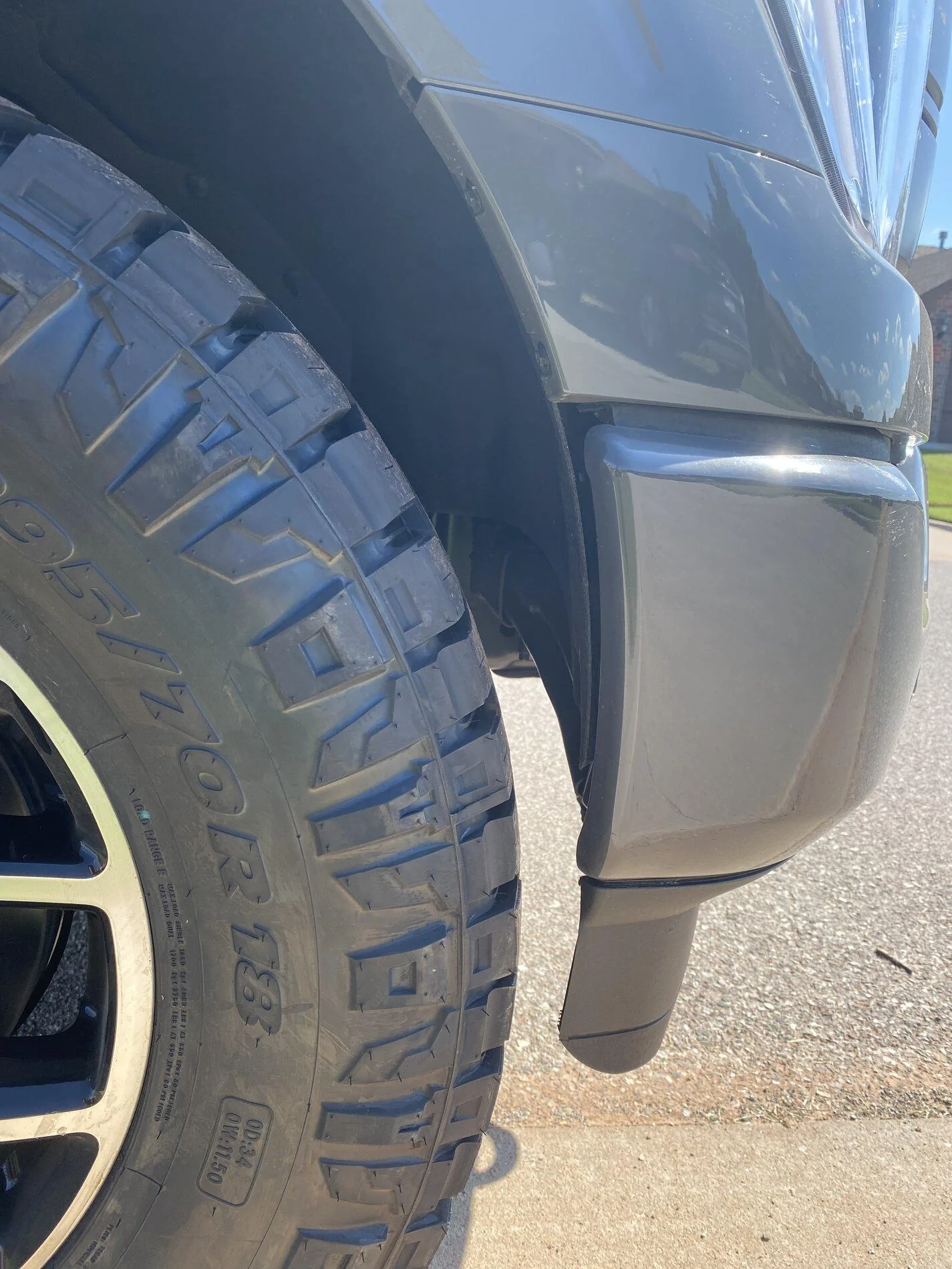

One tire on. No rubbing at all. Lots of clearance. He said I’ll know if it will rub when I back out when the suspension flexes. Looks like the place that would rub is those little plastic things whatever they do.
Tires were 350.00 each, price matched to 330.00 and then 10% military. Out the door for 1400.00. Hoping to sell stock takeoffs for 350-400 to eat the cost.

Also keep in mind I have the 2.7, not sure how much difference in height between heavier engines but something to note.

I’ll make sure to get a bunch. I’m not patient so I went for this size. It’s all they had in stock other than the Falkens I ordered. The Falkens are nice but I feel I was chasing a deal as they are way cheaper.
Then I was set on grapplers in 285/70 which would be 60lb a tire and roughly 34 inches tall. 295/70 is 70lb a tire and I believe 34.2 high and a touch wider. Kind of splitting hairs but I’m more worried about the extra weight all in.
