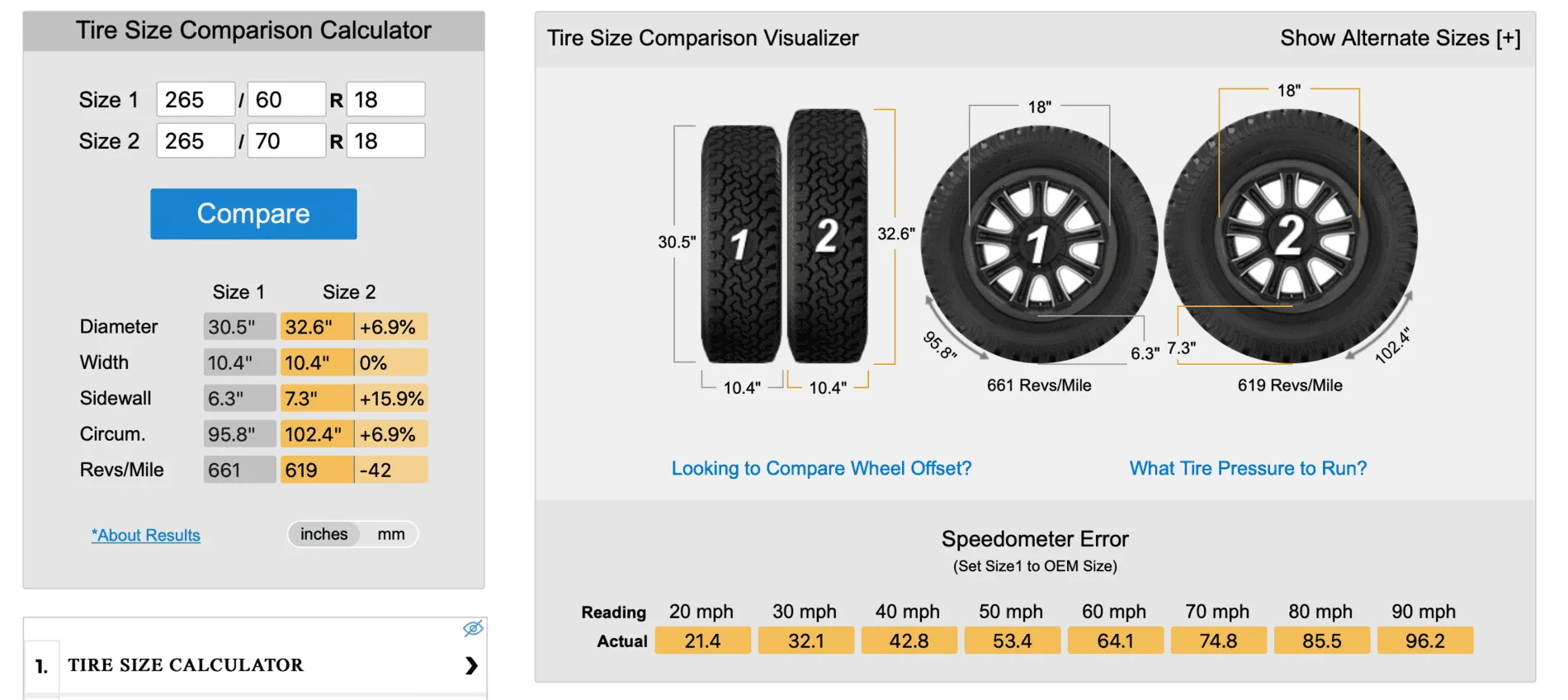

I haven't seen anyone with that size, but it will definitely work without a level.Has anyone tried 275/70-18s on the factory sport 18" wheels? They have a 33" diameter like the factory 20" wheels/tires. I'm not interested in offroading, just want more sidewall.

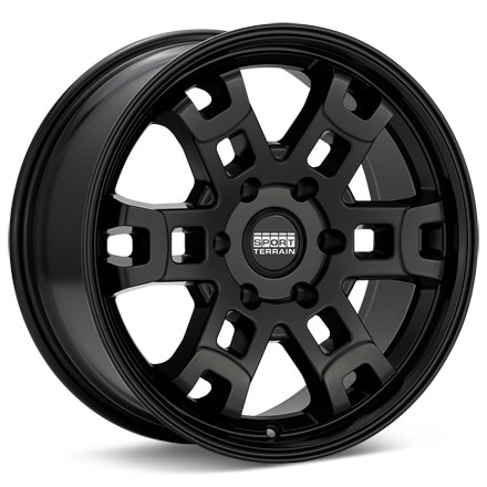

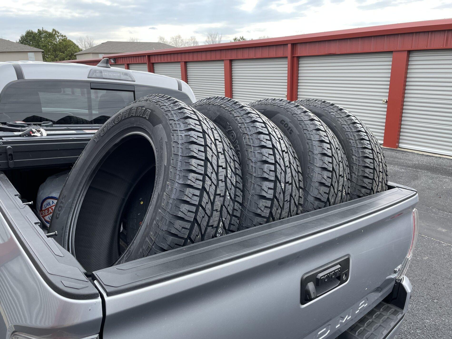

Hi bigskydu,Just bought +20mm Sport Terrain ALPINE 18x8 wheels with LT275/70R-18 GENERAL GRABBER A/TX E tires. Should fit stock ride on a 2021 F150 Platinum FX4. Hopefully!
Wheels: Sport Terrain ALPINE Black Painted 18x8
Tires: https://tiresize.com/tires/General/Grabber-AT-X-275-70R18.htm

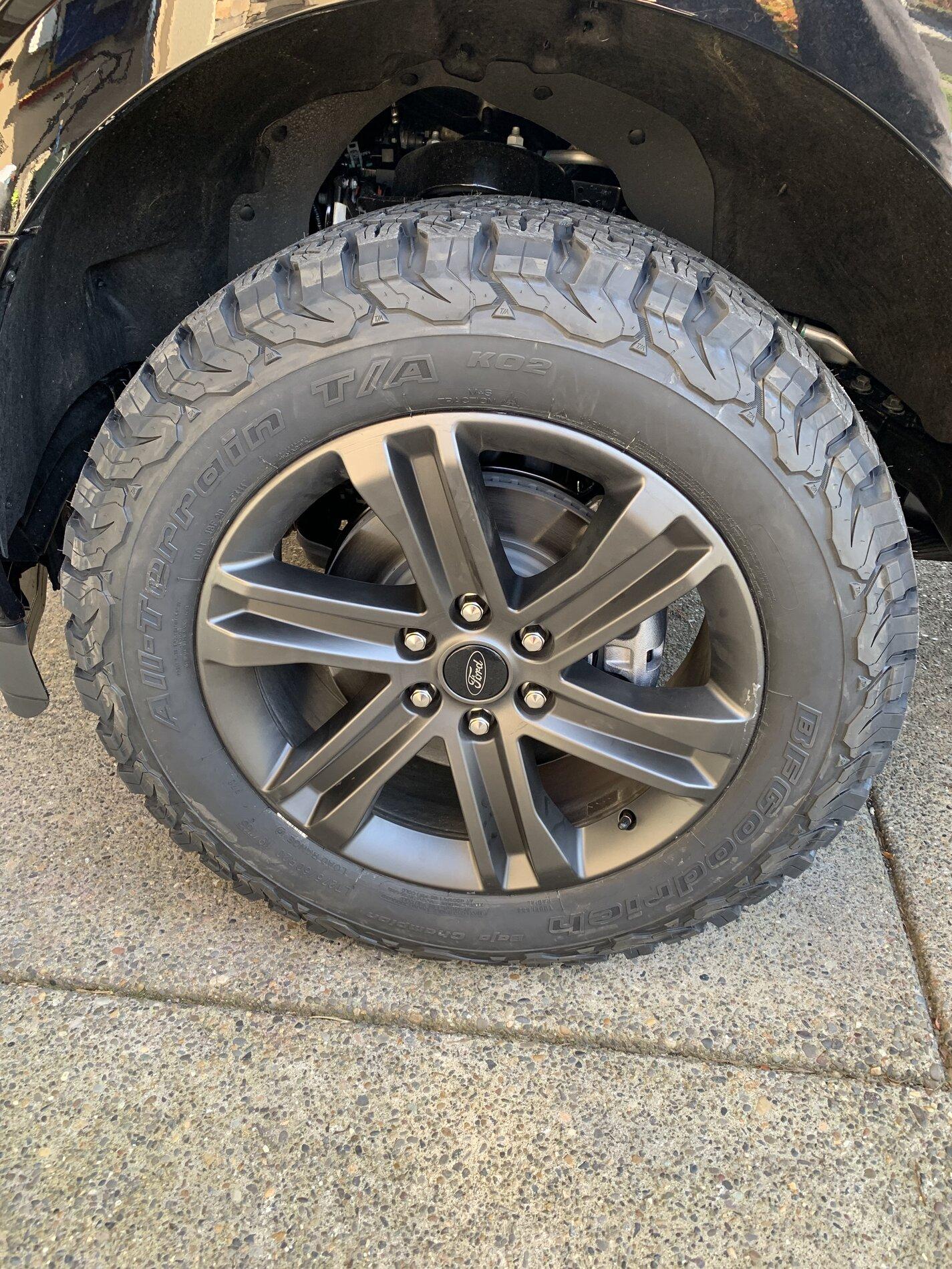

Leveled? Do you have a picture a little further back? Nice look.Swapped out stock Hankook’s with BFG KO2’s of the same size (275/60R20)

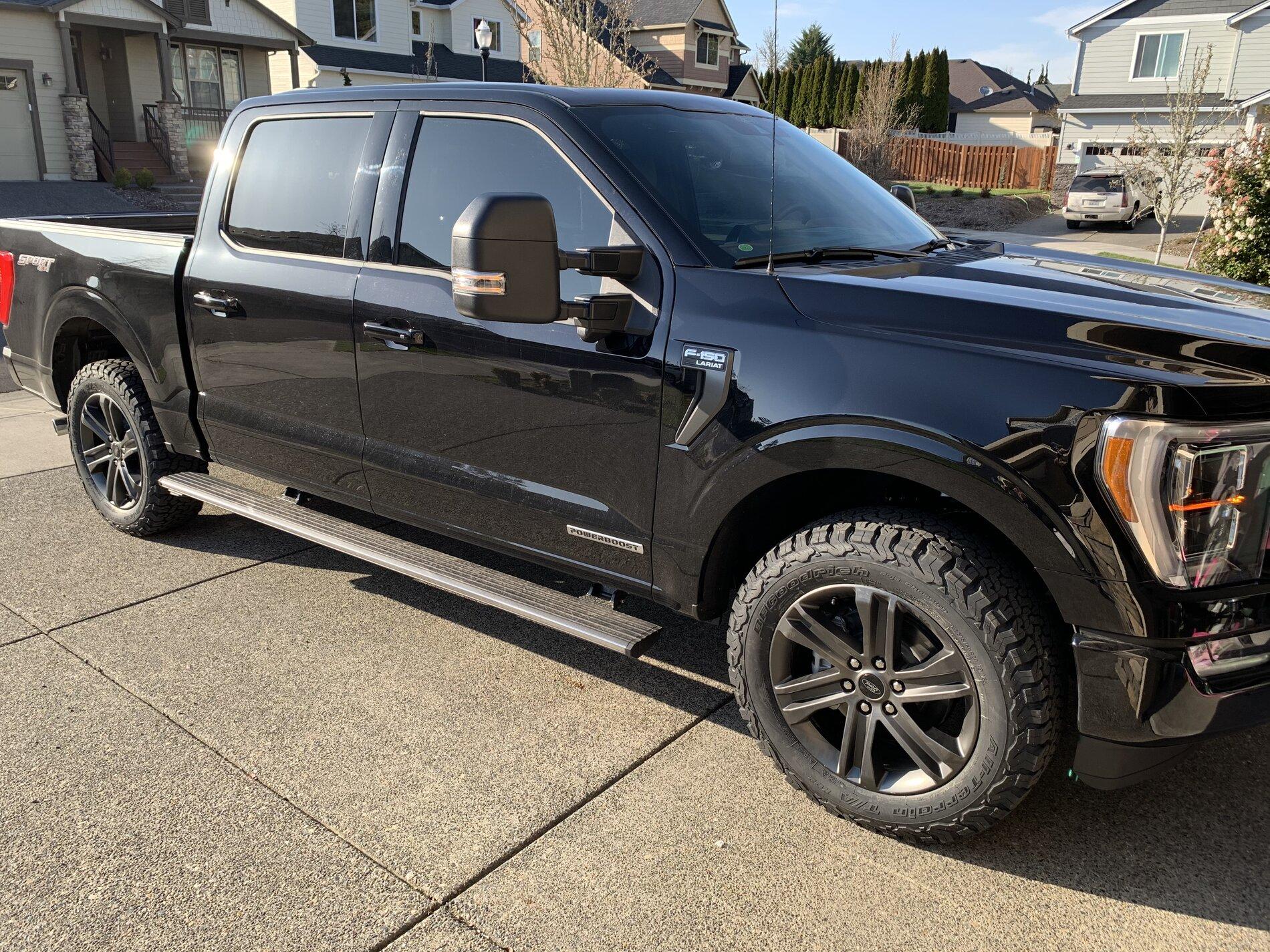

not leveled yet. I wanted to roll stock for a bit with stock sizes while I tow through the hills and see how clearance is. Once these run through I’ll go wider and bigger sidewall with a level. Although I may level earlier than that.Leveled? Do you have a picture a little further back? Nice look.
Beautiful Truck. I love the more aggressive look of those tires on the stock wheels. Picking mine up in 2 days. Carbonized Grey with the same wheels. Had the dealership change the tires to the Falken Wildpeak AT3W which have a similar look to the BF Goodrich.not leveled yet. I wanted to roll stock for a bit with stock sizes while I tow through the hills and see how clearance is. Once these run through I’ll go wider and bigger sidewall with a level. Although I may level earlier than that.
