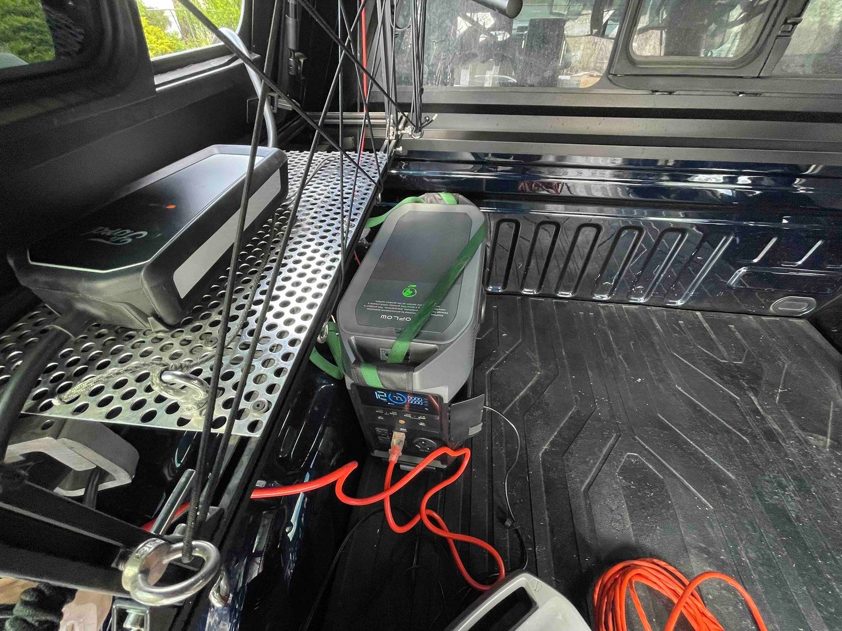

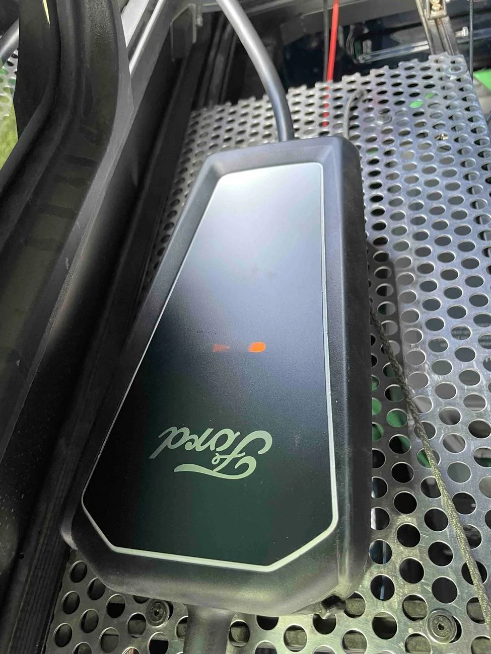

I'm color deficient... Here are photos after it stopped charging after delivering 400 Wh in 20 minutes.
Plugged the Ford EVSE into the garage house power next it was still charging after delivering 800 Wh in 40 min.

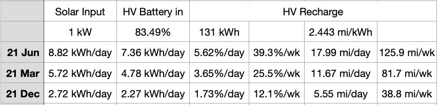

Assuming it's 96% efficient to charge the Ecoflow's battery from solar, harvesting solar to charge the truck about 83.5% efficient. My 250W panel has 21.3% module efficiency. With perfect a perfect solar day and 1 kW truck roof solar, you can get back 5.6%/day in the summer and 3.7%/day in the spring and fall.
If only F natively supported solar recharging the vehicle's LVB as a buffer battery, then DC-DC converting to recharge the HVB.... we wouldn't have this extra 100 pounds in the bed and the need to get that EVSE out. Maybe in their next electric truck?
Next, upgrade the truck roof solar with a few more panels. I still need to figure out how to automate turning on the buffer battery's inverter to realize the daily recharges beyond the buffer battery's capacity.
Table. Camping solar charging at 40N with truck roof mounted 1 kW solar
