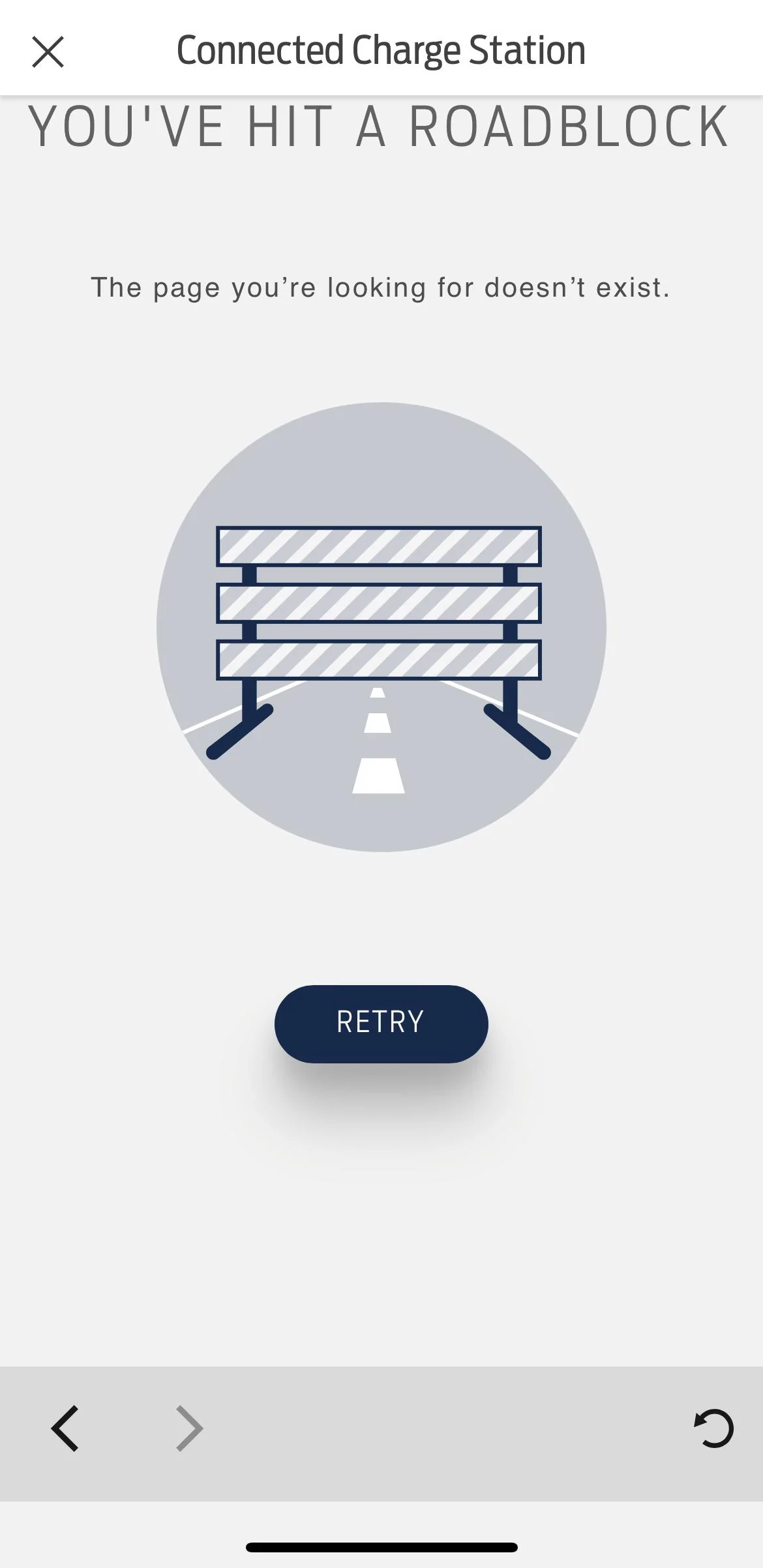

I have the charge station pro set up and connected to the Ford Pass app. When I click on connected charge stations and hit “insights“ I only get an error saying “you’ve hit a roadblock”. what am I supposed to use the connected charge station on the Ford Pass app for?
Seems like there’s nothing to see.

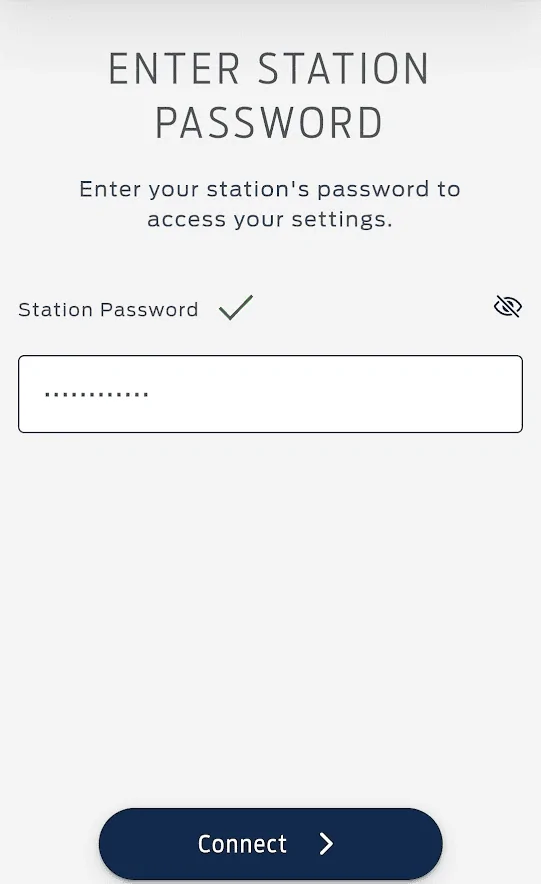

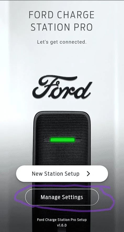

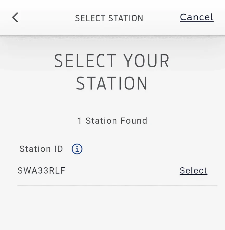

BTW, you can use the FCSP setup utility to log onto the FCSP directly via your wifi network to check the device software/firmware level see [ABOUT], if you can do this then your device is connected to your network.

One last thing is associating the FCSP to your Fordpass account/truck VIN, follow the prompts from the setup utility which will launch Fordpass to making sure they are associated.
