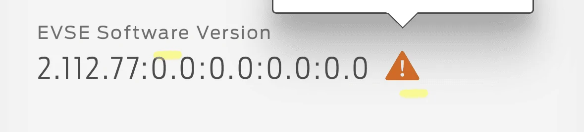

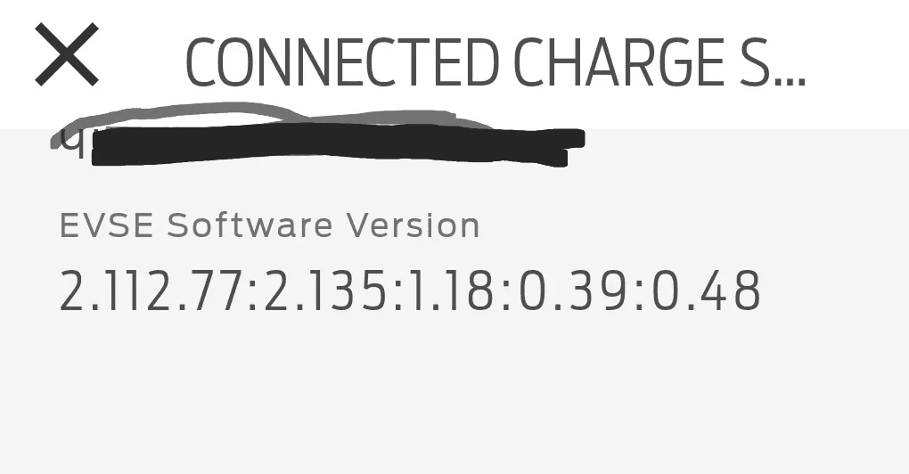

Looks like a new software version is being staged for update, I tried a shut down and restart, but it's still showing the same data on both the set up application and the Connected Charge Station set up screens, let's see what comes about overnight, I'm fully charged now and leaving the Lightning unplugged.

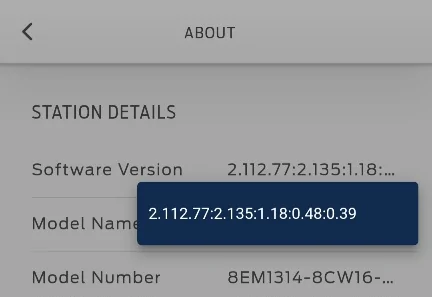

Interesting. I'm not showing an update pending on either FordPass or the FCSP app.
My software version is 2.112.77:2.135:1.18:0.39:0.48
That is what I had a while ago, looks like a roll back at the moment, I'll get screen shots in the morning and update the thread title to the newest version once it's posted.
After seven day this is still showing as the status after several reboots to no effect, the FCSP is on my network, but this update is not completing, has anyone else seen this version ?
Nope.

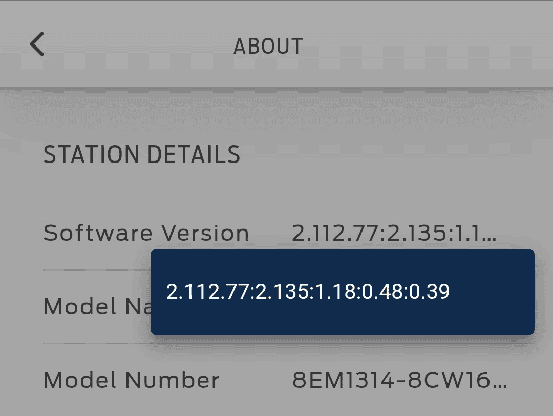

I’ve been stuck here as well, for at least a month probably. Everything is still working except I’m getting a few deep sleep issues again and the truck fails to charge each time.

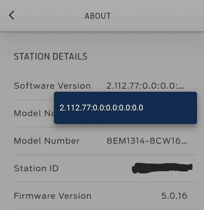

My FCSP EVSE returned to the prior patch level over night.
Thread title updated.
Ford F-150 Lightning FCSP Software Version 2.112.77:2.135:1.18:0.39:0.48 1683237618776
