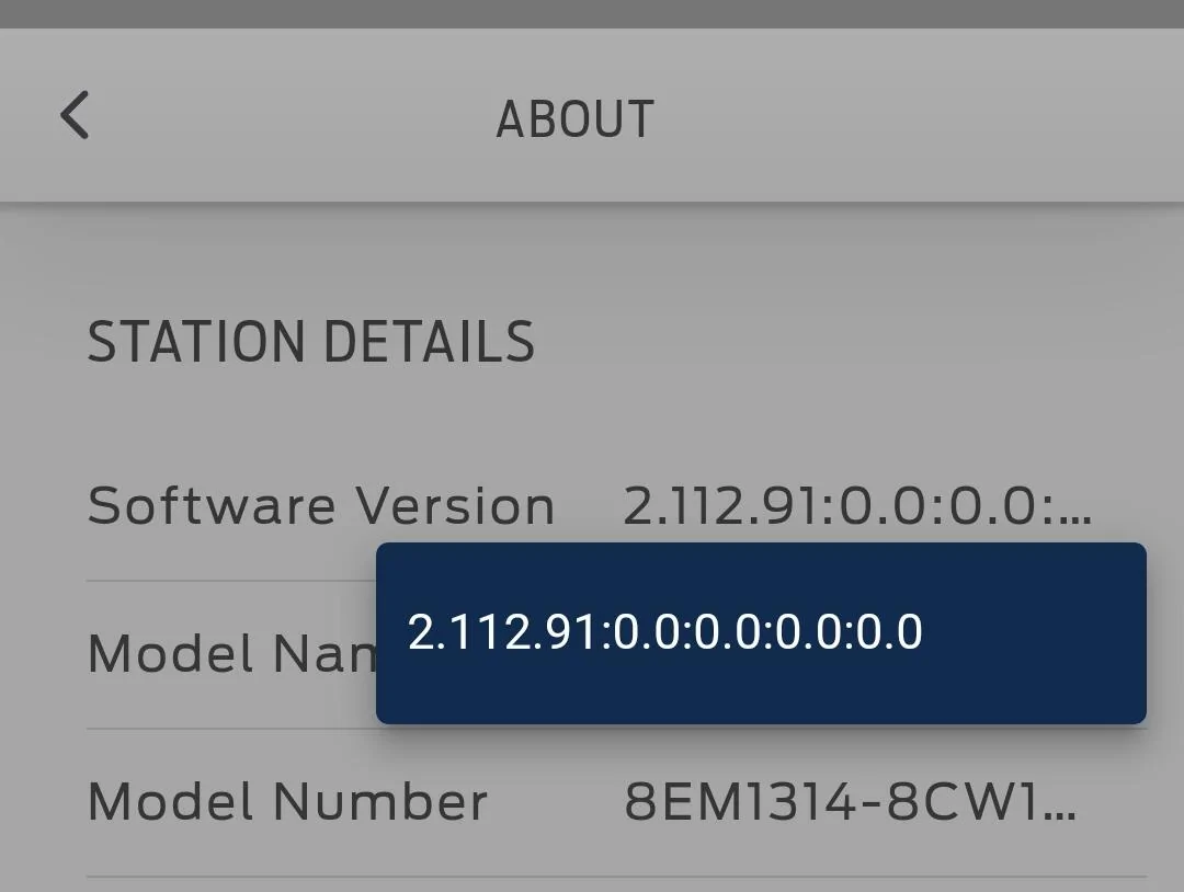

have you ever seen your version with all those .0.0.0 ?
mine is back up too.
no update pending
Yes, this has appeared in the past, but then several days later it reverts to current version like you're showing. I'll watch it daily and see if it reverts or loads a new version level over the next week.

This mornings charge did not start on schedule [6am EST] and probably would not have started until I looked at the app and refreshed it with the trucks current status, just as I requested the refresh the FCSP commenced with charging.
The prior few days scheduled charging kicked off as intended, the only intervening issues were the lack of comm's between the Ford cloud and the Connected Charge Station tile in the Ford Pass app, that problem resolved Wednesday afternoon as noted above.
So far there has been NO update the EVSE firmware, it's still in "pending" status

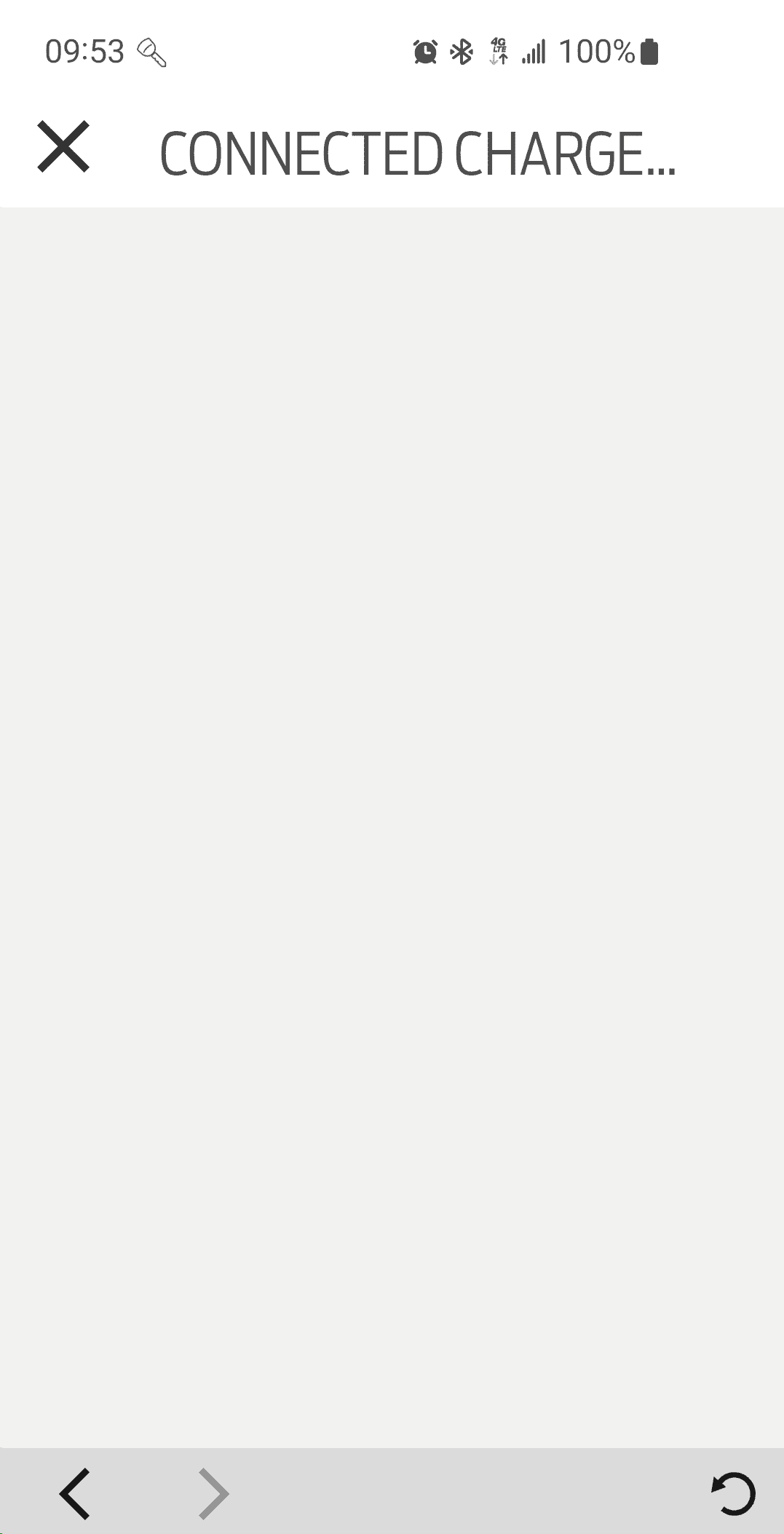

Check the above statement that the FP CCS tile is working ..... it' not ..... more white screen!
Mine was giving me a blank screen for a day after I turned it off at the breaker (was getting the not connected error) but now it's working again in Fordpass.
I'm going to power cycle it later.
I checked again before cycling it, back online again probably a brief outage.
For kicks & giggles, I did do another cycling to see if it will implement a firmware update that's pending, no joy as of yet, might need to leave it disconnected from the truck overnight to make that happen.

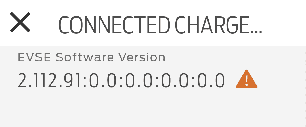

I called Ford this morning about my FCSP missing the 2.112.91 portion but tech told them it's working fine because of a known server issue. The thing is I have two and only one of them is doing this so I informed the rep that one of them isn't working correctly and she snidely replied that it's charging isn't it... Anyway, it looks like you're experiencing the issue they think I'm having since the back portion of your version number is all 0s.

@Ford Motor Company has there been any new updates past this version?
This has been showing for a several months, multiple reboots done to no avail, next effort is factory reset.

After today's experience with data accuracy of my FCSP and the persistent inaccurate software version information, I'm running a software initiated return to factory status, then I'll configure connectivity to see if the version data becomes more accurate AND resolves issues I'm seeing with lack of accuracy in charging energy as mentioned in this thread.

Don't bother, I'm still with the partial version number seen in post 68, but I have high hopes that maybe an overnight status check might cause an update, I'll report back in the morning.

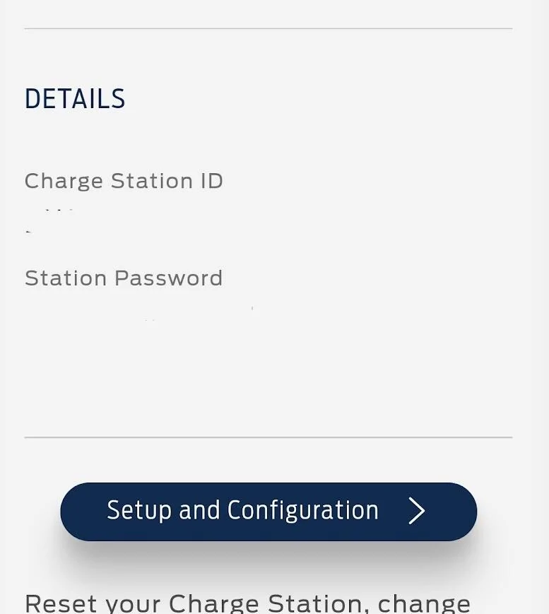

Interesting. In FordPass 5.7, the FCSP software version no longer shows under Energy tab, Charge Station, Settings, Details. Just the Charge Station ID and the Station Password now.
But if I launch the Charge Station Pro Setup app, I see the following (with my Station ID edited out):
Ford F-150 Lightning FCSP Software Version 2.112.91:2.149:1.32:1.53:0.62 IMG_1098_EDT
(to get the blue bubble with the full version number, click on the partial version number shown on the CSP app screen)
My bastardized software version number is kinda the reverse omission of @TaxmanHog's and it's been that way for quite a while...
