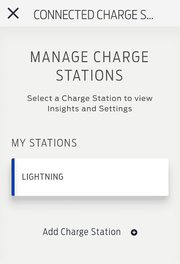

I show no charging history in the app. I’ve checked all settings & have good communication with the charger. Any ideas?
Make sure all data sharing options are on in the truck.
Did you happen to change the user account email address anytime during your ownership?
I tried this once last fall while having been locked out a couple of times from my original Fordpass account, after creating the new FP account, linking the truck to it I lost access to the trucks charge history which was keyed to my old account identity.
Eventually after getting unlocked and restoring my FP app and truck associations, the prior history reappeared, though I had a data gap while operating under the alterego.

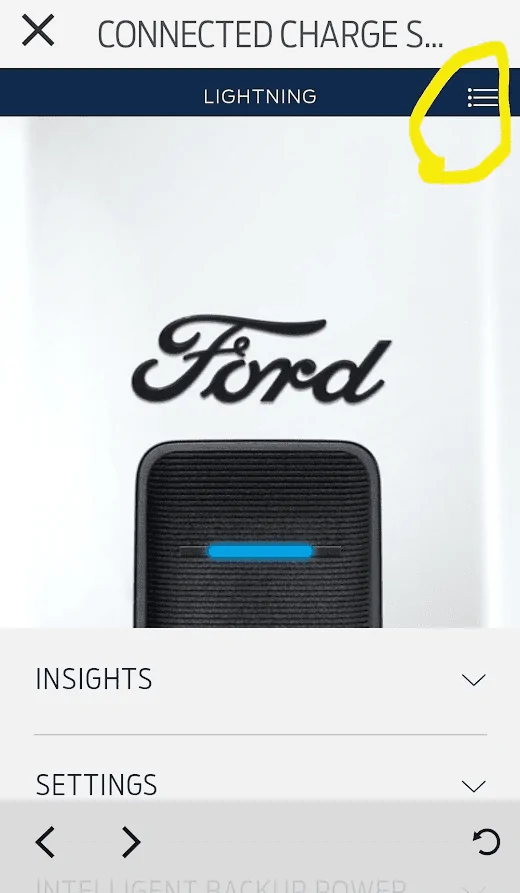

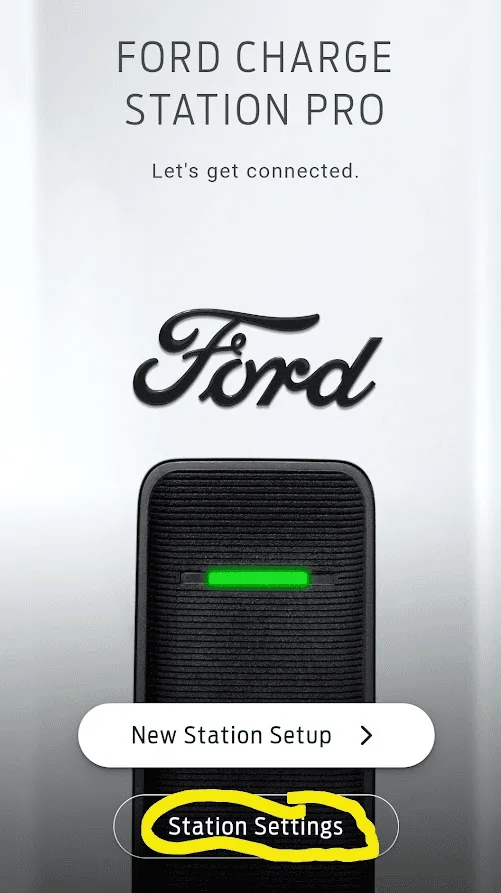

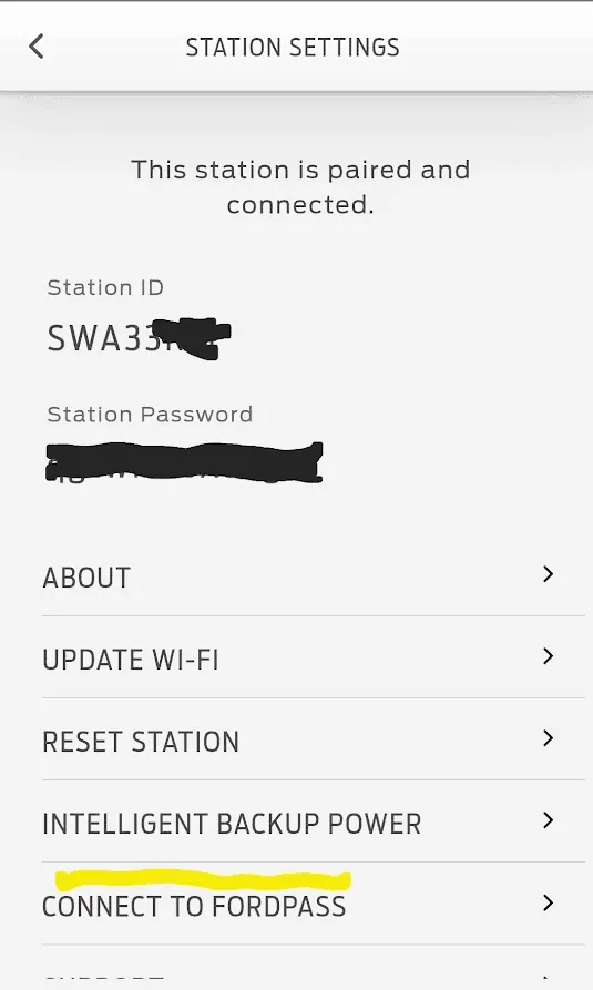

Assuming no issues with account and permissions, try the setup process of linking to your Fordpass account, log into the FCSP, make sure your phones wifi is turned on, using the setup app, connect to your existing profile by clicking "Station Settings"
Ford F-150 Lightning FCSP Software Version 2.112.77:2.135:1.18:0.39:0.48 1678546946086
After logging in, click connect to Ford Pass
Ford F-150 Lightning FCSP Software Version 2.112.77:2.135:1.18:0.39:0.48 1678547040501
This will trigger Ford pass to launch it may take several seconds for it to connect.
Follow the prompts making the connection, once completed the Connect Charge Station control panel should show your vehicle name, though the insights may not show any history at this point as you just establish the new relationship. After your next charging event has completed, unplug the truck and wait a few seconds for the data to post to the cloud, it should be available in the app.

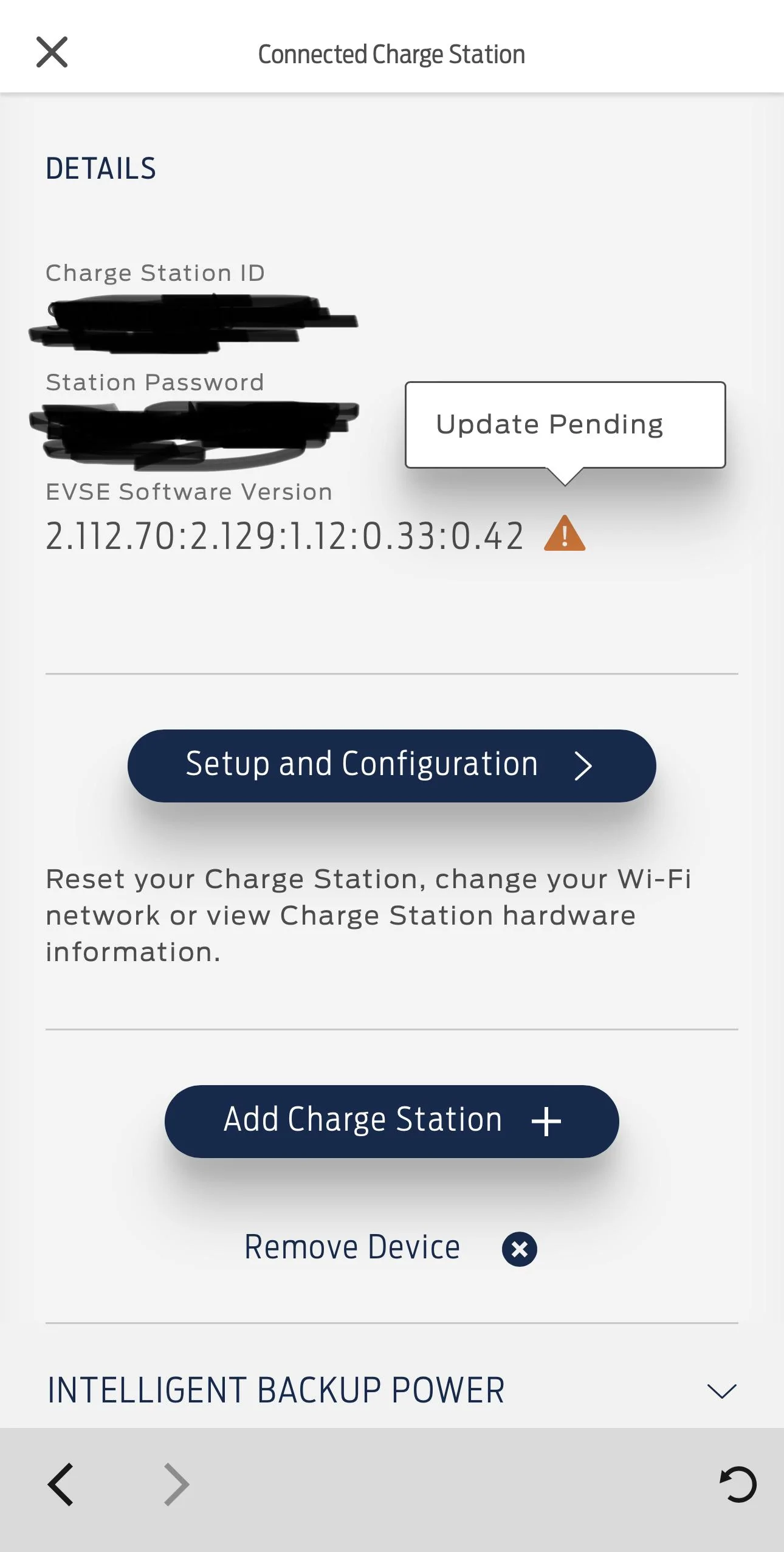

I spent hours on the phone today with Ford & Siemens concerning my lost communication for my FCSP. I first noticed I didn't show any information in the Insights section of FP. I also had a message that my FCSP software was out of date. Ford shows on their end that my charger lost connection on 3/8. I'm unable & through all of their advice unable to connect to my charger via the phone login to the charger in FCSP software. So they are working on a solution to my chargers problem. I wonder when the chargers last update was pushed if that's when I lost communication. That's only my speculation.
One thing that the Ford rep told me was that the chargers software will not update if you're vehicle is plugged into the charger. I hadn't heard that before & always plug in every night especially during the winter. All of the chargers updates are pushed during the night.

Just looked at my app again and it looks like there is an update pending for the FCSP. I am assuming there is no way to force the update right now.
