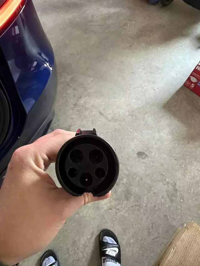

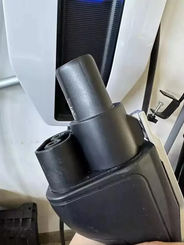

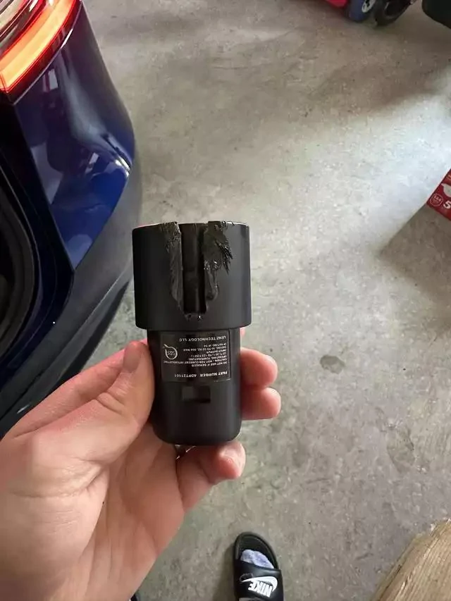

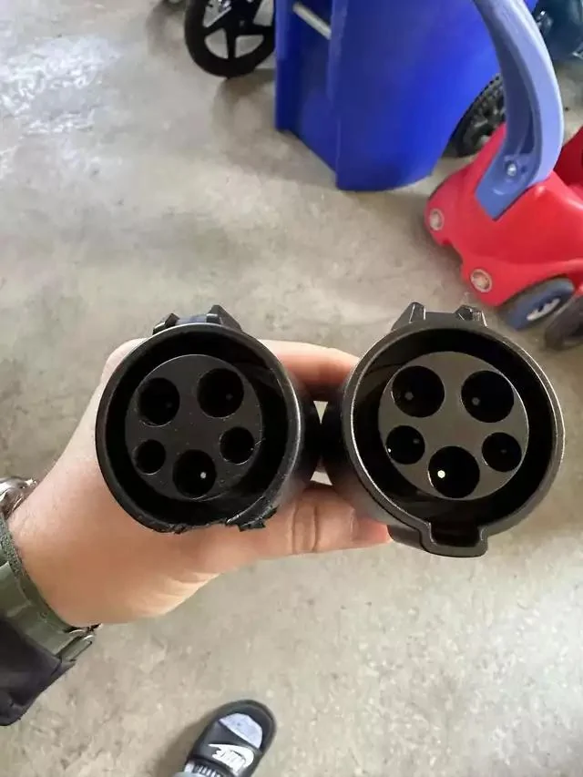

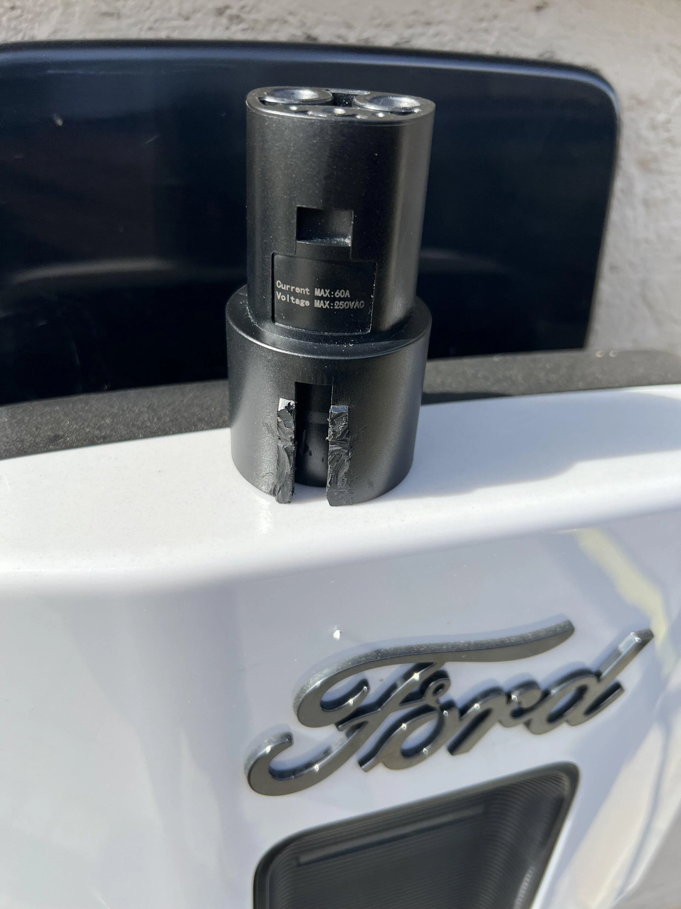

Original post:
According to Reddit OP CharityAny5289:
1) Remove the bottom plastic bit from a J1772 adapter (I used a saw to saw it off) 2) Change the amps in the charger station setting to 40a down from 80 (I think Tesla can take max 48 via ac)
When it was set to more than 40A, the ford charger would “click” 5 or 6 times like it’s starting to charge and then the Tesla would say charging stopped without any error messages. The longest it would charge is for a few seconds before the charger clicking and the charging stopping.
FCSP to Tesla adaptor
