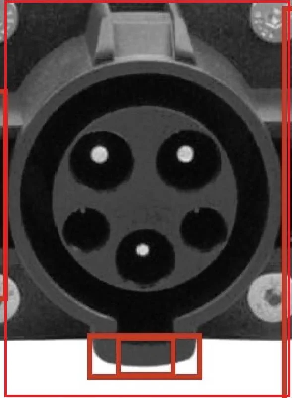

Don't believe FCSP will charge a Tesla using the Tesla made CCS adapter.
Believe that CCS adapter only passes the DC power pins from CCS to the Tesla NACS. No AC power (which is what you use at home) will be passed through using that.
Never tried it, but 95% sure.

I think that is what other people have said who tried it.
I think there might have been an 'after market' adapter that claimed to work with both DC and AC L2 that someone linked to in another thread? Maybe it was this one?
https://www.amazon.com/2In1-Tesla-Adapter-CCS1-Compatible/dp/B0DJX4R5Z5
But don't know if anyone tried it to verify it works.
NOTE: "The Ecogenix CCS Charger Adapter is compatible with a wide range of Tesla Model Y/3/X/S.๐๐Ž๐“๐„ ๐Ž๐ง๐ฅ๐ฒ ๐Ÿ๐จ๐ซ ๐‚๐‚๐’-๐ž๐ง๐š๐›๐ฅ๐ž๐ ๐๐ฅ๐ž๐š๐ฌ๐ž ๐ญ๐จ ๐ž๐ง๐ฌ๐ฎ๐ซ๐ž ๐ฐ๐ก๐ž๐ญ๐ก๐ž๐ซ ๐ฒ๐จ๐ฎ๐ซ tesla ๐ฌ๐ฎ๐ฉ๐ฉ๐จ๐ซ๐ญ๐ฌ ๐‚๐‚๐’ ๐›๐ฒ: ๐‚๐จ๐ง๐ญ๐ซ๐จ๐ฅ>๐’๐จ๐Ÿ๐ญ๐ฐ๐š๐ซ๐ž>๐€๐๐๐ข๐ญ๐ข๐จ๐ง๐š๐ฅ ๐•๐ž๐ก๐ข๐œ๐ฅ๐ž ๐ˆ๐ง๐Ÿ๐จ๐ซ๐ฆ๐š๐ญ๐ข๐จ๐ง> ๐‚๐‚๐’ ๐€๐๐š๐ฉ๐ญ๐ž๐ซ ๐’๐ฎ๐ฉ๐ฉ๐จ๐ซ๐ญ-๐‚๐ก๐ž๐œ๐ค ๐ˆ๐Ÿ ๐„๐ง๐š๐›๐ฅ๐ž๐ "
If it works with "any" L2 J1772 source, then it "should" work with the FCSP...but I did not see any reviews that had tried it with the FCSP at the Amazon web site.
