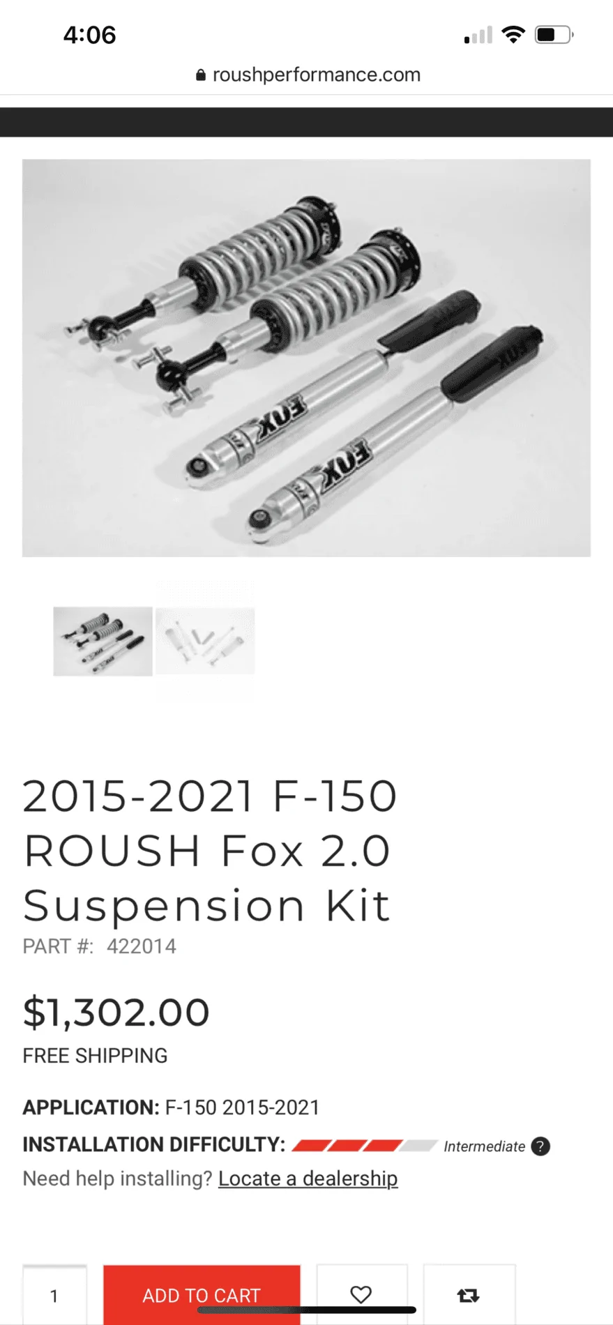

FYI roush has updated their kit to show 2021...I have a hard time believing the regular fox 2.0 kit won’t work.

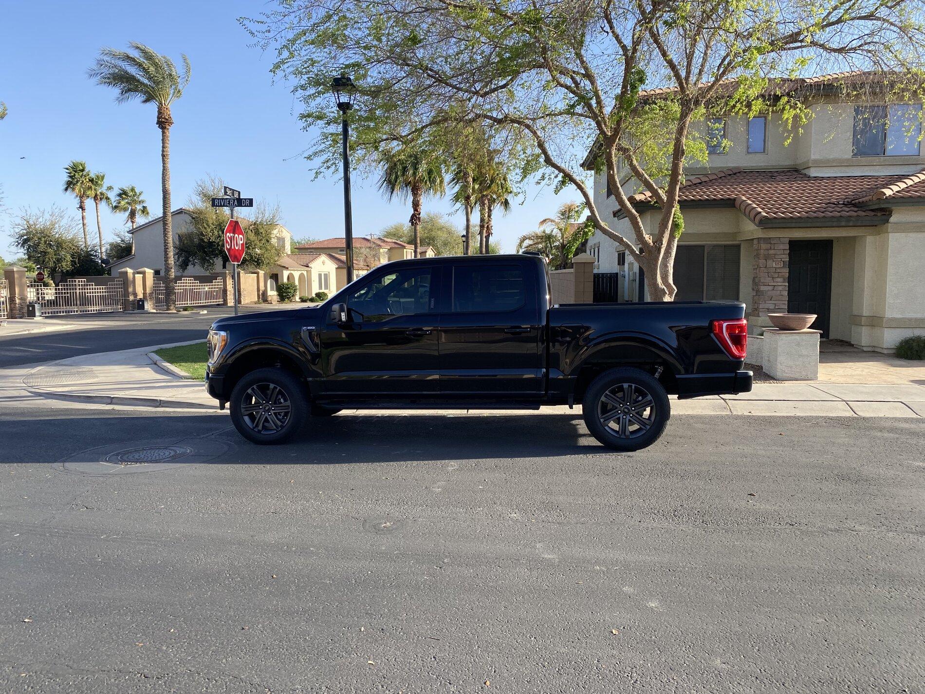

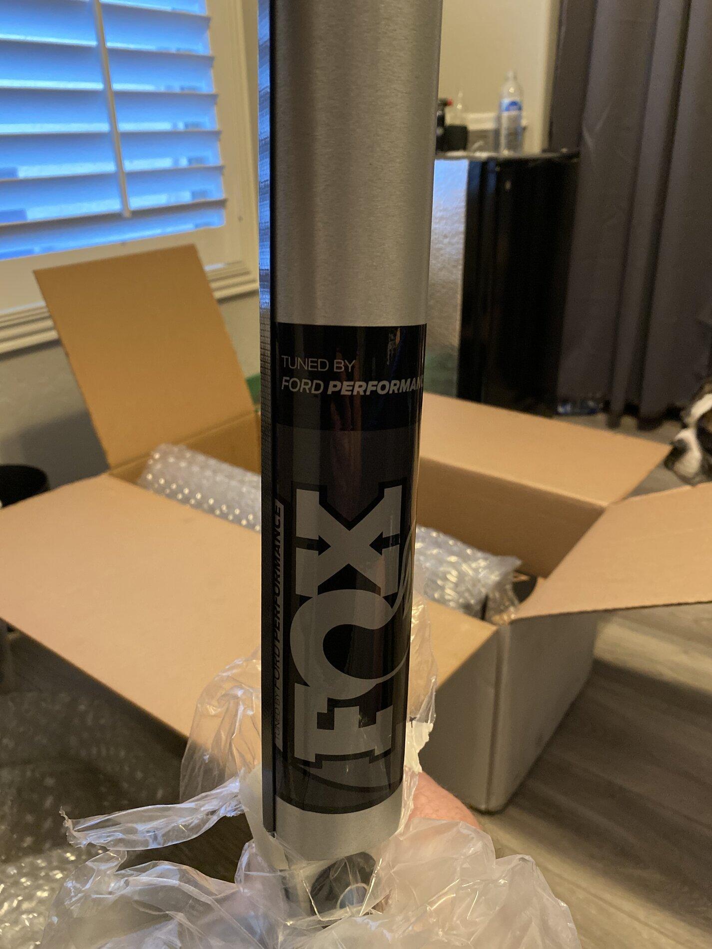

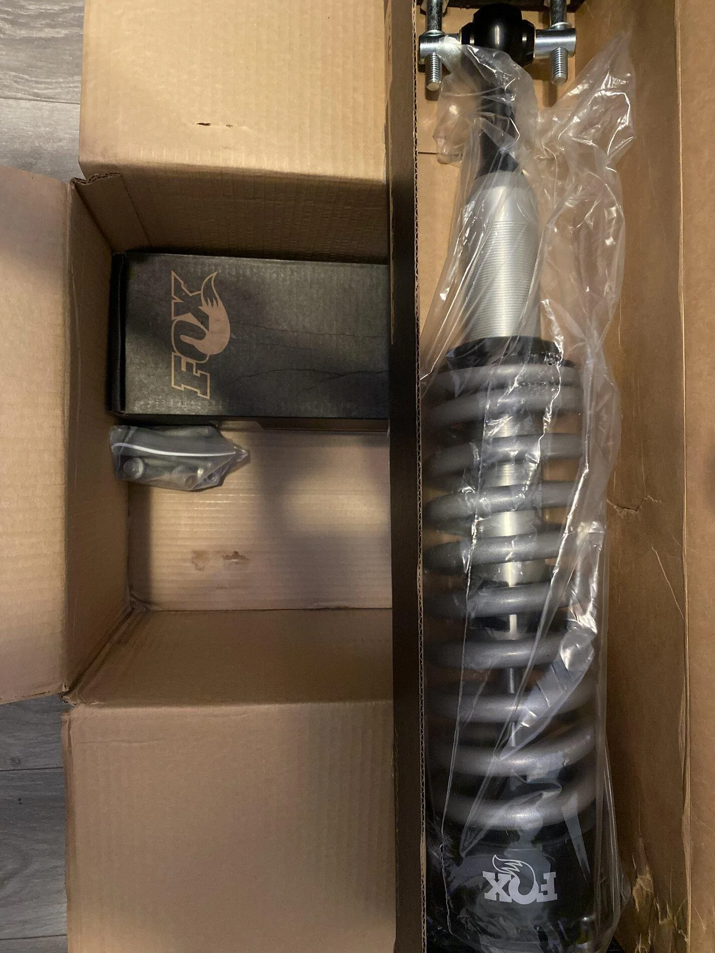

I installed the FOX " tuned by ford " suspension this past weekend . Went pretty smooth and happy with the look and performance .
Followed the instruction about 95 percent. the difference was ford states to remove the fox hardware off the struts and use what ford includes instead. The issue with this is the treads only go so far on the ford bolts so instead of installing them face down like ford says to do I installed them facing up . I suspect the threading or the lower control arm itself is different in some way but I had no trouble with the kit.
The ride is improved with better road feel and less " floaty " feeling when turning hitting rolling bumps.

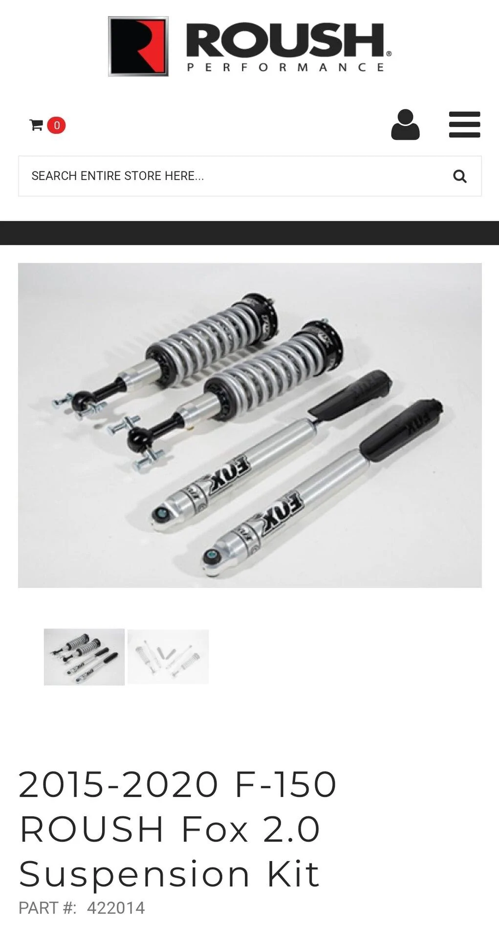

That is quite strange, then I look on their site the same product SKU suggests max 2020 (see image attached)

They've changed it again, now it says 2021 again quite weird
