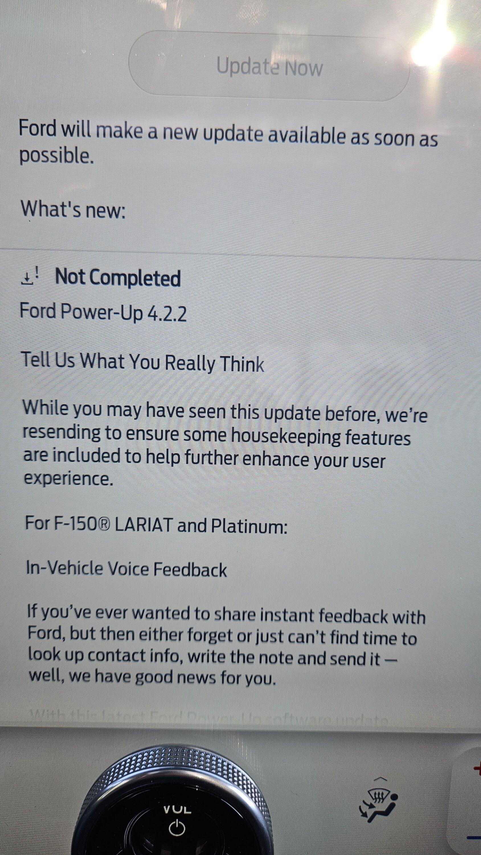

About the only thing you can do if you have nothing being pushed to you is to find FDRS and update yourself. $500 cable and $50 every two days for the SW license. If you've by chance had a release pushed to you and it just didn't install, that is likely a 12 volt battery issues. There are reset procedures for the LV SOC posted here on the forum.

What does "not completed" mean. Still downloading?
Ford F-150 Lightning Ford Power-Up 4.2.2 Voice Feedback 20230414_155259

I will add that if you have an issue or something weird happen, you should immediately (when safe to do so) submit voice feedback with as much detail on what happened as possible. These do get analyzed and a data snapshot from the vehicle goes with it so it can be an immense help in figuring out what actually caused whatever issue was experienced
