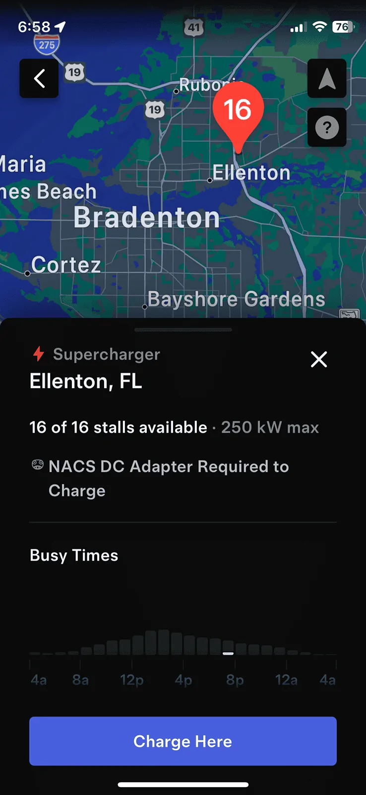

I tried to charge at a Tesla location in Ellenton FL with my new Ford Adaptor this evening and it failed.
The location shows in the Tesla online site map as having ability to charge CCS with adapters.
In the Tesla APP when I go to "Charge your other EV" it doesn't show this location on the map.
The Lightning Ford Pass APP shows the 16 Tesla stations are capable with adaptor but it fails.
What am I missing?
BTW, The 4 EA chargers at this location had 2 of 4 broken. The other 2 were occupied.

Site shows up on my Tesla app. Looks like you have 2 filters applied. Might check those.
Did it fail from Ford P&C?

Thanks for the reply.
I just got of the phone with another member. I didn't have "YES" checked in the Vehicle Details for the Ford Lightning "Do You Have a NACS Adapter" checked in the Tesla APP.. Once I checked that the Ellenton site showed up on the Tesla APP. I have 2 Tesla's and never had an issue with the APP but didn't realize the other selection was required to charge non-Tesla's.
When I JUST plugged in it did fail P&C. I have used P&C at the EA chargers at this location using my free credits.
I don't know if I have the correct software update on the Lightning to P&C the Ford at a Tesla Charger.

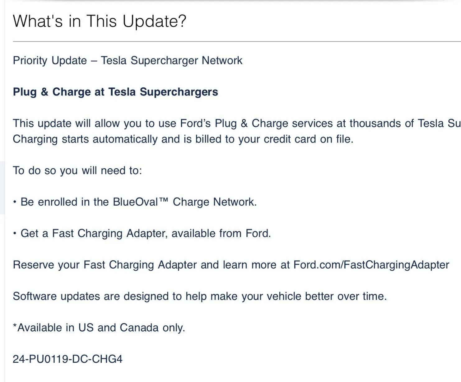

You should be able to charge now using the Tesla app. As for P&C, you need the Tesla OTA from Feb 29. The best way to know if you got it is to post your VIN on the VIN lookup thread and ask if your truck got OTA 24-PU0119-DC-CHG4.

I took your advice and posted my VIN on the other thread. You are correct, it was confirmed that I don't have OTA 24-PU0119-DC-CHG4 installed.
The 23's sure have had issues getting updates but hopefully there are signs that they are starting up again. You can check out the whole thread on 24-PU0119-DC-CHG4 for clues perhaps on what 23's got the update.

miraculously Ford uploaded the plug-in charge update this afternoon to my truck. Hopefully P&C will work now.

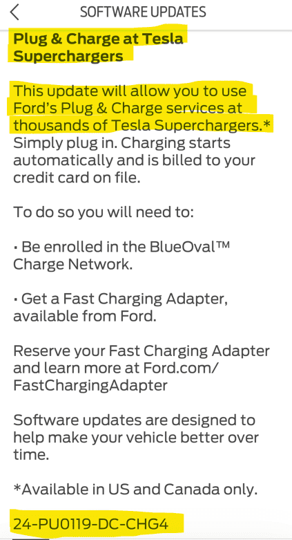

Had this Tesla Plug & Charge update waiting for install today. Said it would install at 1am tomorrow or I could do it now but truck would be unable to de driven for about 10 minutes.. Opted to do it now.
Update installed just fine.

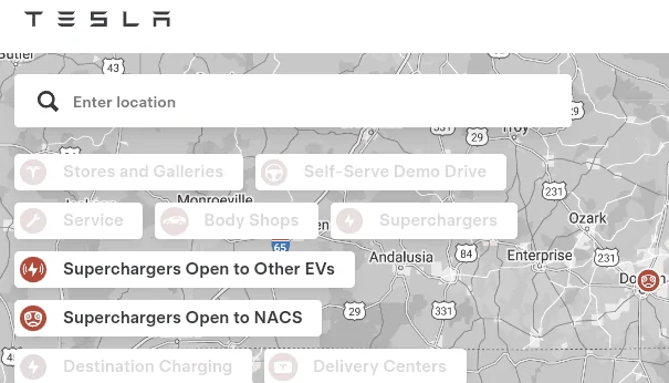

I'll add this, too, as far as 'FAILING' is a concern when using your adapter at a Supercharger with 'CCS' or 'Other EV' capabilities: Tesla units DO sometimes fail to activate, even if all the other unit work successfully, like I found out the other night. Trying another unit worked.
So, to also clear up the easy CONFUSION on the Tesla Supercharger MAP 'filters'...
A) 'Open to NACs' locations is referring ONLY currently to FORD and RIVIAN vehicles, with an adapter of their own... one here is located in DOTHAN AL.

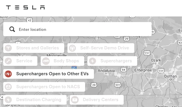

B) 'Open to OTHER EVs' Capable locations, and only a relatively FEW in the U.S. so far, is referring ONLY to 'Magic Dock' locations where ANY CCS EV can plug in and charge, with the Tesla app to active the unit, and with the MAGIC DOCK built-in adapter that is part of the station's cable end. The owner does NOT need their own adapter. My wife's KIA EV9 can use one of these.
You'll see that with this filter, on it's own, does NOT show the DOTHAN AL location, as it is NOT capable for 'other EVs'... at least yet.
Ford F-150 Lightning Ford Tesla Adapter question Screenshot 2024-07-08 10.17.49 AM
how you choose your FILTERS within the Tesla app is paramount, as it allows multiple filter location types at the same time... it's better to use each on it's own. If you are a FORD or RIVIAN, choose both will render all the same info, as we CAN use both, but 'other EVs', like my wife's KIA, would only be able to filter for the 'Other EVs' choice. At least until Tesla opens up to KIA.

Just to be clear, that's the Tesla website. In the app, you put in your vehicle and indicate you have an adapter, and it only shows compatible locations.
