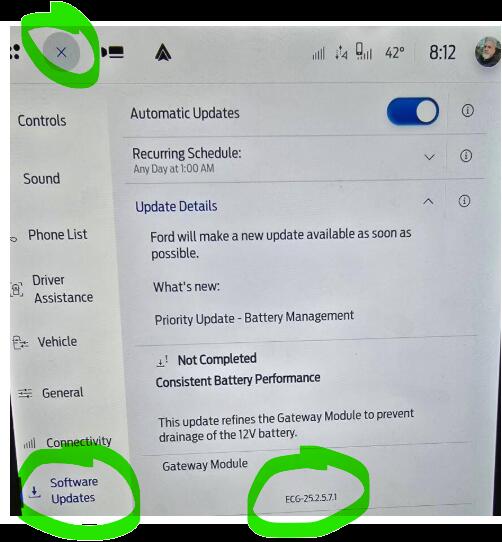

Look here (15.5" screen)
NOTE: this update is going to MY 2022 Lightnings based on member observations, you should show something different for your 2024 Flash.

Gateway module: ECG: 24.2.5.7 Thanks for leading me through this FWIW. Yeah mine ended in 7 w/o the last "1"
That's great to see that your truck is relatively current with updates, not certain if the truck is the cause of the iOS ailments but always a great starting point to see if others are experiencing the same problem at the same updates level.
