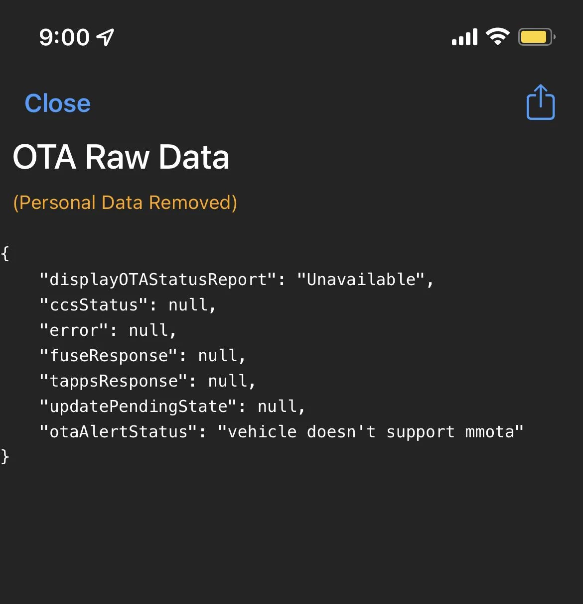

what does this mean? Whats mmota?

OTA is over the air, maybe maps over the air, does your truck have built in Navigation?
OTA=“over the air.” Trucks equipped with a telematics control unit (TCU) a/k/a “modem” use a cellular connection to communicate with the Ford mothership. Ford uses this cellular connection to send Power Up software updates to the truck.

Could this be the reason im not getting my OTA updates? Anyone elses show vehicle doesn't support mmota?

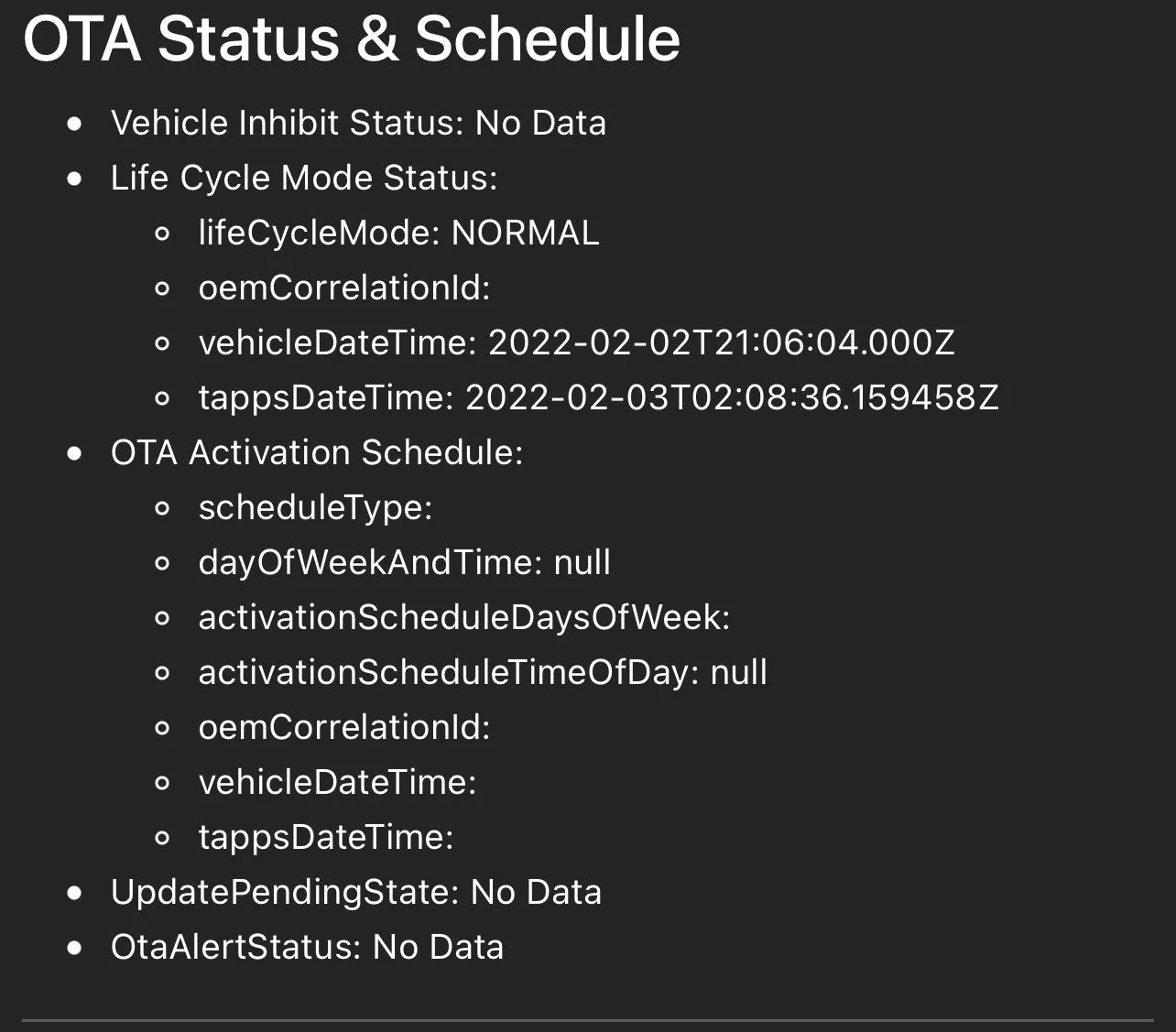

Mine shows “No data” and I’m also not getting updates. Does anyone else have anything besides no data or vehicle doesn’t support? Yes I have updates turned on, I plan to ask the dealership when I go for my first oil change in a couple of weeks.

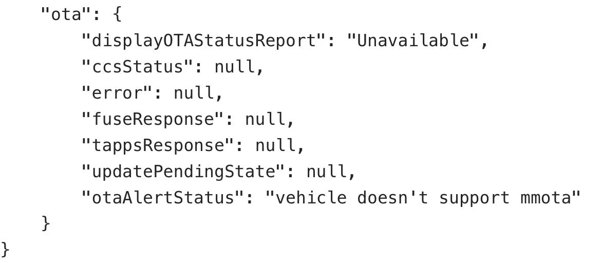

My widget claims that my truck does not support mmota:
Ford F-150 Lightning FordPass - Scriptable Widget (iOS, iPad, MacOS) A63DCAD6-37F0-4E7B-B0F5-1825B2014C35
Many people broke their OTA - there's a bug in FDRS when running a network scan over J2534 pass-through protocol might corrupt data.
The fix is easy enough (if you have an active license) - run the network scan again!
Yeah, I made a bunch of modifications with ForScan, that’s probably it. Will check this out after work, thanks!
