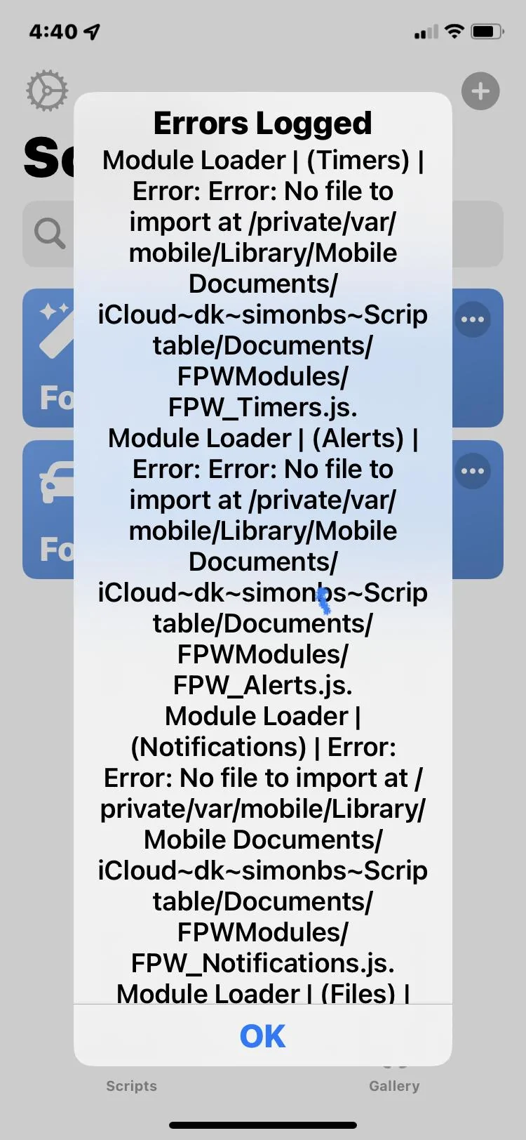

Sorry you are having that error. By no means am I an expert on this or involved in the widget. But, just a couple quick suggestions. Check to see that the widgettool is updated. It should be 2.0. Try removing the widget and re-adding it. If none of that works. Remove the widget, uninstall Scriptable and start from scratch. I have found that sometimes it takes a bit of finesse to get it running properly, but once it does, I haven't had further problems. Hope that helps and be sure to re-read the second sentence of this post.
Yup i removed both the widget tool and the ford widget. I reinstalled the new widget tool and then the ford widget. It works now. I must have a older version of the widget tool. Back in business :)

It is
I deleted it and reinstalled a couple of times and also toggled it on/off I. The iCloud settings.
I checked my Files app and didn’t have a scriptable folder.
Not sure if you got this working or not. I got the iCloud issue for me cleared up by toggling iCloud Drive on and it asked if I wanted to upgrade and I selected to upgrade. After that scriptable worked. Hope this helps.

I figured out the iCloud error! You need to have iCloud Drive enabled in the settings. I use it occasionally, and apps have saved data in there, but it wasn’t enabled in the iCloud settings for some reason. Once I toggled it on it worked fine. Thanks for your efforts!

Everything was work great earlier now I get the error message
Is your phone close to capacity? It seems that if it needs to make room for anything, files shared via iCloud are one of the first to go.
When this happened to me... I just cleared a bunch of unused apps on my phone, ran the "FordWidgetTool" script again to update everything and it was all good.
Hope this helps.

Thank you, plenty of space, that was not the problem..
