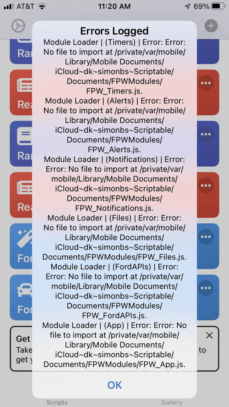

Are you able to install the new version? I'm still getting the iCloud error. ??‍♂
Check your iCloud settings in iOS where you can toggle on/off individual apps for iCloud. And make sure Scriptable toggle is turned on.

Having the same issue with iCloud. iCloud is on and the scriptable app is toggled on within iCloud settings. Deleted and reloaded scriptable multiple times. Hoping someone figures this one out cause I would love to try this out.

When I was having issues, I deleted the FordPass script in scriptable, then went to the "Files" app, went into the Scriptable folder and deleted the "FPWModules" folder. THEN, I went back into scriptable and used the "FordWidgetTool" to get the latest beta version.

It is
I deleted it and reinstalled a couple of times and also toggled it on/off I. The iCloud settings.
I checked my Files app and didn’t have a scriptable folder.

@tonesto7 thanks man for all your hard work! Love the widget. I went to update to your latest version and now receive this error. Any ideas? Unable to import a module? I used the ford tool widget to auto install the update.
I am getting exact same error.

Sorry you are having that error. By no means am I an expert on this or involved in the widget. But, just a couple quick suggestions. Check to see that the widgettool is updated. It should be 2.0. Try removing the widget and re-adding it. If none of that works. Remove the widget, uninstall Scriptable and start from scratch. I have found that sometimes it takes a bit of finesse to get it running properly, but once it does, I haven't had further problems. Hope that helps and be sure to re-read the second sentence of this post.
