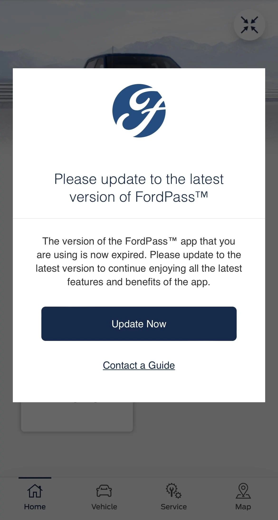

I just updated the official FordPass app on IOS to 4.12.0. Since the update, I keep getting a popup in the new app that my version of is expired (which is silly or buggy; I'm running what the App Store says is the most recent version).
Ford F-150 Lightning FordPass - Scriptable Widget V2022.XX (iOS, iPad, MacOS) 5BAC22CB-DAE0-41D2-A216-6D88A48E55EC
More importantly - Is Ford pushing API changes that are going to impact the unofficial widget?

I updated it too but its working ok. And a bonus ... the message indicator finally went away!
