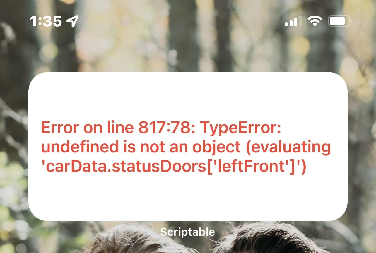

Hey @tonesto7 just letting you know that I get this error. This is a wicked widget though! Thanks for putting the time in!!!

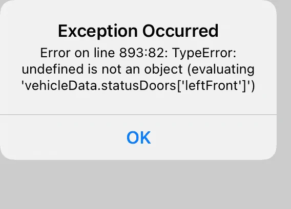

Im getting the same error with the new script.

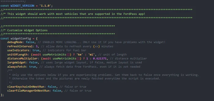

At the top of the script in the widgetConfig section change the clearKeychainOnNextRun from false to true
Ford F-150 Lightning FordPass - Scriptable Widget (iOS, iPad, MacOS) 1639432260789
Run the script once and change it back to false
