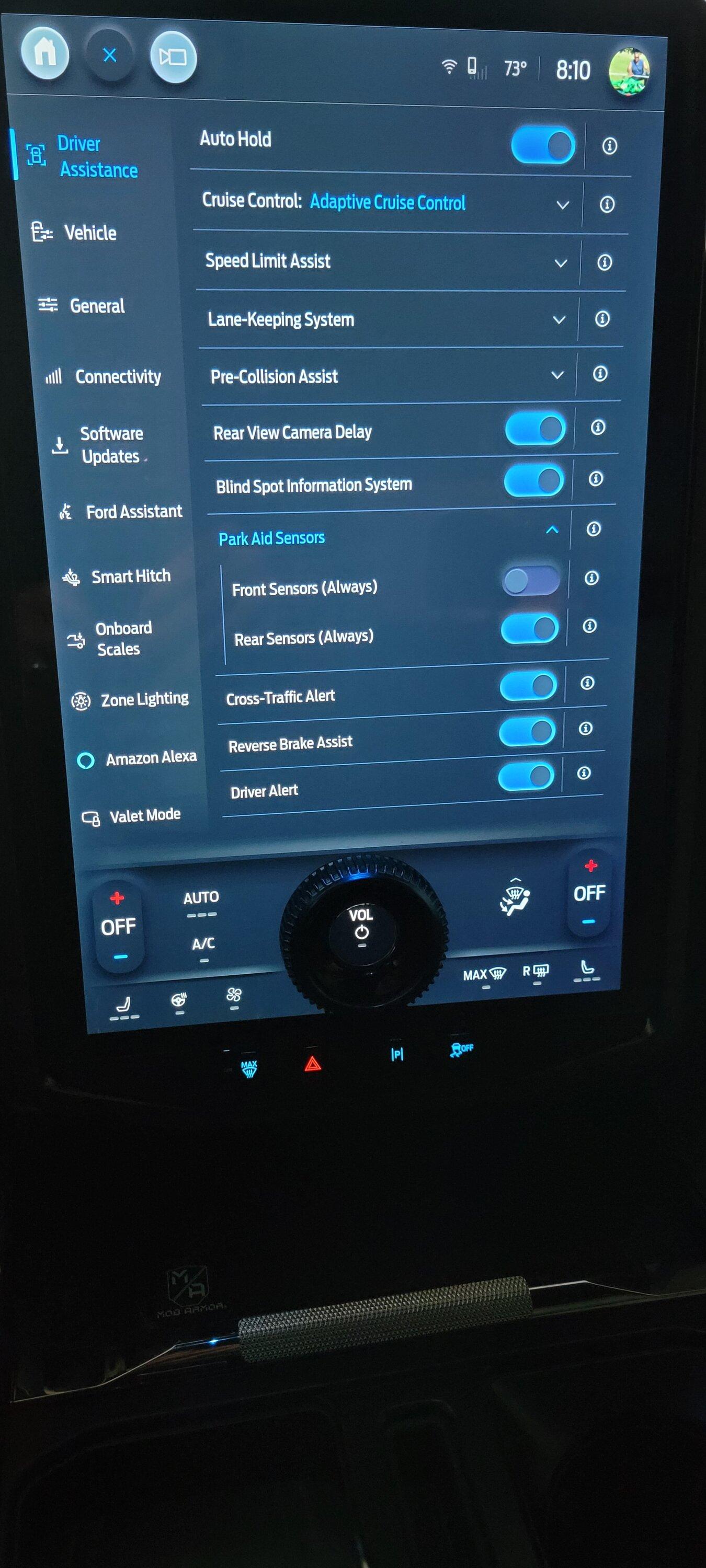

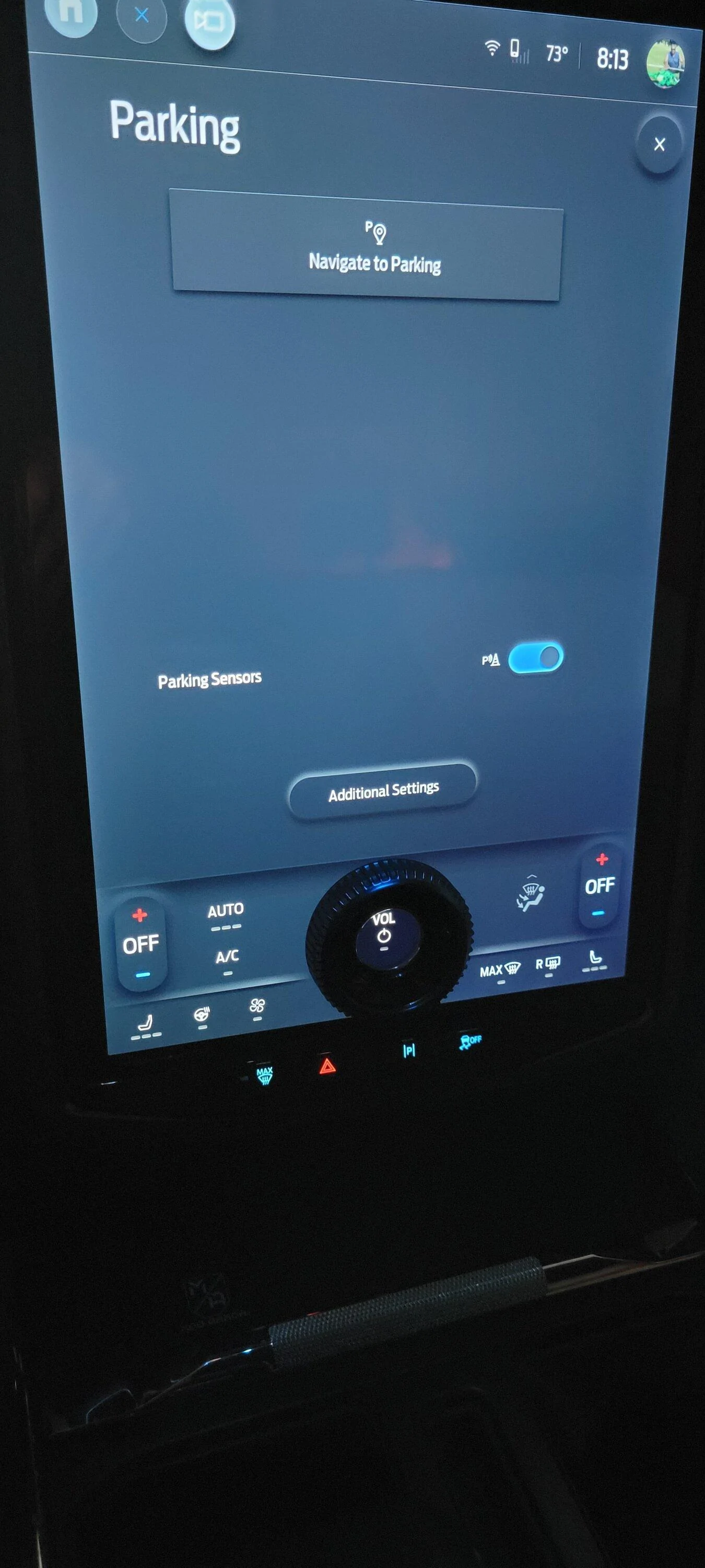

I pressed the Park button on the bottom of the screen and it takes me to a screen with a button to navigate to a parking spot near me useing Ford Nav. Also I do not have a Parking tab in settings, there is a park aid under driver assistance.
I believe park Assist is platinum only. Under park aid my front sensor was off, I cut it on but still no popup camera.

Seems to me that you don’t have Active Park Assist 2.0 since you don’t get the same options I do when I press that button. I bet you need to change the code in Forscan to do the camera with front sensors. Here’s a link to the Tremor forum where they discuss which code to change and the issue as to why some have this feature enabled and some don’t.
https://www.f150tremor.com/threads/parking-camera.2155/

I have a 22 and it's definitely not popping up the camera, I've been threw all settings. I only get the screen with the yellow and the red alerts. 🤔

When you get close to objects do you get beeps from the front? If you are getting beeps you are definitely close enough your camera should have popped up.
I will note, I don't know what sensors they use to determine, I'm guessing the sonars in the bumper, just not sure.

Yes I get a alarm and a screen pops up that shows yellow and then red on the front of a truck on the screen.
