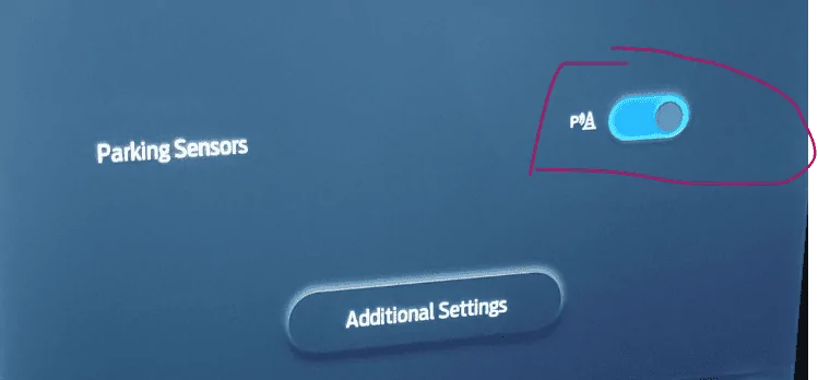

I have a Lariat-ER, but recently noticed that when I turn off this switch, my forward badge camera would not activate when pulling up close to a car or wall ahead of me, I use it to get my truck in just far enough to close the garage door, flipped it back on and the front camera resumed working.
I do the same thing backing in everyday to my garage, but the parking sensor is automatically reset because i have to turn it off everyday. I really this is not a feature on the SR Lariat. I will make sure its on at my next startup. Thanks

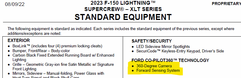

The feature is 360-degree Camera and Forward Sensing System which are standard on all trims XLT and up. Did you try the switch @TaxmanHog suggested?

Yes I use that button all the time when backing in my garage and it is always on when I go to back in again, I never have to turn it back on.
