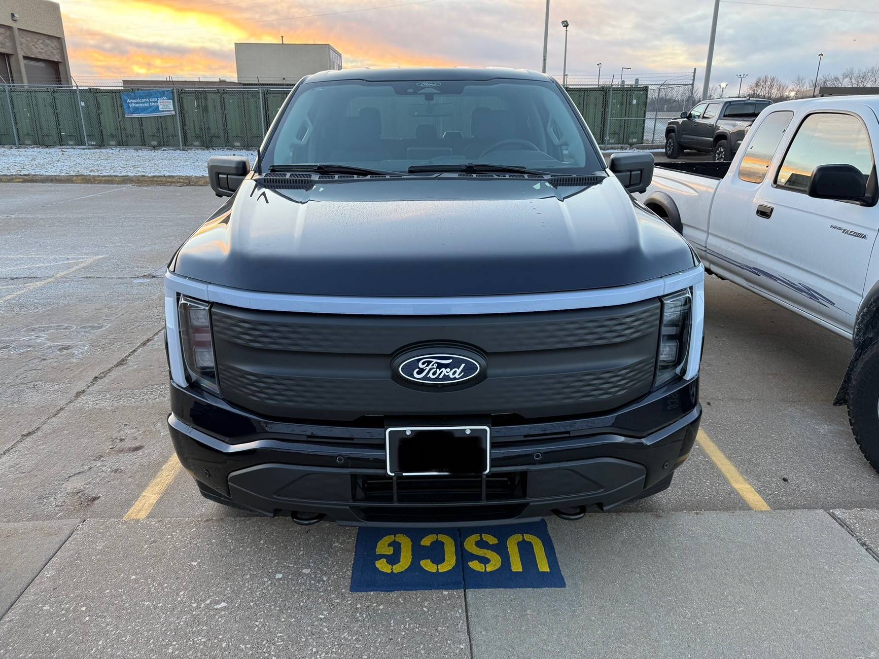

Depending on what is out of alignment, even the dealer may not be able to help you. There is no adjustment on the lightbar itself. You have to adjust the whole frunk.
Do you have a picture of what is out of alignment?

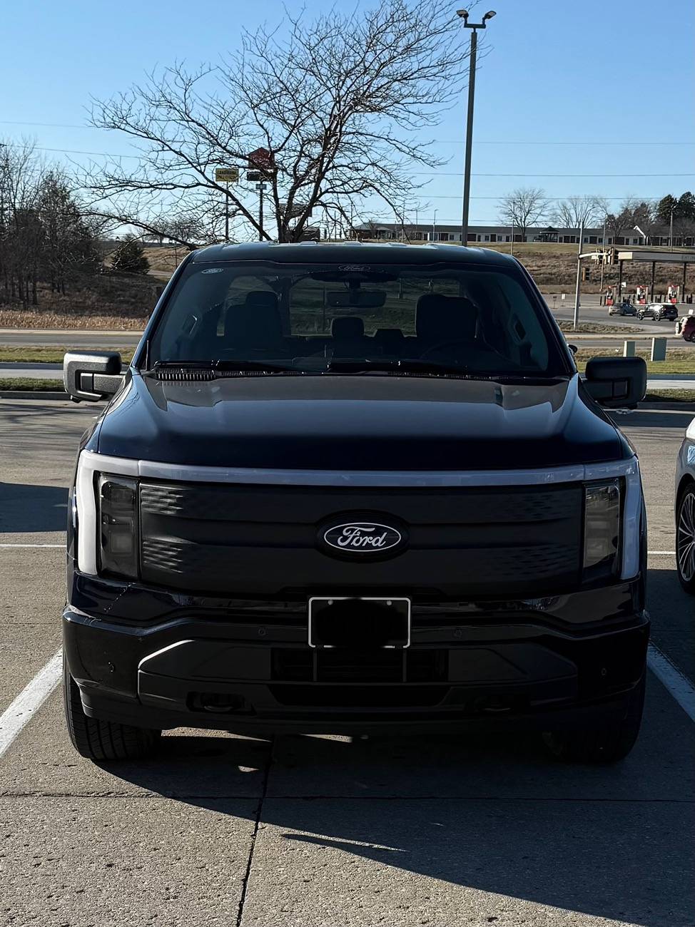

My frunk and middle light bar are higher than the light bar on the headlights. I’ve tightened up the rubber stoppers on either side and it looks better now, but I still think my passenger side is a bit higher.
Before:

After:
Ford F-150 Lightning Frunk light bar alignment IMG_5586
