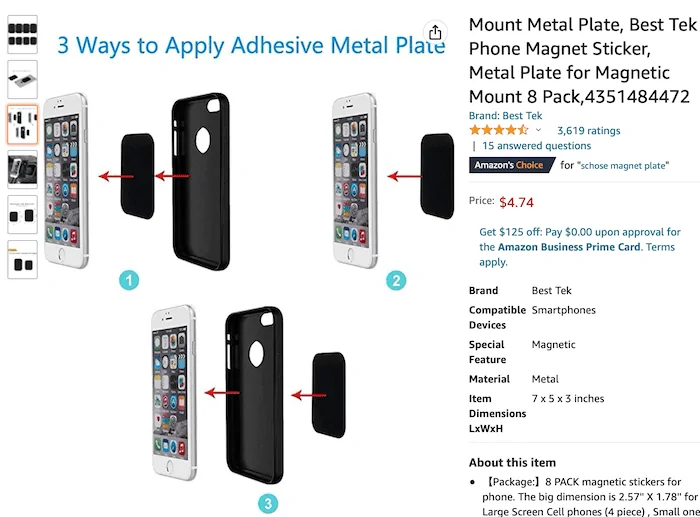

I couldn’t find anything reasonable until another member of this forum developed a solution so simple it hurt….two self-adhesive mini-magnets, a clear plastic magnetic rocker light switch protector and 5 minutes with a Dremel Tool sanding….. It probably needs something more substantial, but should work until Fords’s comes out with something safer…….
https://www.amazon.com/dp/B08J6HF9T6?psc=1&ref=ppx_yo2ov_dt_b_product_details
https://www.google.com/url?sa=t&rct=j&q=&esrc=s&source=web&cd=&ved=2ahUKEwizlbCi1tn5AhXNAzQIHfmCBHUQFnoECA8QAQ&url=https://www.homedepot.com/p/Master-Magnet-3-8-in-Dia-Neodymium-Rare-Earth-Magnet-Discs-with-Foam-Adhesive-12-Pack-97594/206503482&usg=AOvVaw0MwkGQ-aKFAC3MNGLNQfLF
Awesome idea and I just placed an order for the cover and the magnets.
I'm sticking with the idea of the rare earth magnets because it would be stronger but you can potentially also just use an adhesive square metal plate designed to hold a cell phone in a magnetic holder because the cover already has magnets that were designed to be attracted to the screws on a light switch.
