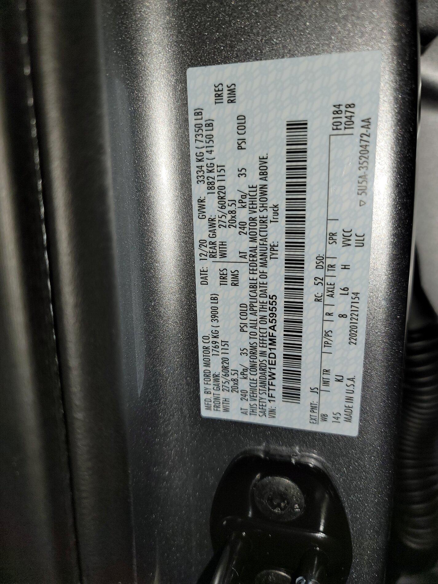

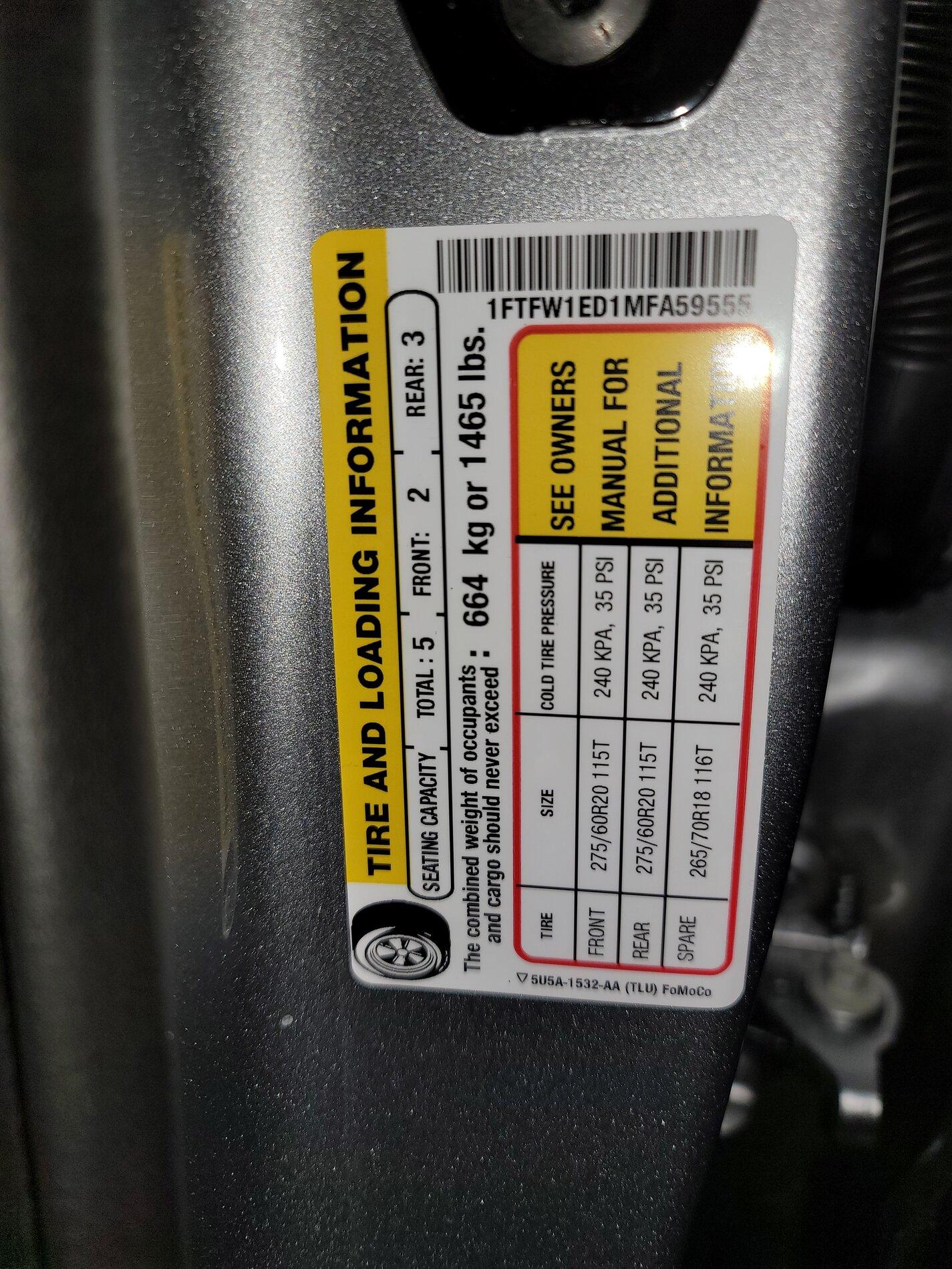

This is for my 2021 King Ranch with no tow package and powerboost.
Impressive! No moonroof or spray liner? Is this a 601A or 600A? Actually, can we just see the window sticker? I haven't seen a powerboost this high yet!

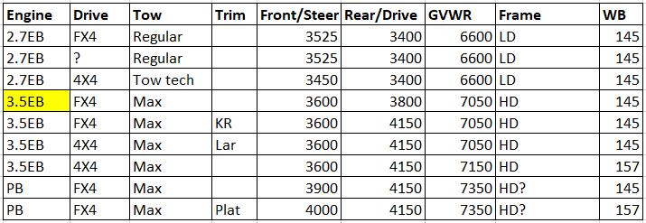

Thanks for this data point! It matches the King Ranch 3.5EB maxtow that I physically saw. It is making me question the other data point in my sheet that says 3.5EB but rear was only 3800#. I want to go try to find that source, as it is mind boggling there are 2 rear axles for 3.5EB max tow....
From the specs document (section below) a 4x2 with can have rear GVWR of 3800 if not max tow or 4150 with max tow. A 4x4 only has 4150 with or without max tow. So something is definitely off with that line.

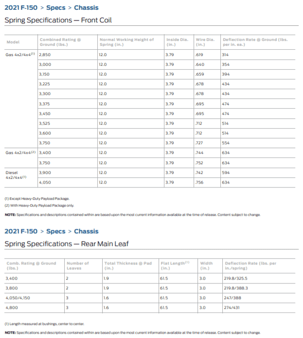

Excellent post!
All the payload discussion focuses on the axles and differences in axle specification. However, I have seen no mention of the springs. Aren't the springs directly influencing the payload? My sense is that Ford is not varying the springs by the trim/options/tow packages much and that's why the payload is low...
I believe the springs are matched to the axle rating for either front or rear... All I could come up with was the frame rating, axle (with matching springs) rating, tire rating, and brake/accel capability as what may limit the payload (when taken across the whole vehicle). I feel like the braking ability would not come into play for stationary curb weight vs GVWR, it would only affect the max towable GCVWR. I am not an auto expert so I'm just trying to reverse engineer how they do it. Tires (summed) are more capable than the axle according to specs, but they SHOULD be as going over bumps and whatnot the instantaneous load can be uneven so you want margin there. So that left frame as my theory. I like Roger's addition of center of gravity though! That's a really good point. Unloaded the center of gravity is also very front heavy while loaded it likely is rear heavy, plus going over bumps/dips the load is not distributed equally so you need margin per axle, so that's why I wanted to figure out their derating factor (which looks inconsistent in PB with more axle margin than EB with less axle margin). Anyway, streaming too many thoughts and probably not making sense here so I'll stop.
Here is where the spring ratings I saw were. It sure looks like they match it to the axles.

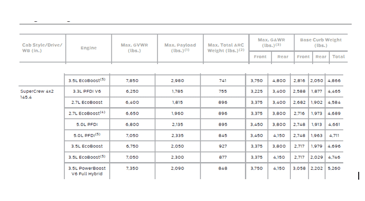

@daemonic3 - I was just trying to understand why PB trucks have a low payload. I believe that it is not the axle ratings that are driving it but the fact that the weight of the batteries has added while not upgrading the springs.
Gotcha. I think they *did* upgrade the springs with the axles. It just wasn't by more than the whole hybrid system weighs (300 upgrade vs 550 weight).

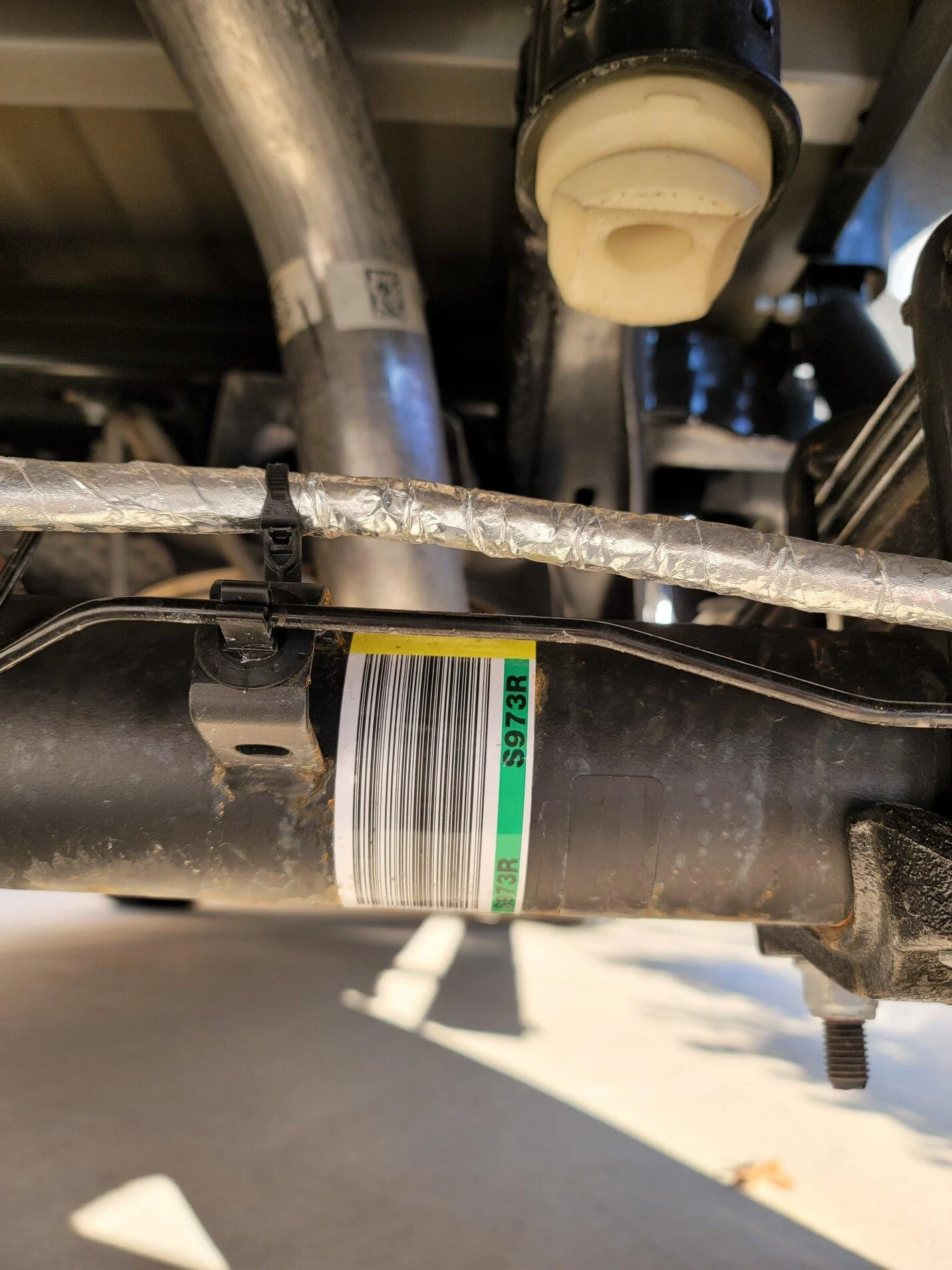

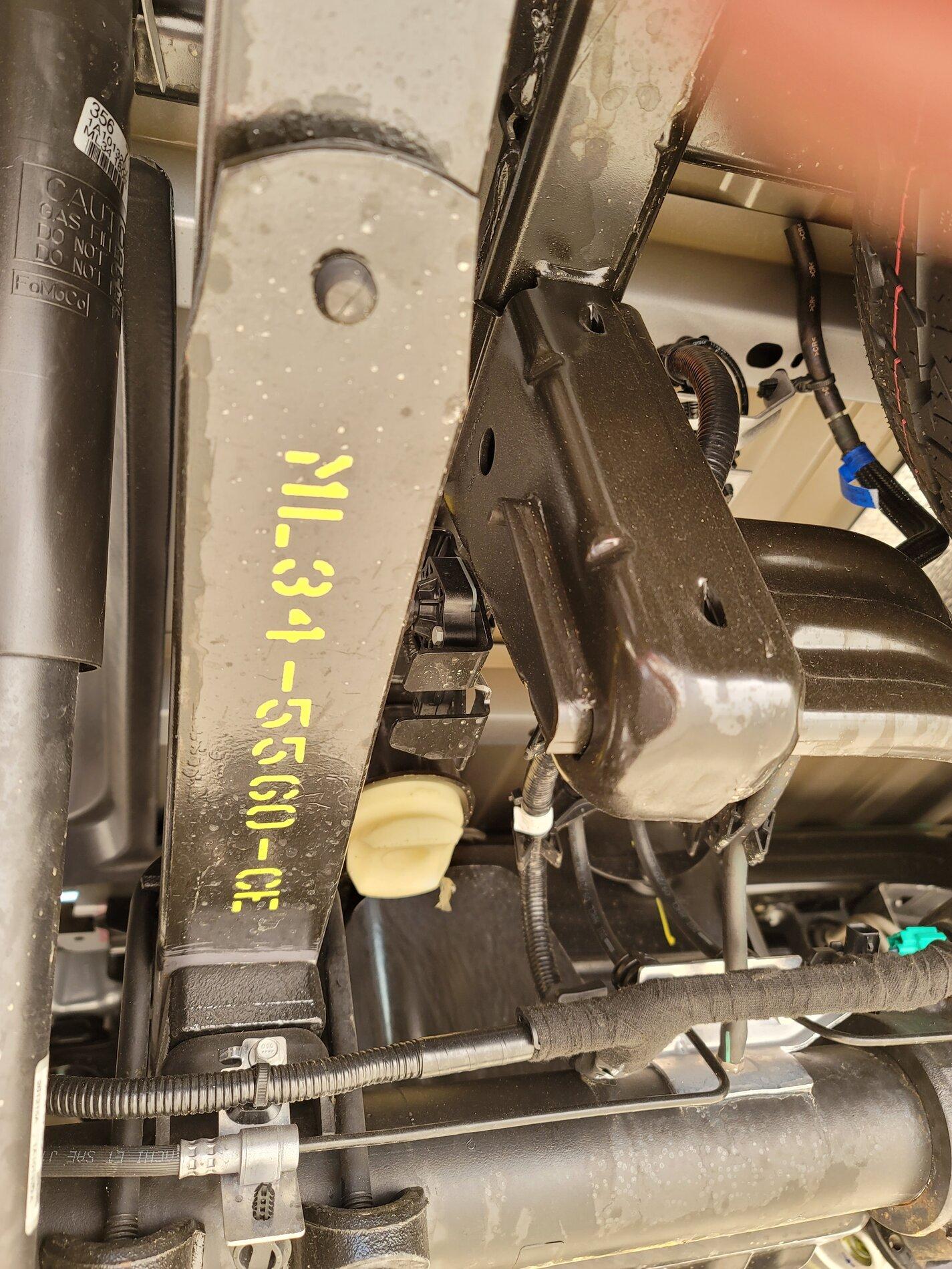

Here are the axle and spring pics. Maybe someone will compare these to a Max Tow and see if they are the same. Mine doesn't have any kind of tow package. Mine also came with a Yaw sensor kit.
Ford F-150 Lightning GAWR (axle) stickers for regular/max tow and EB/PB 20210112_160024[1]
Ford F-150 Lightning GAWR (axle) stickers for regular/max tow and EB/PB 20210112_160104[1]
Ford F-150 Lightning GAWR (axle) stickers for regular/max tow and EB/PB 20210112_160054[1]
Ford F-150 Lightning GAWR (axle) stickers for regular/max tow and EB/PB 20210112_160942[1]

All trucks I've seen with the Max Tow package have the 3 leaf rear suspension. I want to confirm if all trucks with the 3 leaf rear suspension have the upgraded rear axle. I thought they would but want to confirm, could explain why the 5.0 with max tow I was looking at only had 3800lb RAWR.
It was mentioned that the pumpkin is different on these upgraded axles. I'm planning on stopping by a dealership in the next couple days to snap some pics of the rear diffs from some different trucks. Any other pics that would be helpful? Probably won't be getting inside any of the trucks.

Yeah the 8.8" Axle pumpkin is a squarish shape pretty symmetrical from left to right, whereas the 9.75" Axle pumpkin is not the same left to right. It's hard to describe the shape. I was hoping Crapblaster got a shot of the pumpkin.
I'd really like to see if the axle part number on the stickers in Crapblaster's pictures is the same as the Max Tow axle. I guess if you can get a pic of those stickers for a truck with an EB or PB with Max Tow we'll know if the axles are the same with and without Max Tow.
That way, if I call my dealer and find out my truck still hasn't been scheduled, and that I'm getting hit with the $650 price increase for Max Tow, I can at least decide If I'm willing to ditch it to save money. We're already paying double for almost all of the content of Max Tow on a Powerboost Truck. And with the low payload numbers most of the 1,400 lb increase in trailer weight for a Max Tow truck cannot even be realized because the tongue weight is eating up all the payload, so Max Tow looks even more expensive and useless. It basically just becomes slightly larger rear brakes and the ability to get the tow mirrors. Those are some very expensive brakes and mirrors.
