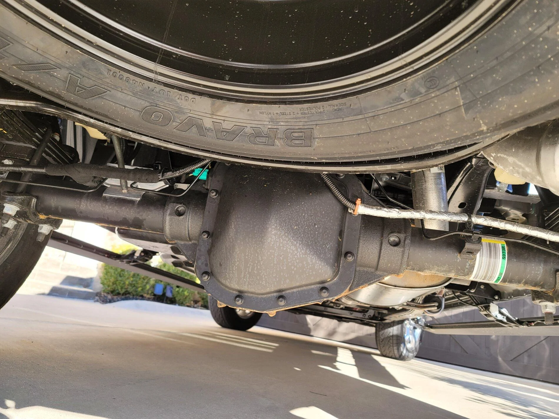

Yeah the 8.8" Axle pumpkin is a squarish shape pretty symmetrical from left to right, whereas the 9.75" Axle pumpkin is not the same left to right. It's hard to describe the shape. I was hoping Crapblaster got a shot of the pumpkin.
I'd really like to see if the axle part number on the stickers in Crapblaster's pictures is the same as the Max Tow axle. I guess if you can get a pic of those stickers for a truck with an EB or PB with Max Tow we'll know if the axles are the same with and without Max Tow.
That way, if I call my dealer and find out my truck still hasn't been scheduled, and that I'm getting hit with the $650 price increase for Max Tow, I can at least decide If I'm willing to ditch it to save money. We're already paying double for almost all of the content of Max Tow on a Powerboost Truck. And with the low payload numbers most of the 1,400 lb increase in trailer weight for a Max Tow truck cannot even be realized because the tongue weight is eating up all the payload, so Max Tow looks even more expensive and useless. It basically just becomes slightly larger rear brakes and the ability to get the tow mirrors. Those are some very expensive brakes and mirrors.

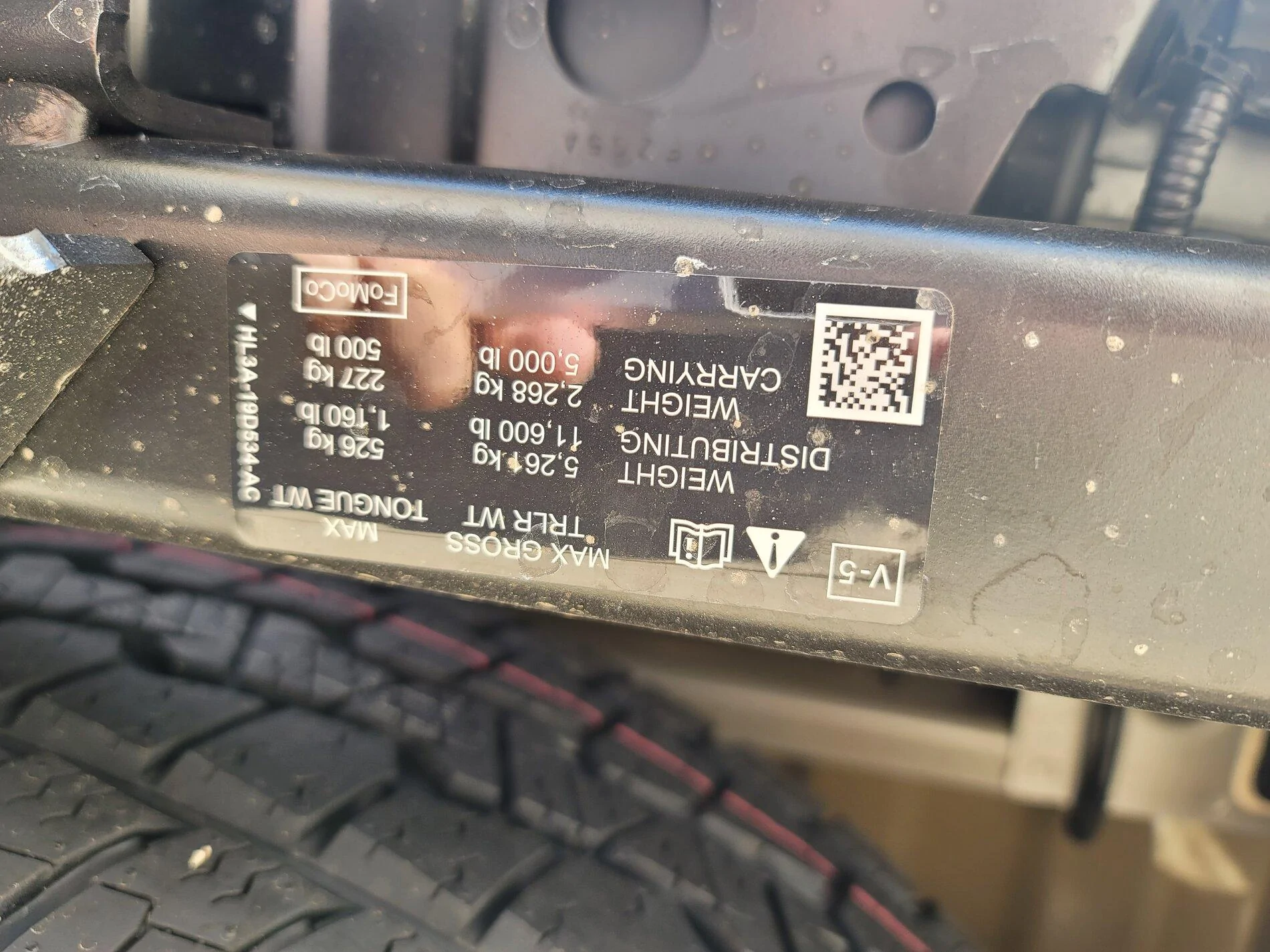

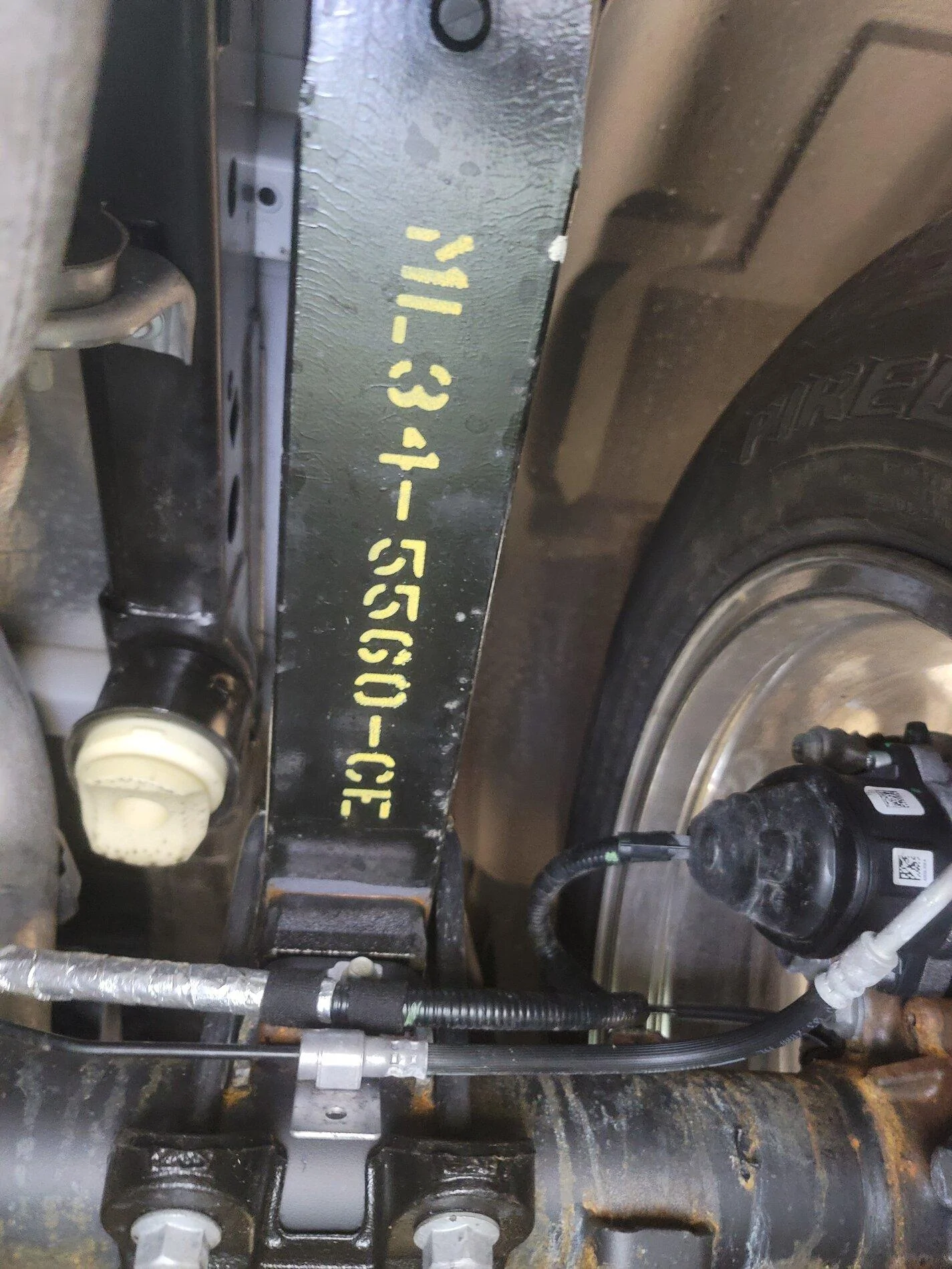

Ok Roger, here's a pic of my pumpkin. I'm also throwing in a picture of my differential. I also found this sticker on the receiver hitch.

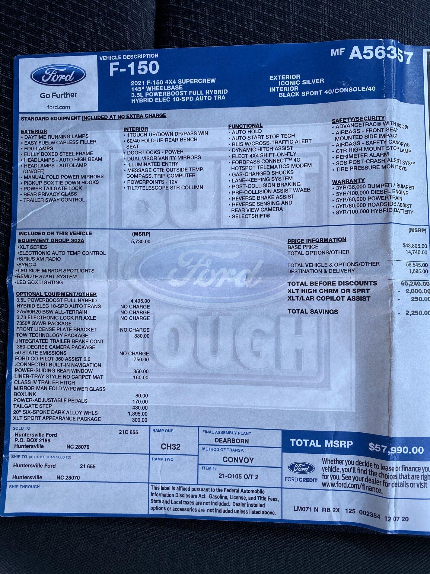

I think I see then issue here:
-Google

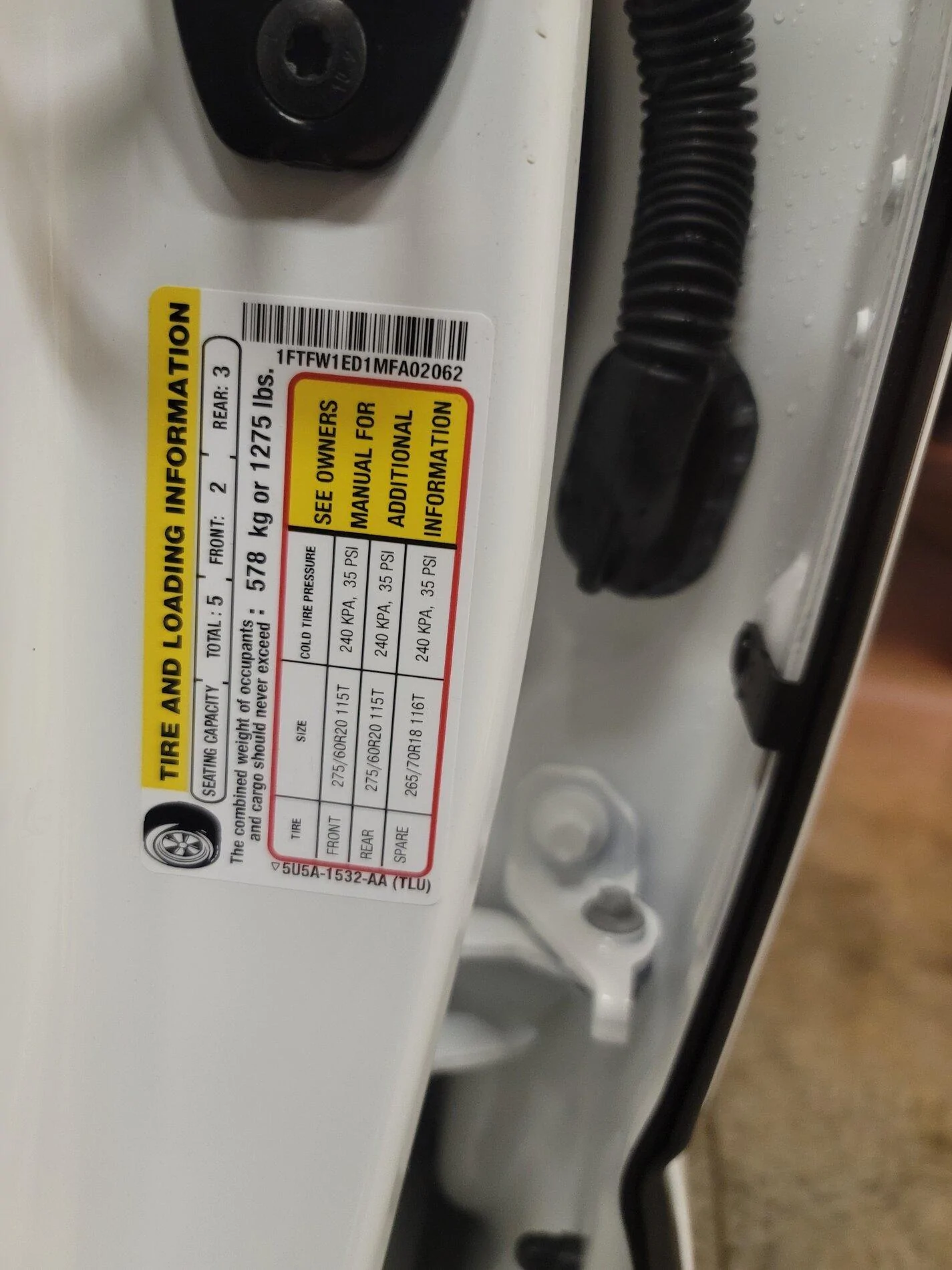

So the 20" wheels and/or tires are most likely reducing the rating. Maybe the axle could be the HD version, but without the wheels equipped with the HDPP, it can't get that rating?
The old 20" sport wheels on Lariats used to lower the payload by 250-300lbs.
With PB XLT/302/chrome package(or probably anything with chrome package) adding max tow REQUIRES 20”.

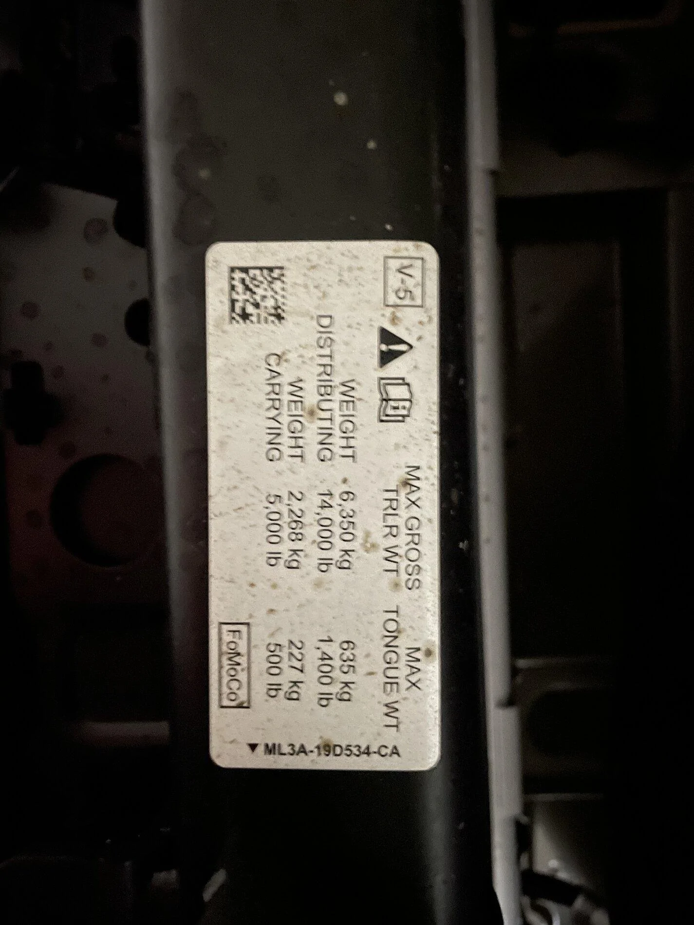

I see on the above pictures, the PB with only the technology package has a lower hitch rating.
Does the receiver with the normal tow package have the same 1400lb tongue weight rating as the max tow?

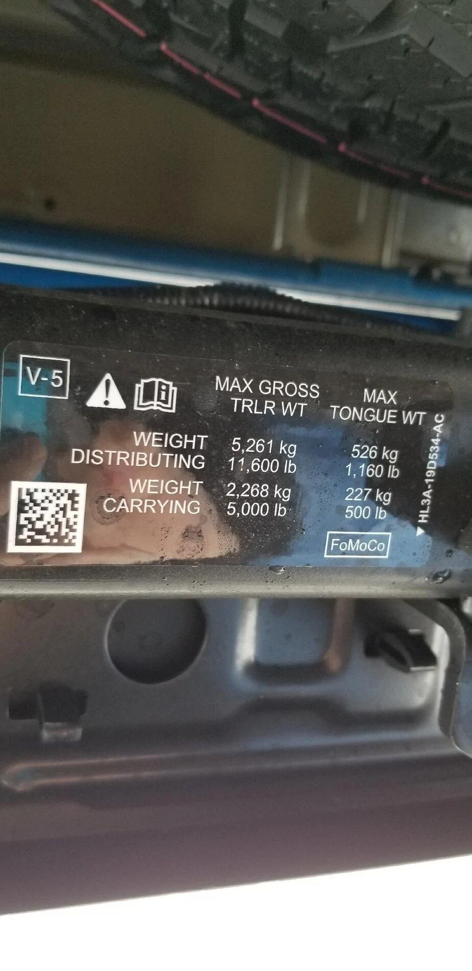

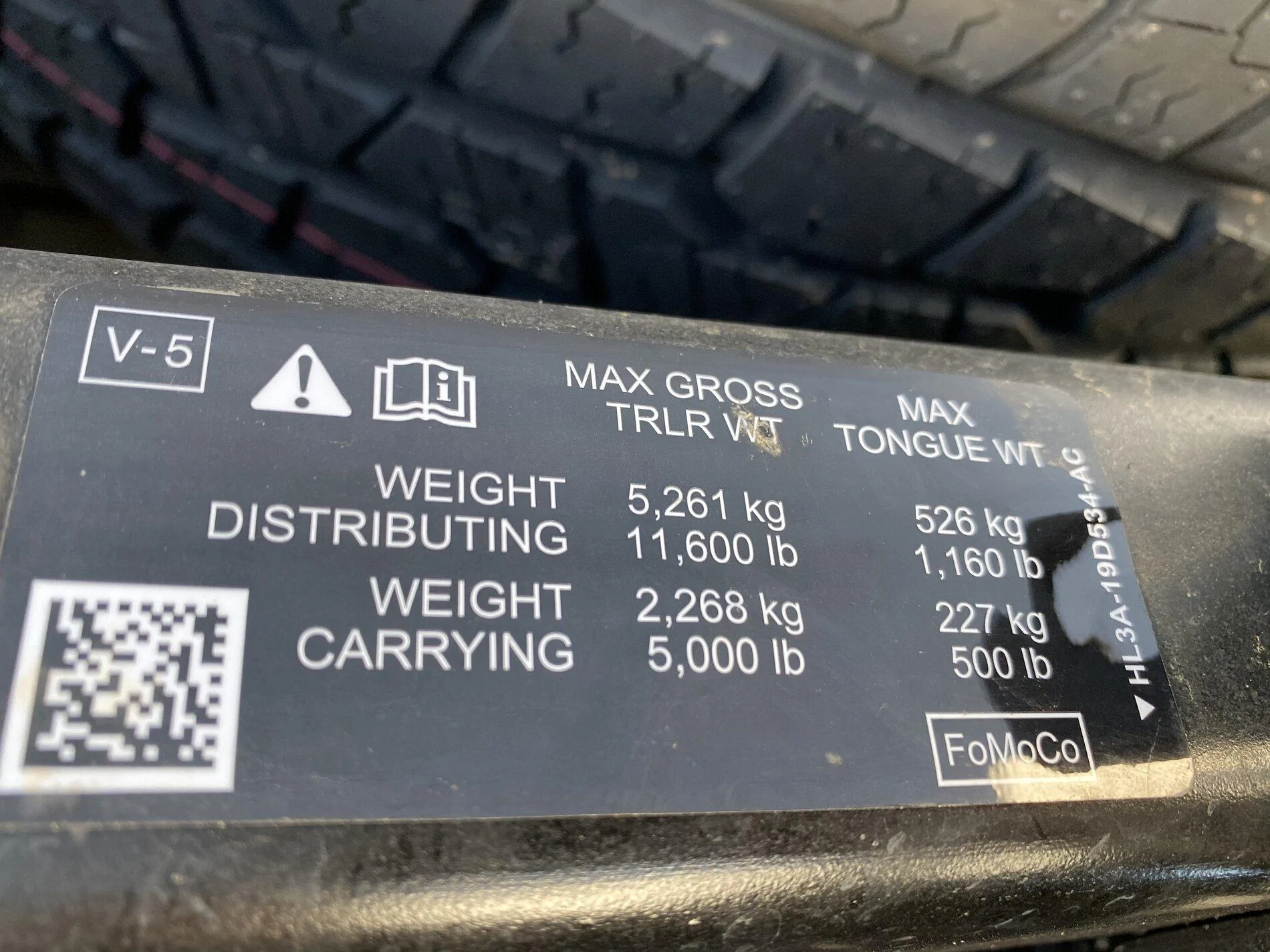

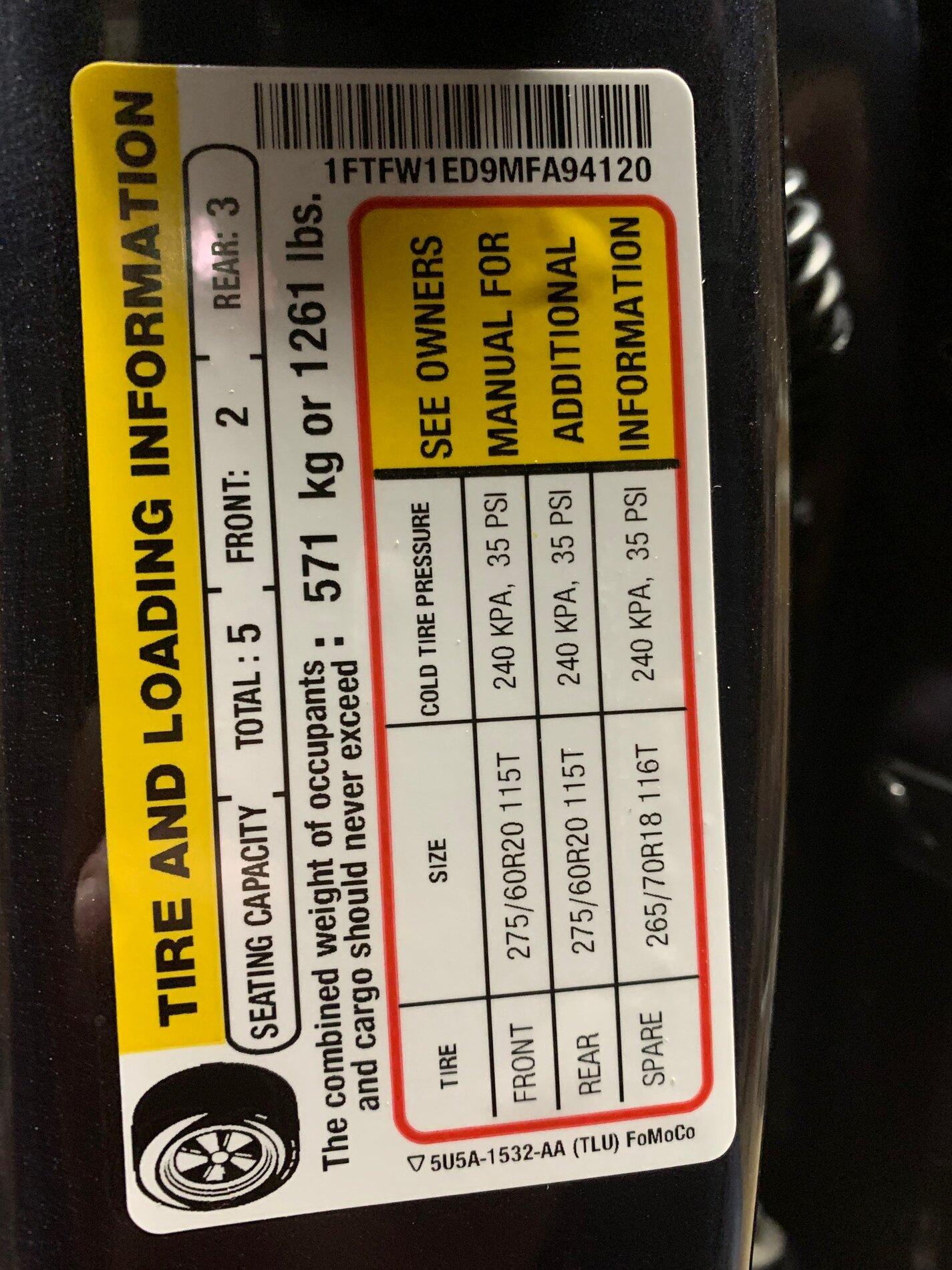

My Lariat PB with the Regular Tow Package:
Ford F-150 Lightning GAWR (axle) stickers for regular/max tow and EB/PB Blue Devil Hitch Receiver

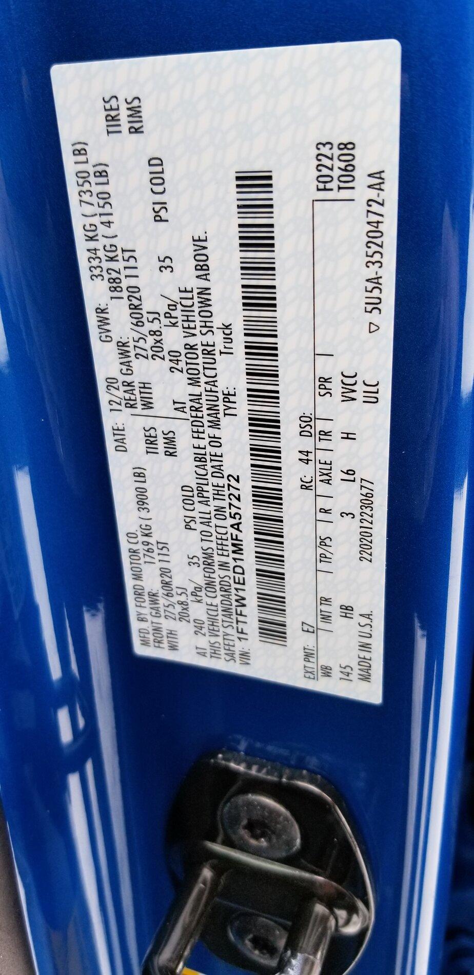

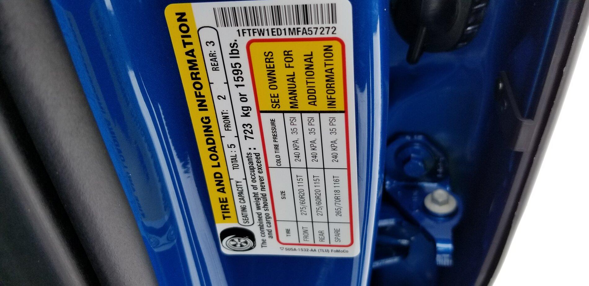

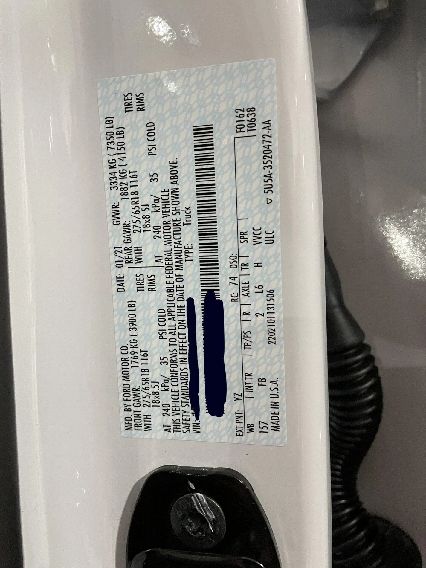

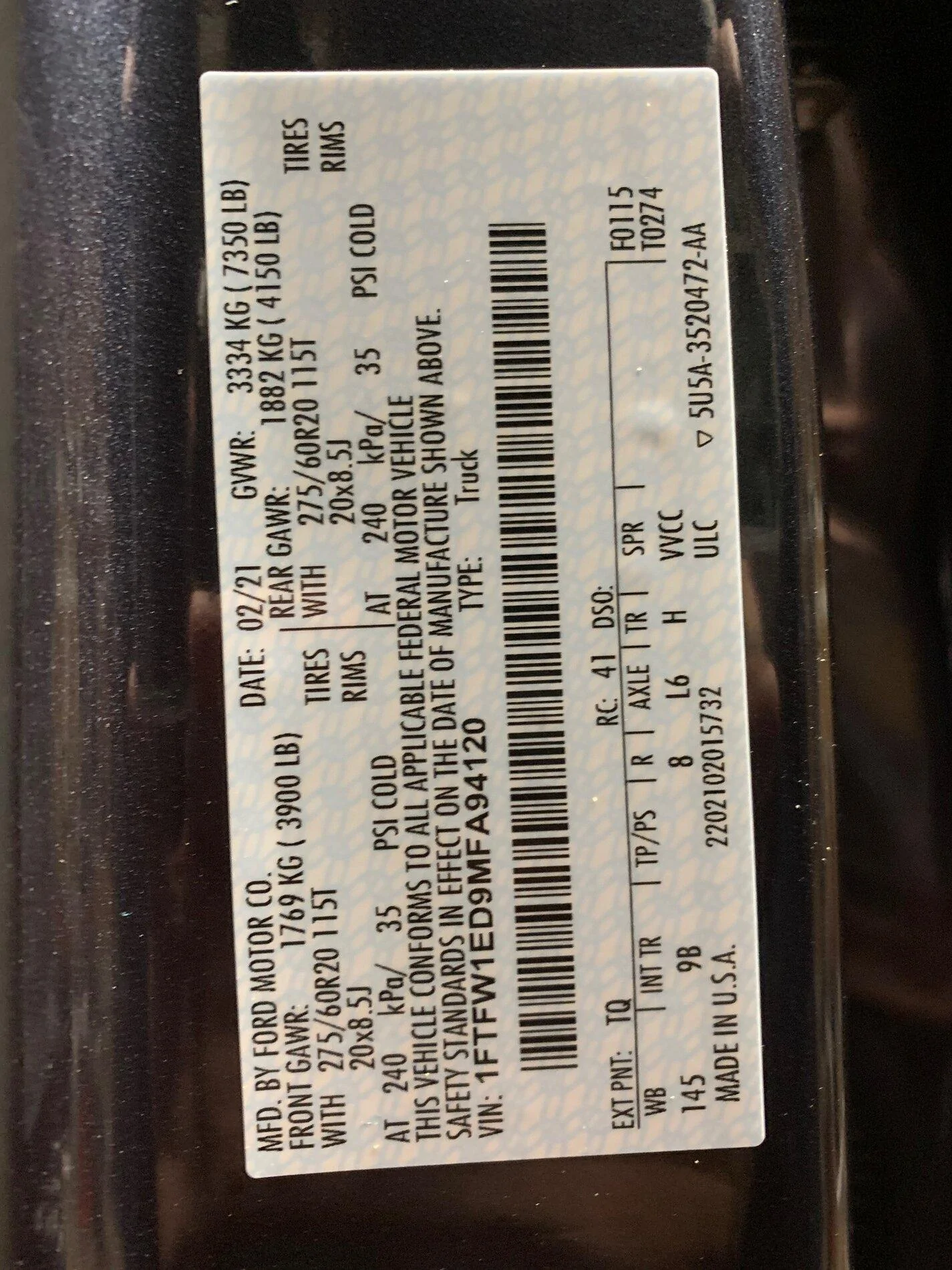

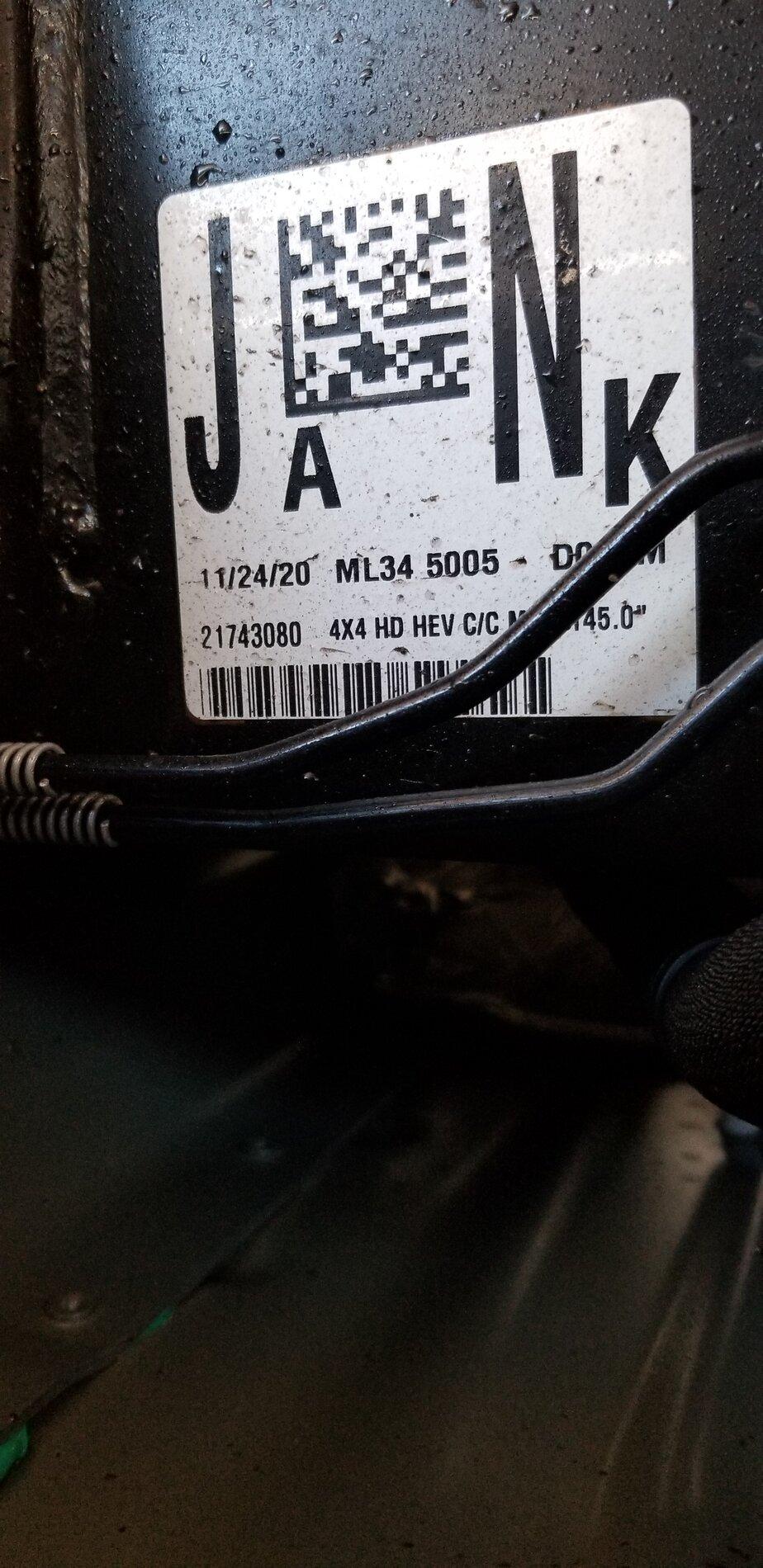

Energy
Powerboost Screw XLT Sport 302a 157”

I pretty much ordered the same truck as you - Powerboost SCrew 7350# GVWR Max Tow Package except mine is a Lariat. Can you post pictures of your stickers - payload and the towbar that shows the max distributed weight. I tow a trailer and MiniEx occasionally that = 9000. Thx. Also like the looks of your Lomax. Mine hasn't arrived yet, but neither has my truck.

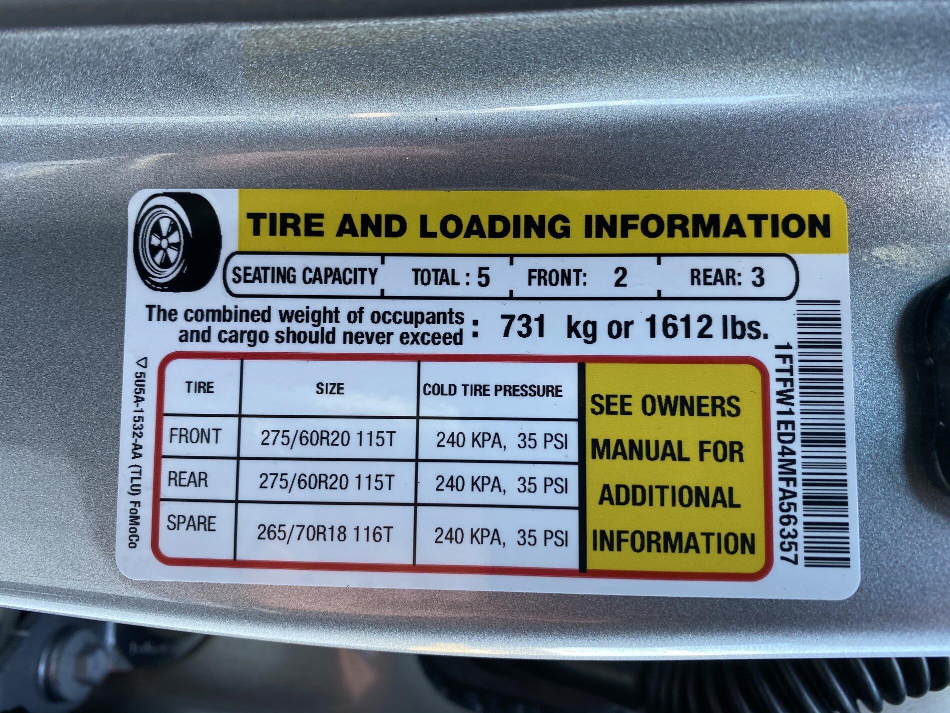

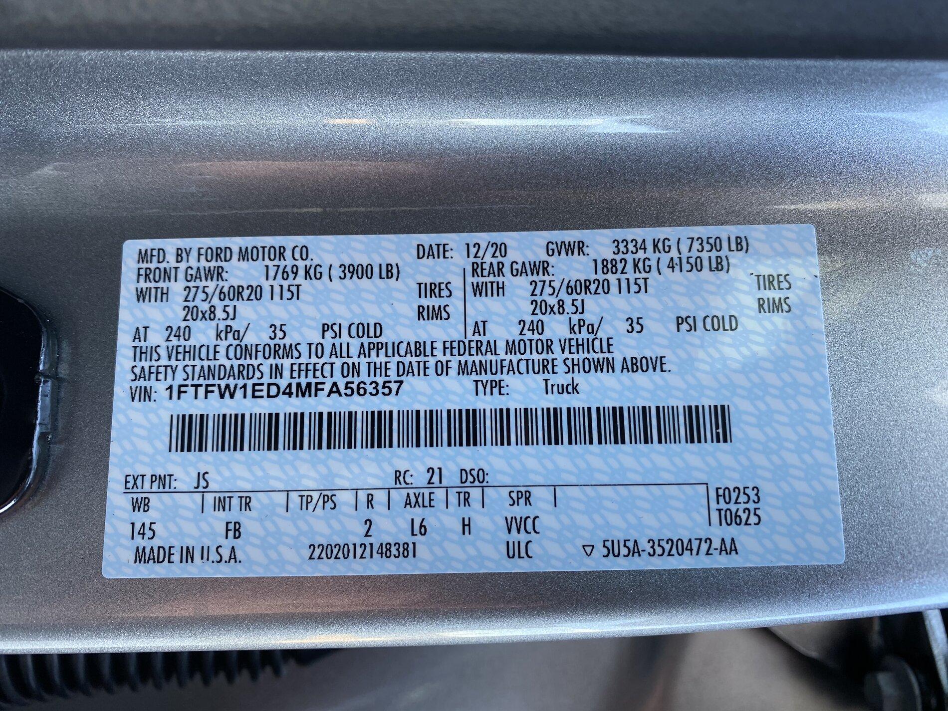

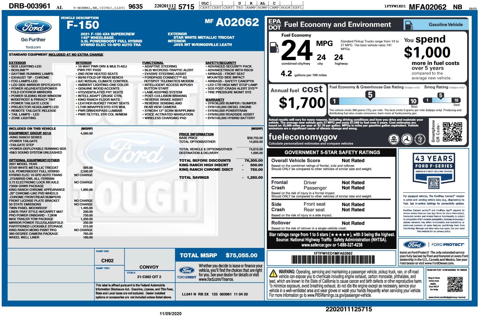

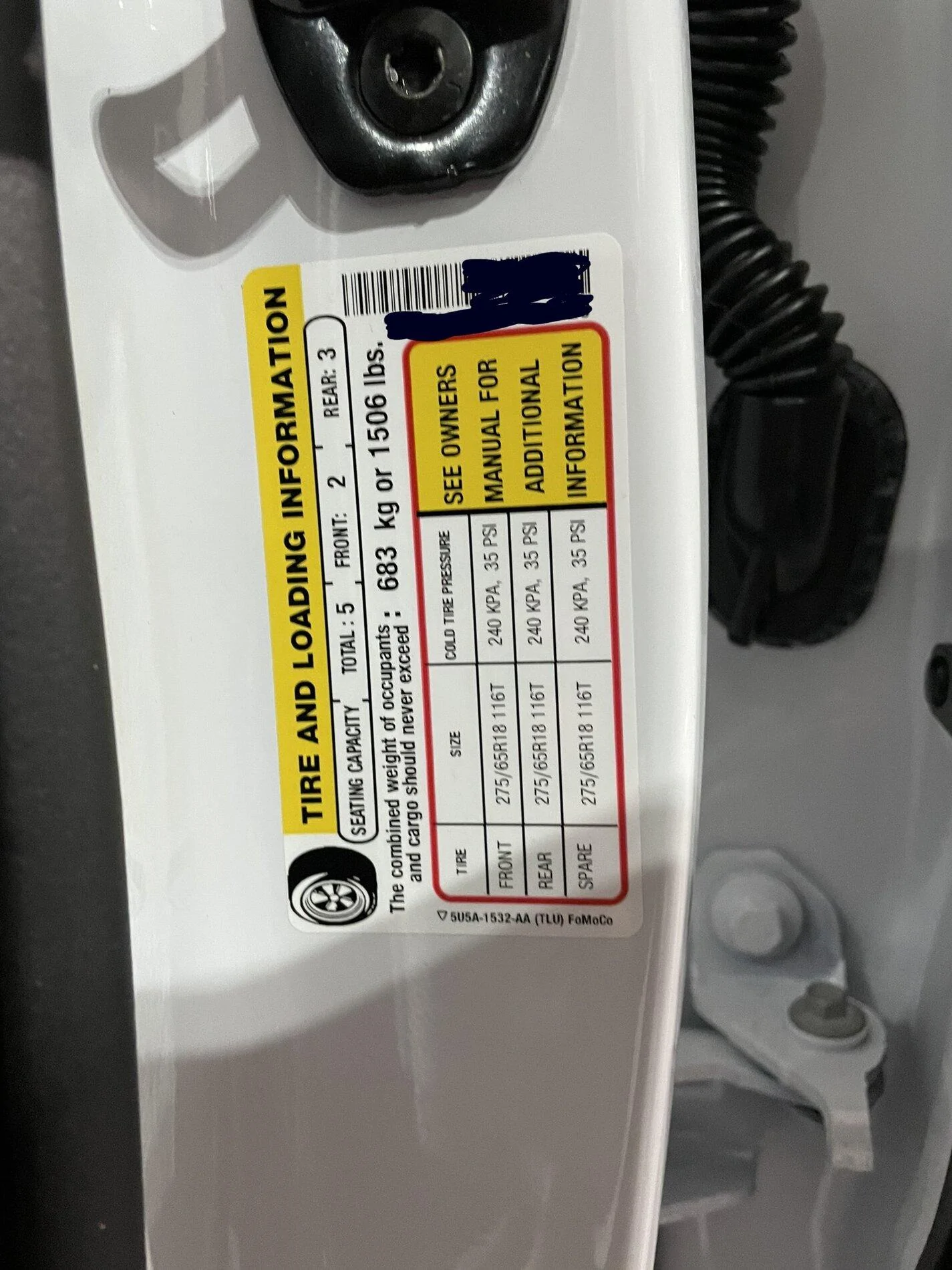

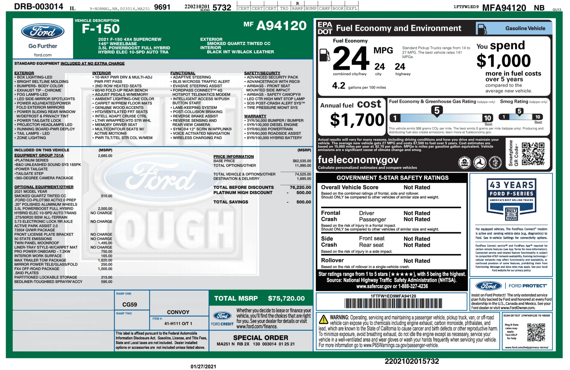

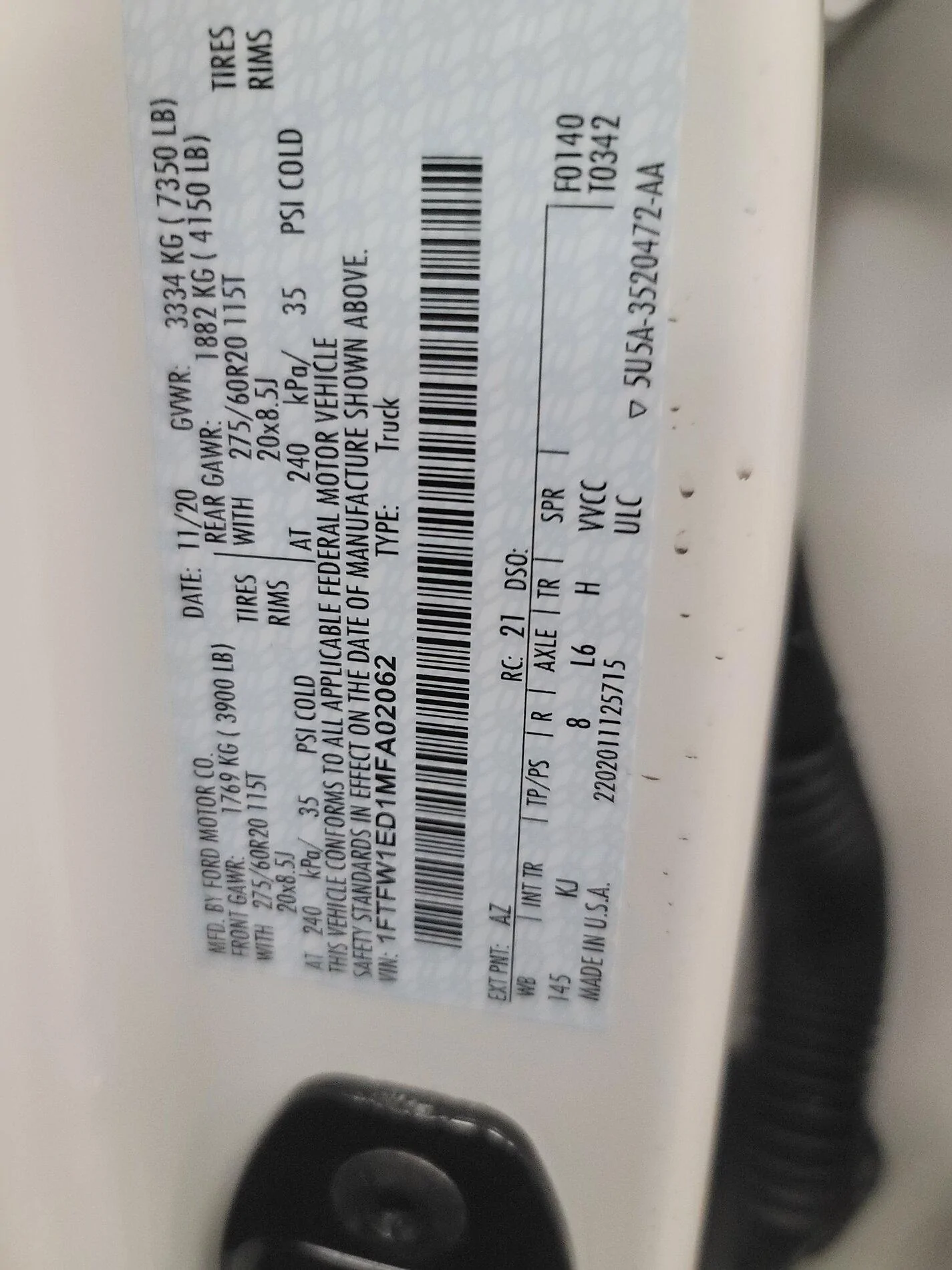

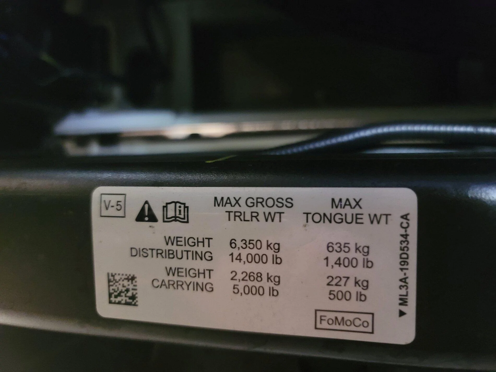

Platinum SCrew, PB, Max Tow. Just took delivery. Love the truck!
Ford F-150 Lightning GAWR (axle) stickers for regular/max tow and EB/PB Window
Ford F-150 Lightning GAWR (axle) stickers for regular/max tow and EB/PB GVWR
Ford F-150 Lightning GAWR (axle) stickers for regular/max tow and EB/PB Payload
