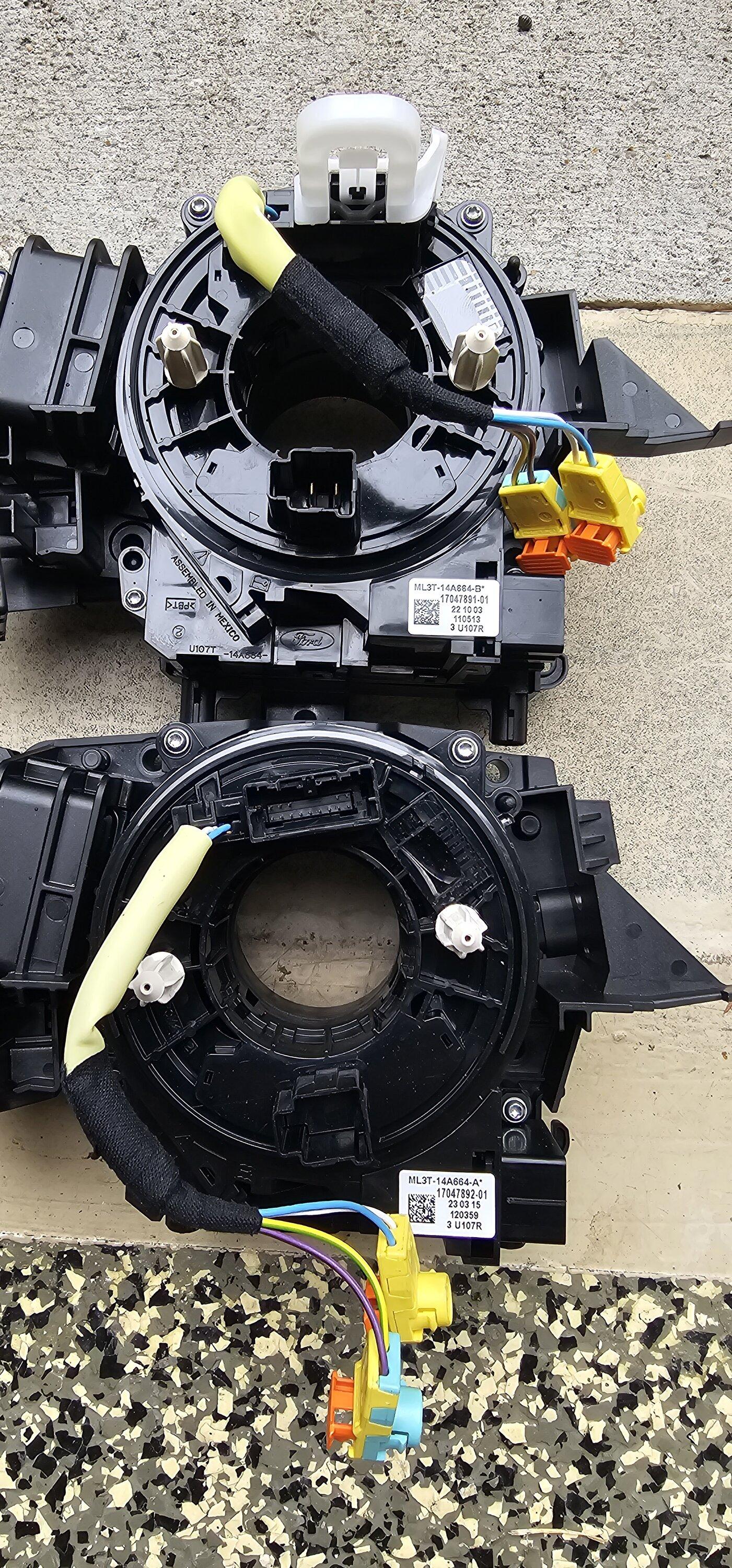

I have retrofitted my lightning with the heated steering wheel part but cannot get it to turn on. I have verified and updated all of the module settings from a Platinum that has the heated steering wheel but it still won't turn on. The button is on the screen, I have no DTCs and I have no error codes and I have tested and passed each module. There are 4 locations that I have found that need the changes. SCCM, APIM, IPC and HVAC. Has anyone had success doing this and could provide steps so I can confirm where the issue may be?

AFAIK, there are 2 major components. The wheel itself with the filament and the controller/module. This is how its configured on my Mach E.
Just curious, did you also install the controller or just the wheel

Also, I suspect you can enable the icon on the touch screen without having all the hardware installed. I believe the display is somewhat independent of the what hardware is installed, so you can turn on the heated wheel icon but its not attached to anything on the other end of the CAN Bus.

I replaced the entire turn signal mechanism and clock spring with the part number that actually includes the module and elements that make the heat work. The coil is already in my steering as you can see where the harness is plugged into a part that has no receiving pins on it. The new part contains the module and the connector behind the air bag has the prongs which carry the current to the heating element. Unless there is another part that I am missing between the two like a missing fuse or something I am at a loss.
