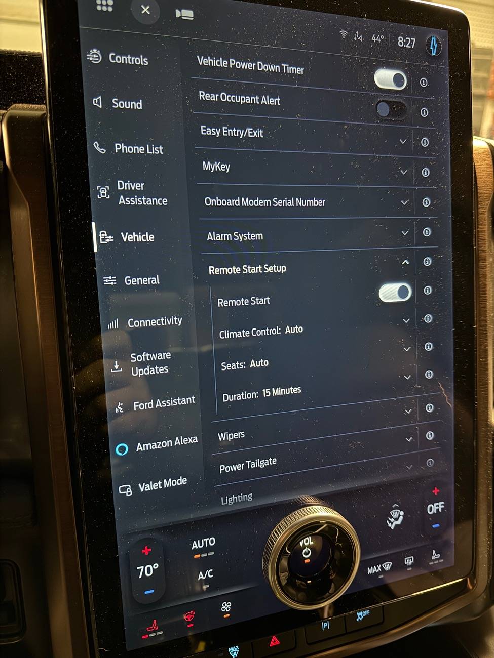

@techmatters are you saying that when you look at the Sync screen vehicle settings for Remote Start that you do not see a drop down for heated wheel options are {AUTO or OFF}?
I'm curious if turning it off for those of us who have control disables visibility in Fordpass?
Side note, sometimes my heated wheel functionality is inconsistent with departure time and or remote start climate, most of the time when I jump in the truck it's warm but when I PUSH TO START, the lamp does not illuminate, I manually turn it on, other times it'll be on.
BTW my heated wheel came with truck as built.
I don’t have the heated steering wheel in my drop down menu, I’m guessing that’s part of the issue.

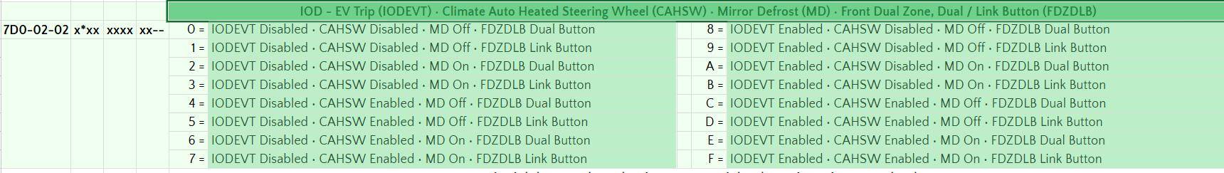

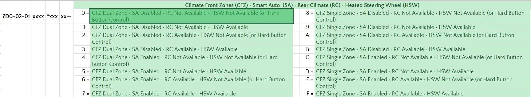

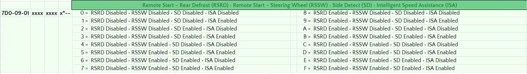

A-ha! That I may be able to help with. I would start here in the APIM. It may take some tinkering, but the key is here.

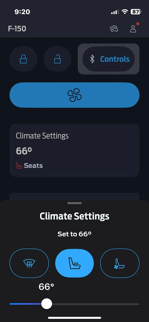

So I have noticed when I remote start my heated steering wheel does not come on. I had the retrofit performed last year.
Today I checked in my app and I see that you can set the seats to heat or cool, and activate the window defroster. But I do not see the steering wheel icon. It does not appear that there is even space for another icon.
Does the dealer need to do an update to let ford pass know the heated wheel is there? Not the end of the world, but would be nice.

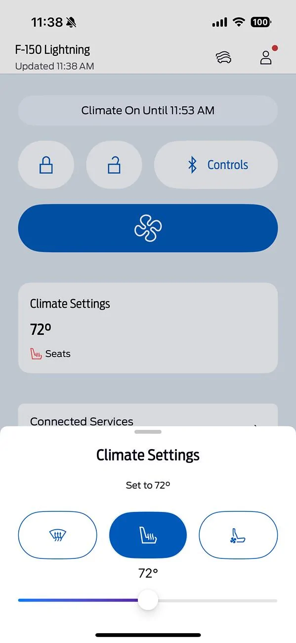

My retrofit was done last week. I didn't even realize this was an issue until I saw your post. My heated steering wheel works fine but I did notice this morning it was not on when I remote started and my app looks like yours. No heated steering wheel option.
Can this be enabled in Forscan?
