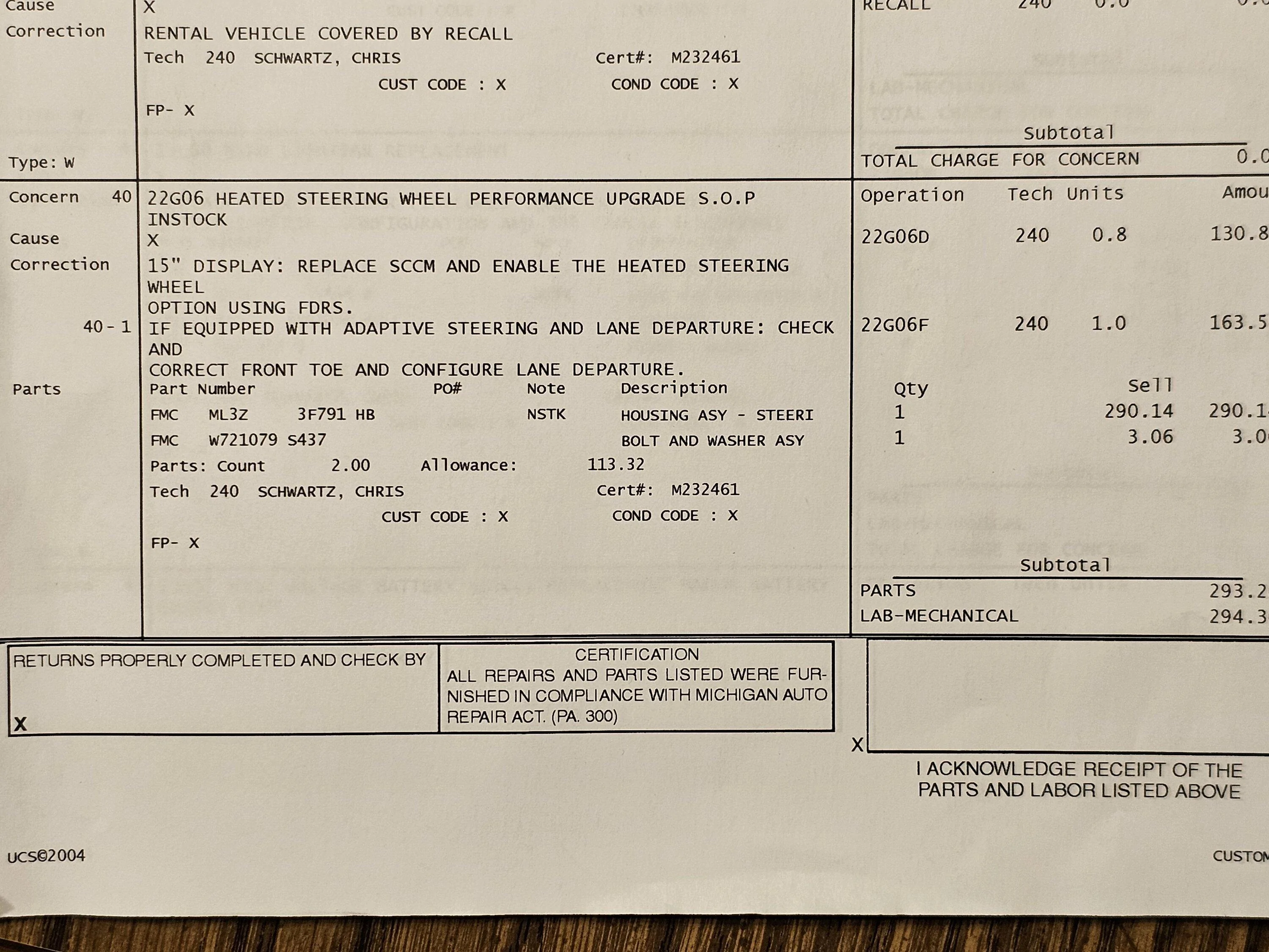

I had my heating steering wheel installed today. The heated steering wheel works. Yeah! Unfortunately, they installed the wrong module. The issue is that there are currently three different steering wheel module part numbers: one NOT equipped with Auto Wipers OR Power Adjustable Steering Column; one Equipped with Power Adjustable Steering Column; and one Equipped with Auto Wipers. Unfortunately, Ford does not have a module equipped with Auto Wipers AND Power Adjustable Steering Column. I have both. My local dealer ordered the one with power adjustable steering only (ML3Z- 3F791-HB) and I lost the auto wipers. They are going to do more research.

Can you find your paperwork to see what part # they ordered?

Thank you very much. Odd, you have the same part as me but mine is not working. I have confirmed the option is enabled in the settings. Grrr.

I wonder if yours was fine during the time when the configurator was not working correctly
