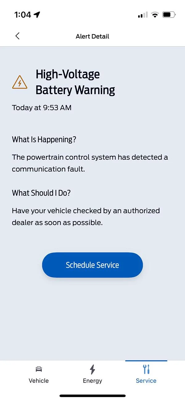

A couple of days later I was having issues with the modem working on and off so I pulled the Fuse 32A. Reset the modem and everything seemed to be working fine. Seemed like it cleared some sort of "clog" too as a whole host of messages came through on my Fordpass app shortly thereafter (free trials being started, etc.). However, that same day I started getting a new Service message in my Fordpass indicating a "High-Voltage Battery Warning" and the "Powertrain control system has detected a communication fault." Here is where it gets weird. I am ONLY getting the error message in my Fordpass app. If I log into my account on ford.com it says my vehicle is in excellent health (shows no powertrain issues). The truck drives perfectly fine and I am getting no error messages on the dash. Below is a screenshot of the error message from the Fordpass app.
Took it to the dealer yesterday and they did a bunch of software updates and sent me on my way. Said that one of the OTA updates appeared to have crashed mid update and that was causing all sorts of issues. They forced through the software updates at the dealer and said it cleared all of the codes and that I would be good. I left the dealer and immediately got the same error message on my Fordpass app. Went right back to the dealer where the truck sits now for them to try and figure out what's going on.

Just an observation from experiences I've had, communications and timely notifications is not been Fordpass' hallmark, given that you appeared to have that initial issue with comm's.
If the tech say's your all up to date, that doesn't really mean much, they don't want to spend hours of unpaid time to catch up everything that will eventually come as OTA's , they will come in due time and typically start after a communications log jam has been resolved.
As long as the truck is performing well, ie. no actual reduced power, it's charging on Level-1, 2 and DCFC then all should be good. After a week, if these disturbing notification continue to post make a new visit with service to have them review the situation, you could also call the Ford hotline to see if anything is wrong with your connected services and Fordpass account that they can remedy remotely.

To add to what @TaxmanHog just posted, it might also be worth deleting the FordPass App entirely from your phone (data and all) and reinstalling it.
Can’t hurt and might actually help.

Thanks for the suggestion. I tried this, but no luck. FWIW this was also the suggestion from Fordpass's 1800 support number.

Dealer still hasn't been able to figure it out. They are saying they have been in touch with Ford and Ford has not been able to help. Master Reset the Fordpass from the truck hoping that might help but no luck. Still no help from Ford directly. I sent them another DM but am not holding out hope!
Not sure if this is related but this happened on the night of 10/4 - which my Oasis report is listing as the date of my last OTA update. It lists as "cancelled" though I didn't cancel it. I had the dealer send me the recent Oasis page, but does anyone on this forum have the ability to pull my full Oasis report (if that's even possible)? I asked for it from Ford but they told me I have to ask the dealer (sounding like a broken record in that regard!). Please DM me if so.

@rugedraw may be able to assist. He has been able to see what updates are outstanding for your VIN.

I'd be happy to take a look. Even if there is something obvious, without FDRS, it would be virtually impossible to fix.
@Katonah Mike I may not be able to do anything, but message me your VIN and I'll gladly poke around and see if I see anything.
