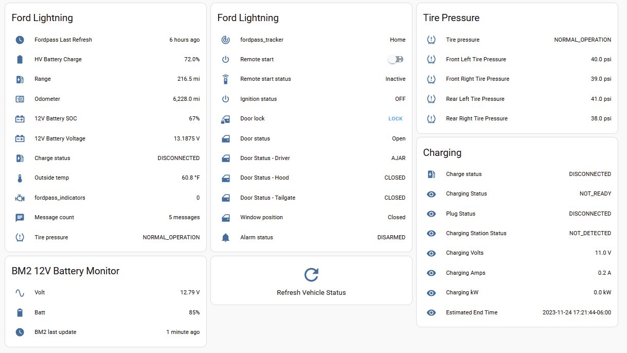

I dont have the charge station installed yet so some things dont exist, but THANK YOU for this! It's much nicer to look at than the huge list.

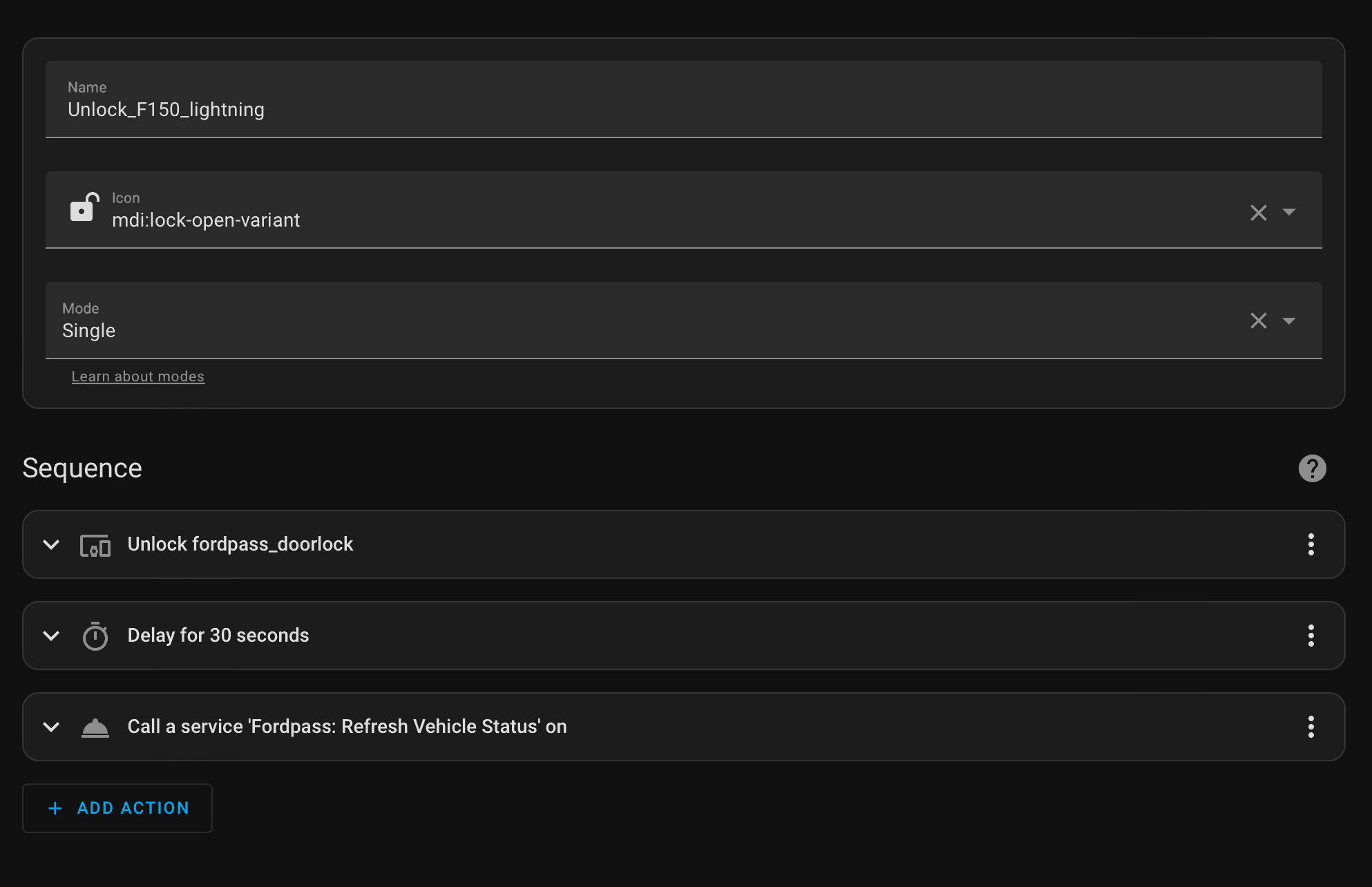

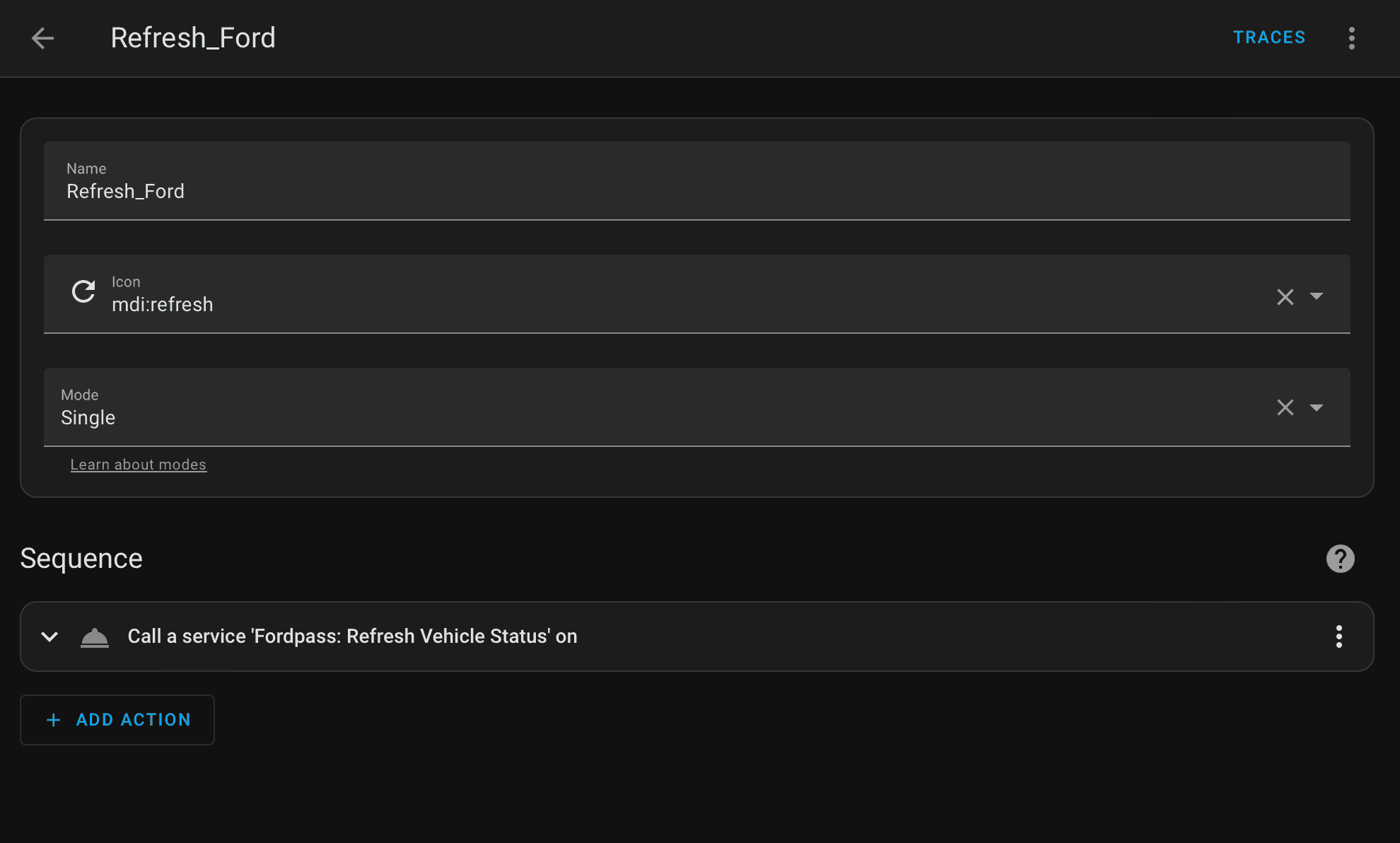

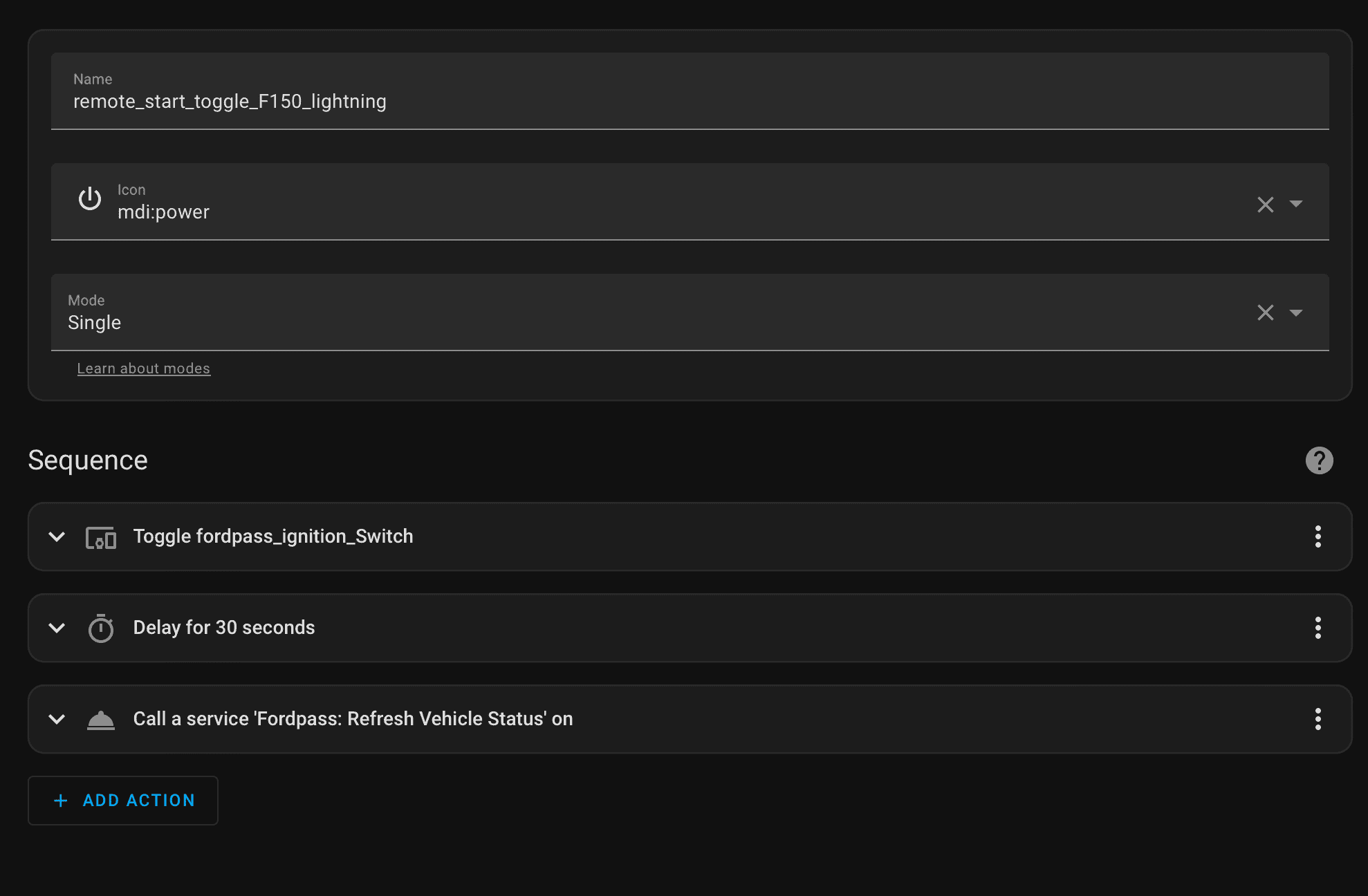

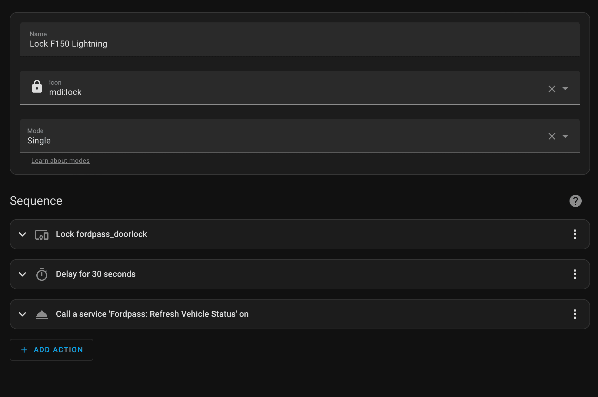

Be aware that my YAML is full of errors - I'll be updating it regularly, so you may want to do the same thing with yours ;)
To do: fix the "refresh" icon, and also add automations to the turn on.

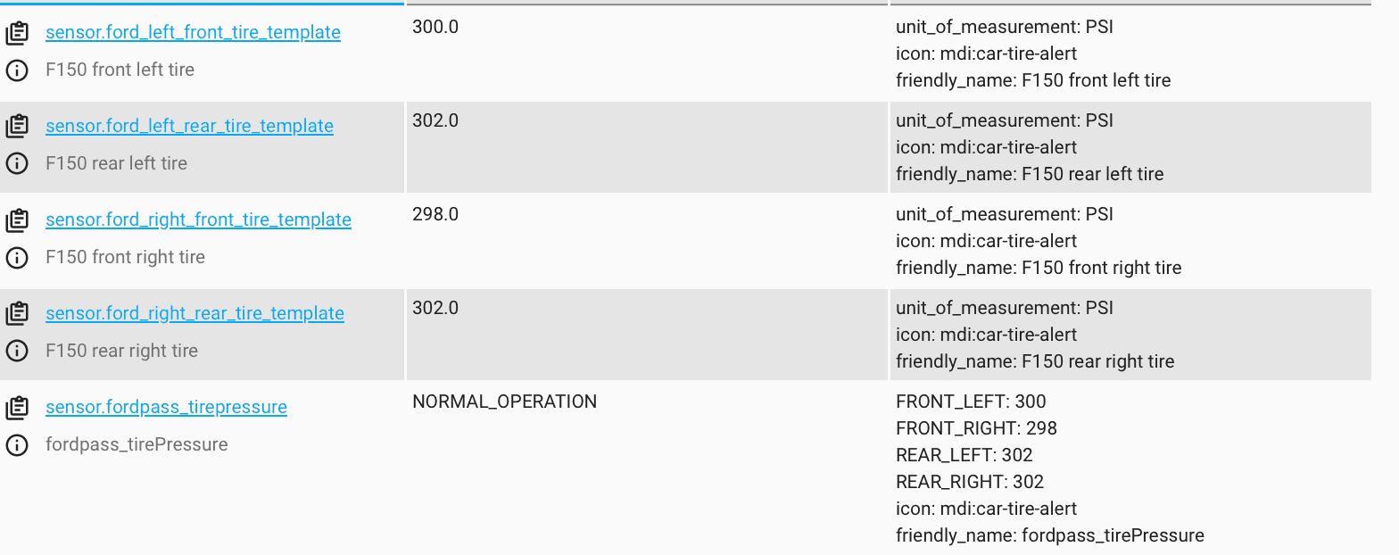

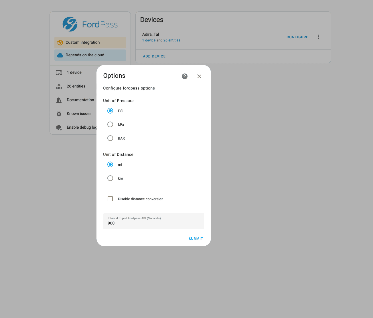

The tire pressure stuff was causing me some grief, so I ended up taking that out. I think fordpass itself is supposed to send a notification when one is low, so I'm not as worried about those. I still think it's not seeing my sensors.yaml, I havent figured that out yet. I'm very new to HA in general so this is all new to me.

Absolutely - I was thinking ESP 8266 - Don't want to go directly into it - I haven't done ANYTHING to it yet, as we're still not 100% working ;). But yes, I did get a look when it was last being worked on and yes, it does have two RJ45 ports, one above the other, which makes makes me *think* it might be using a similar setup.
However, I'd not be tinkering about with it any time soon. Too expensive ;)

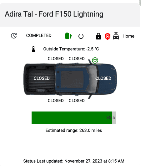

As for the YAML: see an updated version here:
YAML:

This now INCLUDES the correct code to do the following:
1) Activate a script to refresh the status of the F150 Lightning (Use sparingly)
2) Lock and unlock the doors via two separate scripts. The icons that appear are conditional, so you set the HOLD action to activate the opposite script to the current state.
3) Toggle the Ignition on and off (preconditioning)
Some notes:
You'll see from the attached images that the Lock/unlock scripts and the ignition on/off script uses a 30 second delay and THEN calls for a refresh. This is to ensure that FordPass-HA has the latest data to go with your request.
Please note: overusing the refresh will likely cause your account to be blocked (temporarily or worse), so please don't spam Ford's Servers ;)
Ford F-150 Lightning Home Assistant - Ford F150 Lightning Dashboard. Screenshot 2023-11-26 at 9.40.26 PM
Ford F-150 Lightning Home Assistant - Ford F150 Lightning Dashboard. Screenshot 2023-11-26 at 9.40.17 PM
Ford F-150 Lightning Home Assistant - Ford F150 Lightning Dashboard. Screenshot 2023-11-26 at 9.40.05 PM
Ford F-150 Lightning Home Assistant - Ford F150 Lightning Dashboard. Screenshot 2023-11-26 at 9.39.58 PM

Just as an addendum, the software update notification works! - I just opened up the dashboard on my computer, and the icon for firmware updates was black (instead of the default grey!) I may look into a different icon for showing that particular feature, but I like that it works! ;)
Ford F-150 Lightning Home Assistant - Ford F150 Lightning Dashboard. Screenshot 2023-11-27 at 8.59.48 AM

Regarding tire pressure, the sensor data in Home Assistant indicates a value about 7x higher than the PSI indicated in the Ford Pass app. The factor is not consistent, ranging from 6.8-7.0x higher.
How are you handling this?
Ford F-150 Lightning Home Assistant - Ford F150 Lightning Dashboard. 1701284771200
Jakebeans
Jacob
Nov 26, 2023
Nebraska
2022 Lariat 511A ER Black
Controls Engineer
I know it says PSI for the unit of measurement, but assuming your tire pressure is around 43 PSI, those units are in kPa. Which would put the conversion at 1 kPa = 0.145038 PSI.
Nick503955
Nick
Aug 31, 2022
119
103
San Diego, CA
2023 Ford Lightning Lariat, 2021 Tesla Model Y
Perfect. The discrepancy in the factor was because of rounding in the Ford App.
Thank you!

Be sure to make sure you've set your preferred units in the ford pass options of Fordpass_HA
See screen shot below. You'll find these by going to Settings > Devices & Services > FordPass > Configure
Ford F-150 Lightning Home Assistant - Ford F150 Lightning Dashboard. Screenshot 2023-11-29 at 12.14.24 PM
