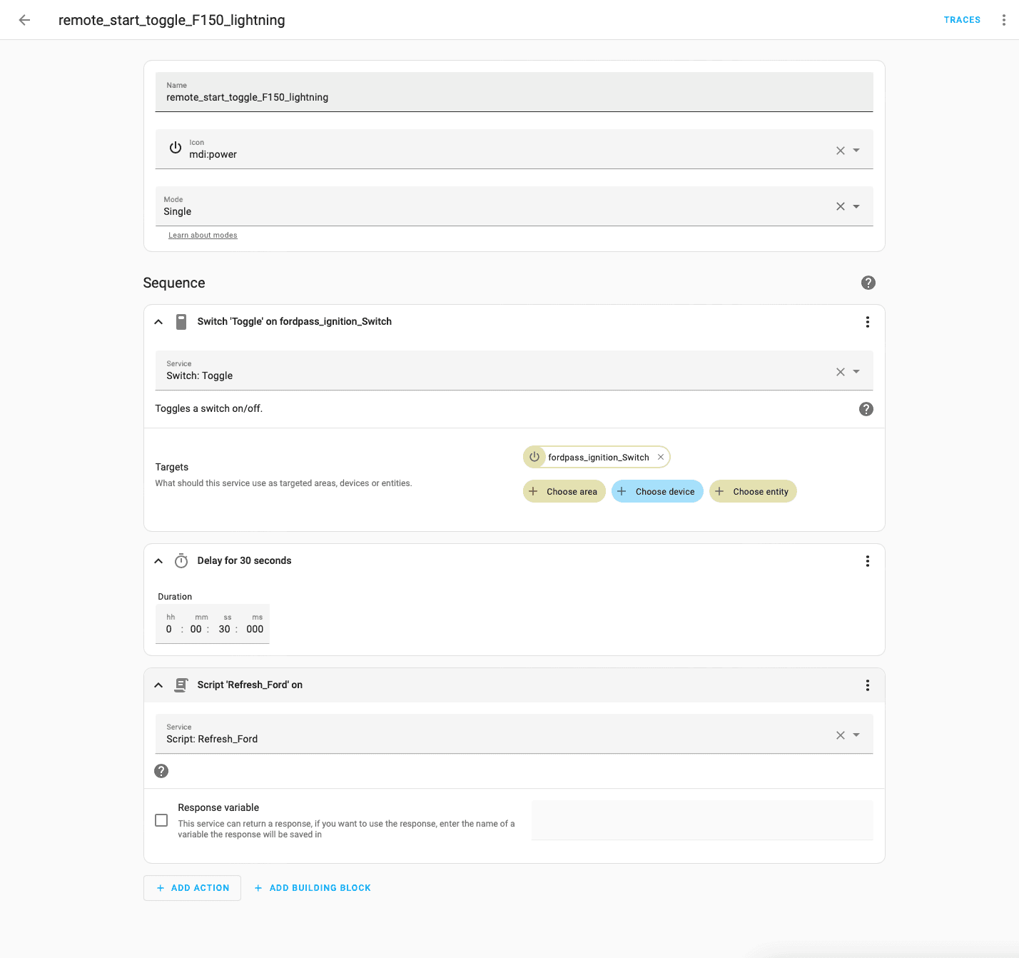

@Aminorjourney I incorporated your remote start scripts into my HA instance for my two vehicles (MME and Lightning), which is great because before I was just initiating the ignition on switch only without a refresh. Great results, so thank you again for starting this thread!
With that said, I've noticed some inconsistency between my vehicles. I have a homekit bridge in HA and the new scripts exposed so I can initiate them from the iPhone 15's action button through shortcuts (I have a menu pop down with the common things I need like LOCK the Lightning since there's no walk away lock feature, UNLOCK the MME since it feels like it takes forever for it to recognize my PAAK, and Remote Start for both vehicles).
All of these are now using the scripts from this thread and all of them are working flawlessly except for the Remote Start on the Lightning. It just like doesn't seem to respond to that one script through Homekit today, while the Lock script does.
Anyone using these scripts through Homekit and noticing any weirdness...and/or any tweaks that may help?

I've found the issue!
Look for the script for your remote start (you have one, I hope?)
It should look like this:
Ford F-150 Lightning Home Assistant - Ford F150 Lightning Dashboard. Screenshot 2024-02-07 at 12.42.24 PM
Alternatively, here's what it looks like in YAML (you'll need to add your relevant device_id and entity_id)
YAML:
alias: remote_start_toggle_F150_lightning
sequence:
  - type: toggle
    device_id: <DeviceID>
    entity_id: <EntityID>
    domain: switch
  - delay:
      hours: 0
      minutes: 0
      seconds: 30
      milliseconds: 0
  - service: fordpass.refresh_status
    data: {}
mode: single
icon: mdi:power
