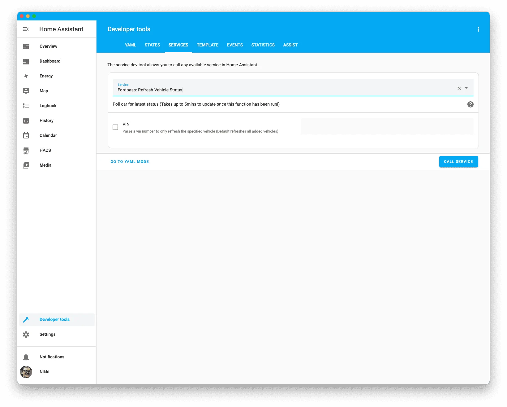

How are all of you handling updates/refreshes? I seem to have no luck with mine, it refreshed on the initial setup but never again. I tried triggering the two different services via automations and directly in the tools menu and no dice...
Mine will update - but I know Ford has been busy lately working on the servers (last week, IIRC). My truck does update, but certainly not super-frequently.
My latest card code will allow you to hit the refresh button (you have to hold it) to get it to refresh, but you can also force a refresh by using the "Last updated" text and holding over that.
Failing that, I've got nothing. Check that you've got the latest version of FordPass-HA. There have been a LOT of changes of late, and I know that @theUNSTABLE has been working hard to help adapt code on the FordPass-HA project to make things reliable.

I just checked and HACS isn't saying it is out of date. I set up 900 second refresh on the API poll, it doesn't seem to be doing it. The ford app is working fine to get updated stats, and it's the same login.
It's weird that deleting and re-adding the integration gets me updated stats, but nothing else will force it to update.

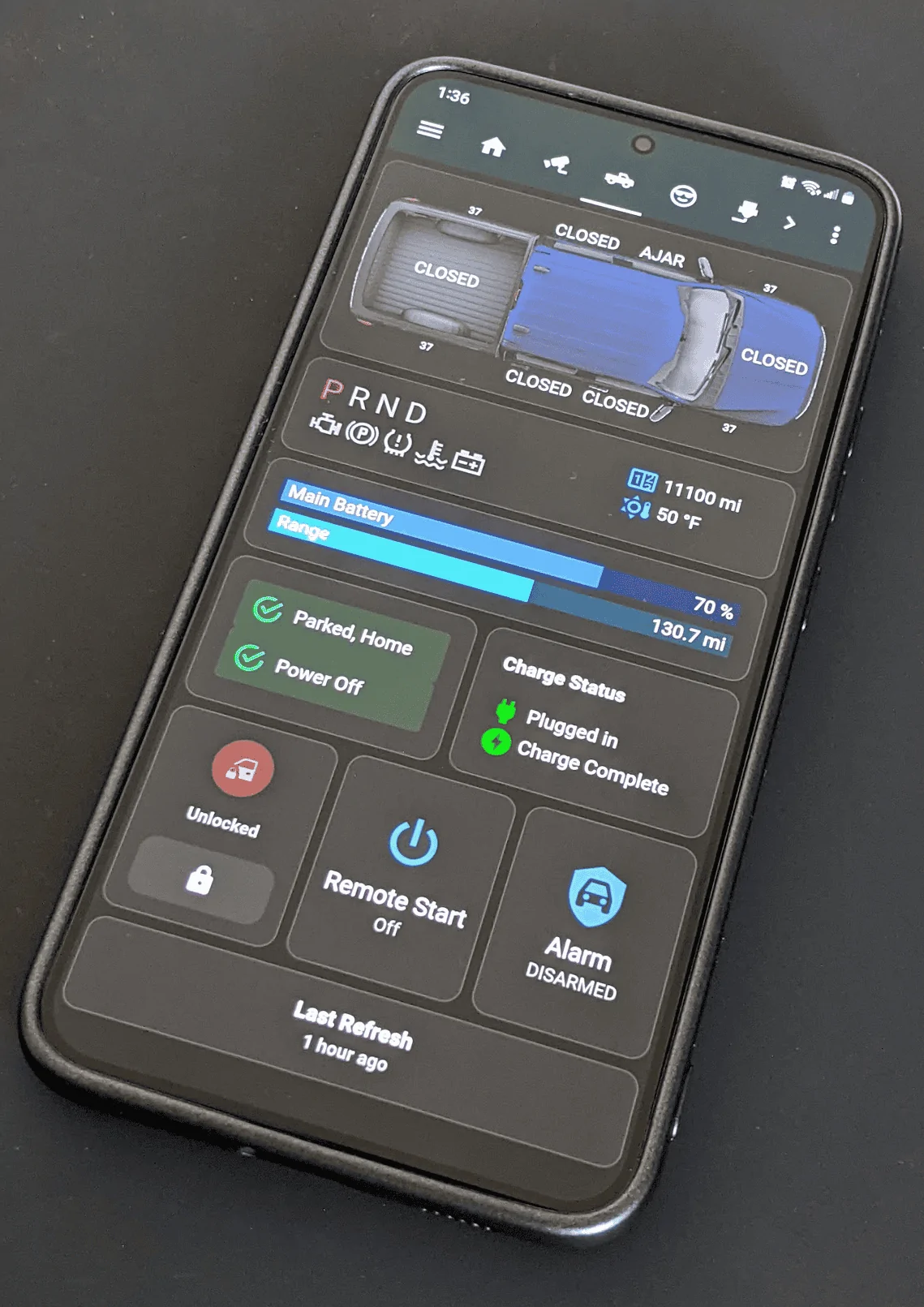

Kinda went a different direction, still using a picture elements card up top, but I spread a lot the info around to some other cards to keep it in a similar theme to the rest of my dashboards.
A really clean dashboard! Nice. Were these built using Mushroom cards?

The door locks card is a mushroom card, I liked how it handled the lock/unlock status, it made it really clear what a button press was going to accomplish.
Everything else with text is just markdown, bar graphs are a hacs item called 'bar card' but I do not recommend that integration, it seems to be mostly abandoned.

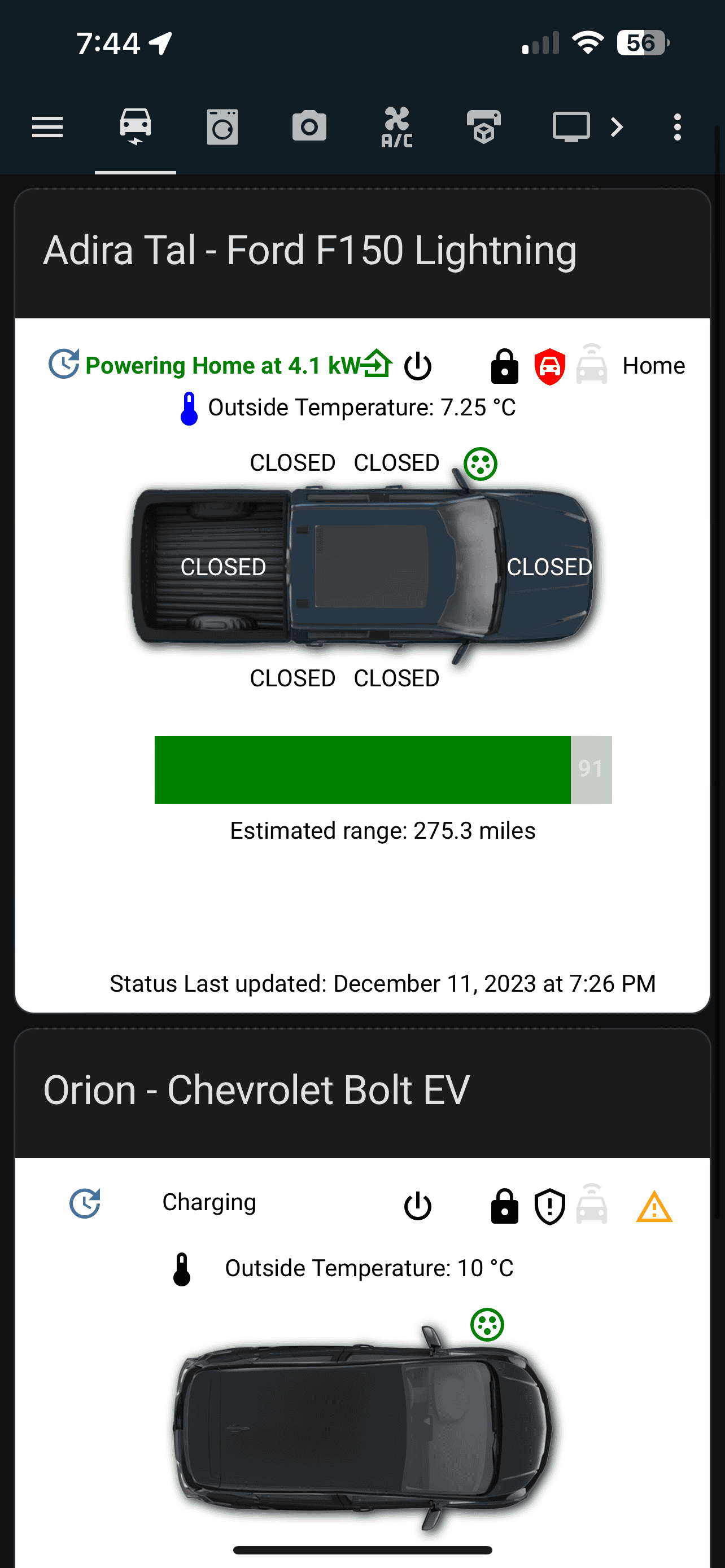

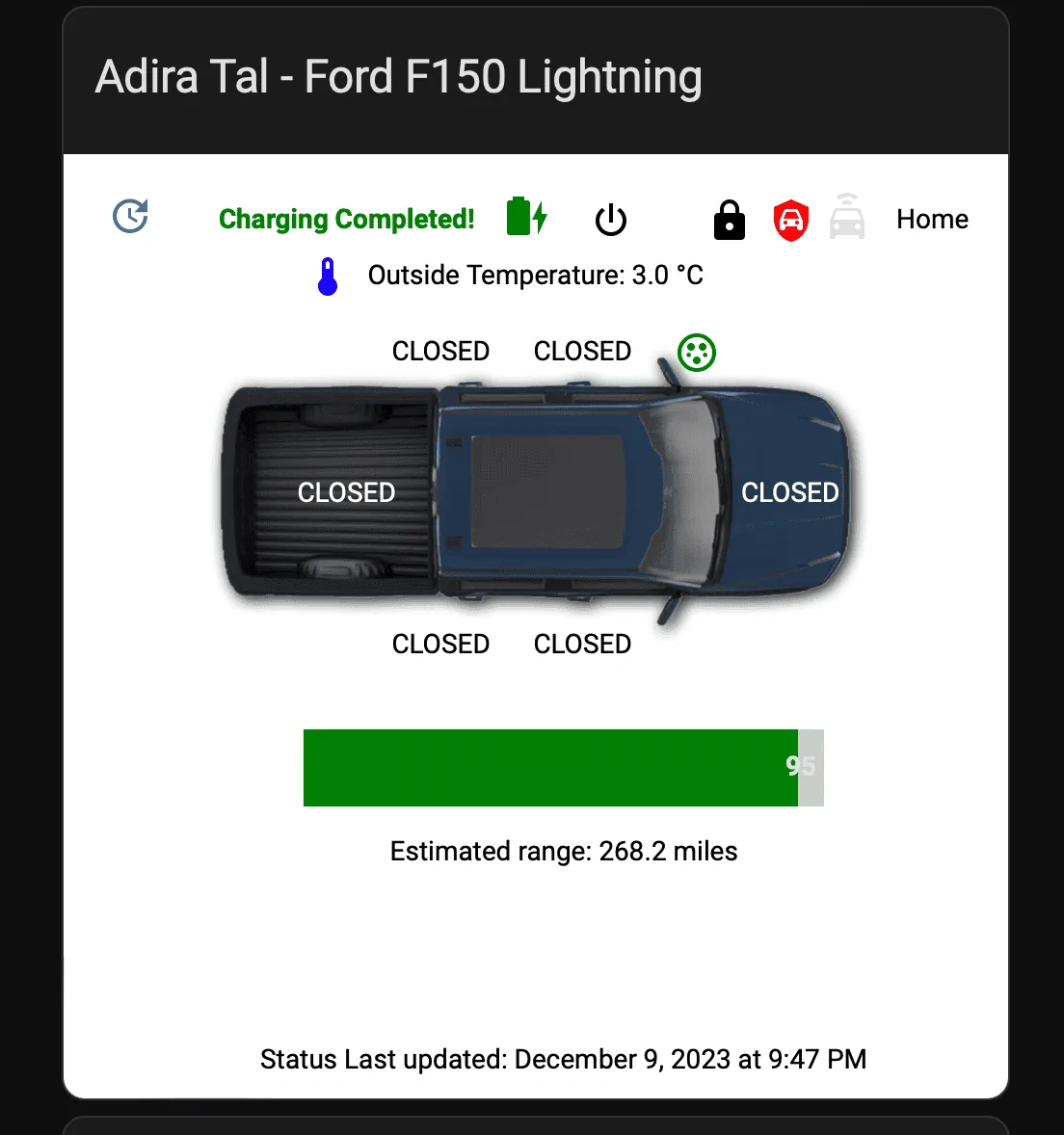

Another update from today - with some major changes in how things are added.
You now need to use this integration if you want to add text to the card based on status.
Ford F-150 Lightning Home Assistant - Ford F150 Lightning Dashboard. Screenshot 2023-12-09 at 10.10.04 PM
The card now changes and adds charging information as it occurs, and I've started to tidy up the codebase.
I'm also planning on using my Emporia sensors to represent charge in and out, but that's coming soon ;)

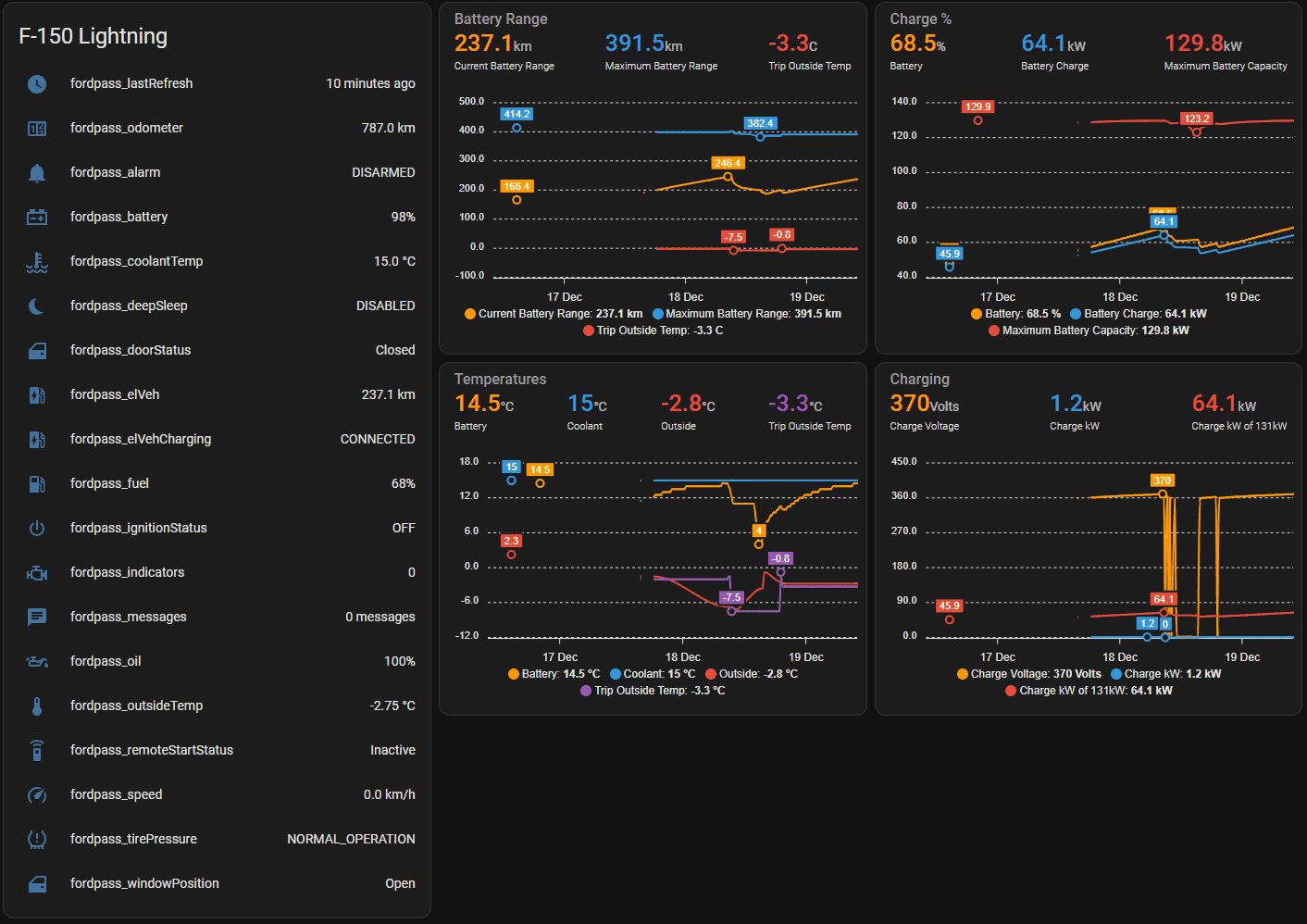

Tinglight
Dec 18, 2023
F-150 Lightning
Very nice. I love this sort of stuff. Here is a screenshot of mine. I got the lightning last week. Only have two days of continuous data. Right now just plotting what I find interesting in order to figure out what the lightning is doing and maybe why it is doing it.
What I think I've figured out so far.
1. The 12V battery charges when vehicle plugged in.
2. Last trip outside temp seems to be used to calculate maximum battery range.
3. Charging on 110V tries to get the battery to 15C (very slowly)
4. Coolant temp is always reporting 15C (what?)
Ford F-150 Lightning Home Assistant - Ford F150 Lightning Dashboard. Screenshot 2023-12-19 101512

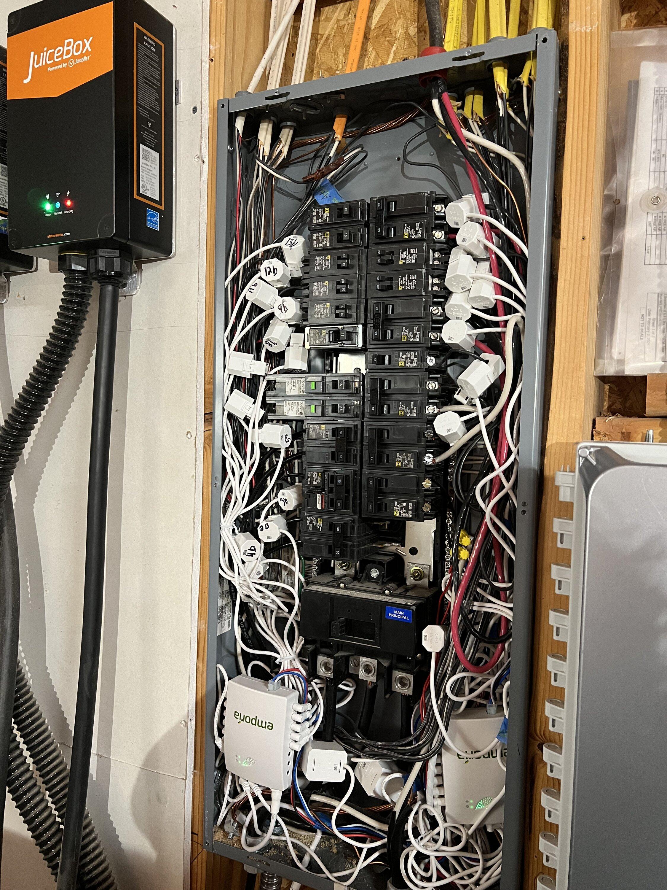

Thanks for the kind words - and funny you should mention that...
Ford F-150 Lightning Home Assistant - Ford F150 Lightning Dashboard. IMG_5324
We have two Vue2s running in our house, flashed with ESP32 and tying into Home Assistant. I've got a current clamp around the 100A feet to the FCSP for charging data, and I've also got a clamp around the backed for power cuts. SO far, so good ;)
Ford F-150 Lightning Home Assistant - Ford F150 Lightning Dashboard. IMG_5328.PNG
I'm actually working on a video right now that will be released on Transport Evolved on Christmas Day, in which I hope to go into some more depth over our setup!
