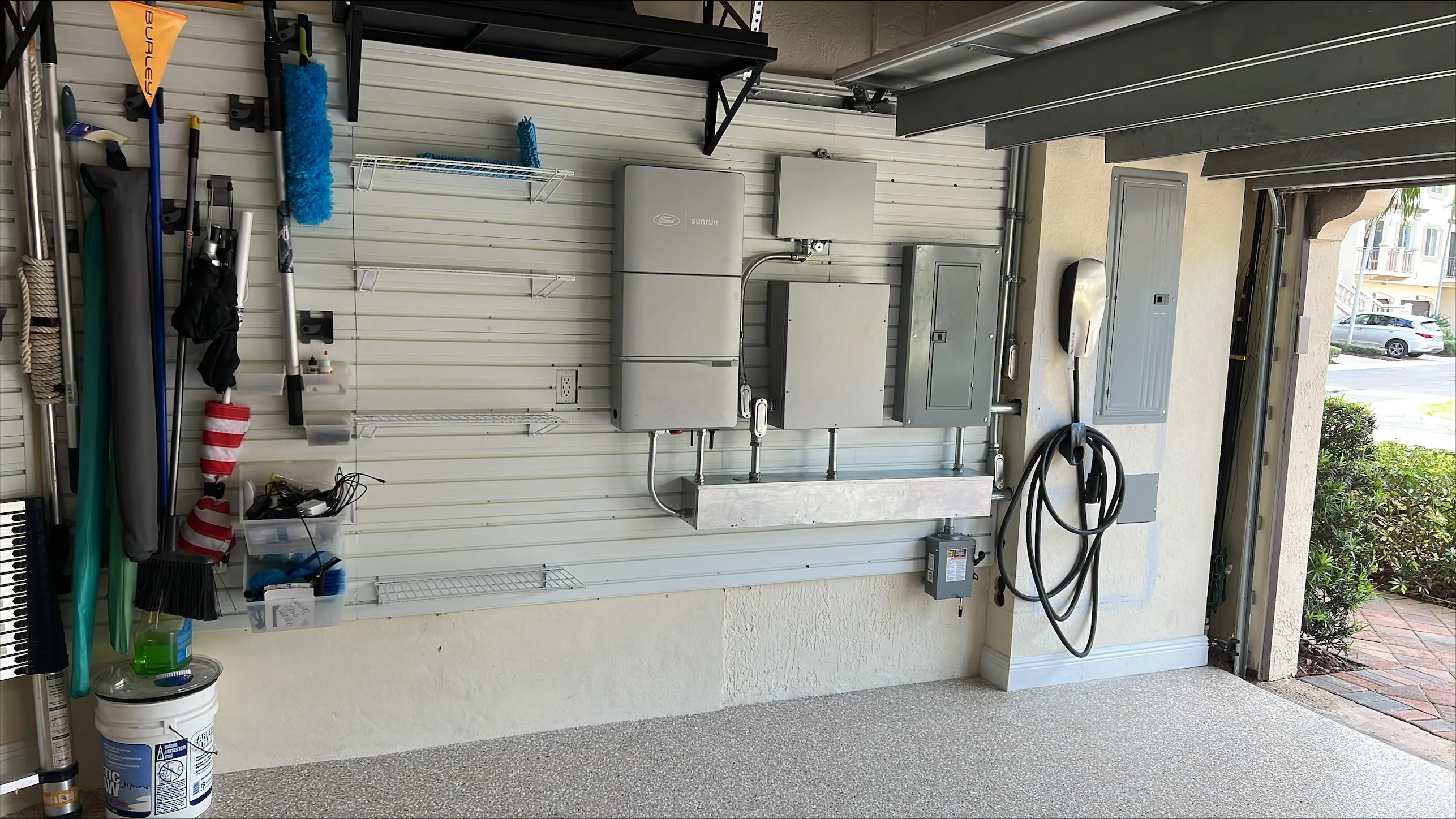

I hate to use the word disaster, but neither SunRun nor Ford has ANY idea how to make this process OR the technology work correctly. I despair having my home integration system ever work correctly. The only saving grace is that I haven't paid a dime so far for the two full weeks of onsite work that SunRun and its subcontractors have spent trying to install and get it operational, to no avail. Our house in Boynton Beach was 150 amps, and the design spec for the HIS installation called for 200 amps, which did require the local utility to be involved, shut down the power, upgrade the service. That was completed back in September. SunRun does not have a local team, so hired a Delray Beach electrical contractor team with limited English skills to do the HIS installation. They came in while I was out of the country, and despite instructions to the contrary, removed my existing Tesla high power (100-amp) wall charger, removed an entire wall of slatwall which I had instructed them to put the HIS modules on TOP of, and proceeded to completely bolux the installation, including installing the Ford charger at knee level - which I thought must be a joke, but they seemed to think was standard procedure. After a week of futzing around with no wire pulled through the conduit they'd installed between six illogically placed and widely spaced boxes/devices, SunRun had enough and pulled them off the job, eventually firing them. They are now suing me and SunRun for payment for their work and equipment, potentially tying my house up in mechanics liens.
Meanwhile SunRun sent a team of their own people from Orlando, 3 hours away, put them up in a hotel, and they tore everything out, started over. It was done correctly, but upon completion, did not work. It charges the truck, but will not provide power to the house for more than a minute before throwing a fault, no matter how big the draw. The team had to leave, has since come back for two more days, could not solve the problem. To make matters worse, the former subcontractor team had removed my Tesla charger against specific instructions, so the new SunRun team attempted to reinstall it, found that the prior electrician sub had damaged its internals. SunRun therefore purchased a brand new Tesla wall charger, a newer generation, and installed in my garage at their expense.
We now have a group of techs at Ford, SunRun, Siemens, and several others apparently pointing fingers at each other and attempting to figure out which and whose software isn't playing correctly. There's software in the HIS box, inside the Ford Pro Charger, and inside the truck, as well as in the phone app, all of which must work perfectly and in synch, with proper versions and firmware updates in order to function. No one seems to know what is the right version of each or what hurdles there are when something isn't working. As it stands right now, we cannot even get my iphone properly linked to or seeing the Pro Charger, and no one has a clue at any of the four involved software/hardware providers, and no one seems to have ownership of resolving the issues. Consensus seems to be that the truck is the problem and that major software development will be required to get this to work, if it will ever do so.
I keep asking this question - is there anyone, anywhere, that has a truck automatically switching over to generator mode when power goes out? The SunRun installation team says they have not yet seen a single installation work correctly and reliably to do this for more than a minute or two. So I'm not paying anything until it works and runs my house off the grid for a couple days, automatically switching over after we pull the main breaker - and it must do this more than once. I'm not holding my breath, am concluding that Ford sold an aspiration, not technology that they had already engineered and was operating - a great idea.
All those "we're saving the world" ads and news items about Lightnings running disaster-area homes, businesses, car dealerships in power outages, freezing weather, etc.? These situations are not EVER a Lightning using the Ford/SunRun bidirectional charging system. It is ALWAYS a person plugging extension cords into the Lightning's outlets to run stuff. Yes, my truck will do that, but this isn't what the $12,500 home integration system contract that I signed is all about.

I look forward to seeing your installation. I have sort of the same motivation. Our Virginia farm has a 42 kWh solar installation, produces excess power, sold to the grid. It is an oyster aquaculture farm, with about 14 million baby oysters, depending on time of year, dependent on continually pumped water through dock-based and floating upwellers. For backup we have a 55 kWh propane generator that is 16 years old. In today’s world I would install battery backup there instead, but it’s already working and despite about $2k of annual maintenance and repair, not worth ugrading until the engine wears out, which could be another 15 years or more.
However, our Florida house, an ICW-facing townhome in a gated community with lots of rules, cannot have a permanent automatic backup generator installation despite being end-of group. We already had Tesla wall chargers at both places, so I was able to charge the new Lightning using a TeslaTap adapter, so did not really need to do anything for the new truck.
FPL power is pretty reliable, and among the cheapest in the U.S., so battery backup and solar are hard to justify in Florida. For example, there is no time-of day shifting strategy. We’ve never had a significant outage in the ten-ish years with a winter home there. With that said, we travel nearly half the year, often overseas, keep motorcycles and bicycles in Europe and South America, will do so for at least another five years, so are at either place only a few months per year, and will park the Lightning in Florida for months at a time. I like the idea that it can “keep watch” and provide power when we are away in the event of an outage, run freezers, etc. We are almost never there during hurricane season, so that’s not a must-have, just a benefit, so we decided to get it done, almost for kicks. Having the installation issues is almost a sideshow, wastes some of my time, but isn’t mission-critical like it would be at our oyster farm, where we have internet-connected alarms notifying staff when a single pump goes offline.
When it is over and working, I plan to do a day-by-day expose’ on the disaster that the Ford/SunRun situation has been since last May when they first came to do a site review. Just this week I was notified that my SunRun project coordinator has been replaced by a new person who knows none of the history, so essentially starting over. They still don’t have proper permits, my house still sits under a Boynton Beach stop work order, and my system still will not operate bidirectionally. And I still haven’t paid anyone a penny for the system.
Ford is getting a ton of great press for the truck, perhaps deservedly so, and even specifically for its generator capabilities, but the HIS isn’t a thing yet from where I sit, and I’m about as easy an installation, a laid-back, patient customer for this as they could possibly have. I’m not yelling at anyone, happy to smile and say, “just get to it when you can, here is the gate entry code, the entry code to our garage, have at it whenever you want, just let me know when it works or if you need anything from me.” And they cannot make it work, full stop.
