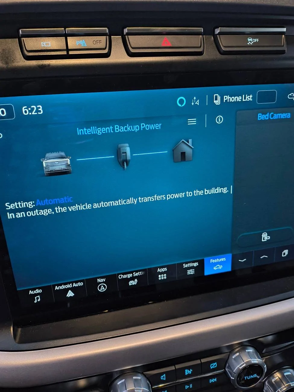

My theory is that the CSP is not applying OTAs properly without a forced reboot
From mid-December 2023 through 2/6/24, I didn't get any updates that I know of.
I still have the fall updates for my BDI inverter and my FCSP firmware:
Ford Charge Station Pro firmware update: 2.112.91...
mine now 2.112.91:2.149:1.32:1.53:0.62
Delta Inverter firmware update: 1.1.21
Mine (from M Prof app): BDI_SYS_01.01.21_PWR_01.06.08_ENS_01.06.01_D2D_01.01.05.bin
as described in this post: https://www.f150lightningforum.com/...backup-power-without-sunrun.12564/post-353483 from 12/6/23.
The first truck update I've received since PU 6.8 in mid-December was Priority Update-23-PU1113-UNX-DC [Connectivity], which was installed on 2/23/24.
The good news is that the truck successfully transferred power today on the first try, about one month after its last test on 2/6/24, which was also a success. Here's hoping things are on the right track now.

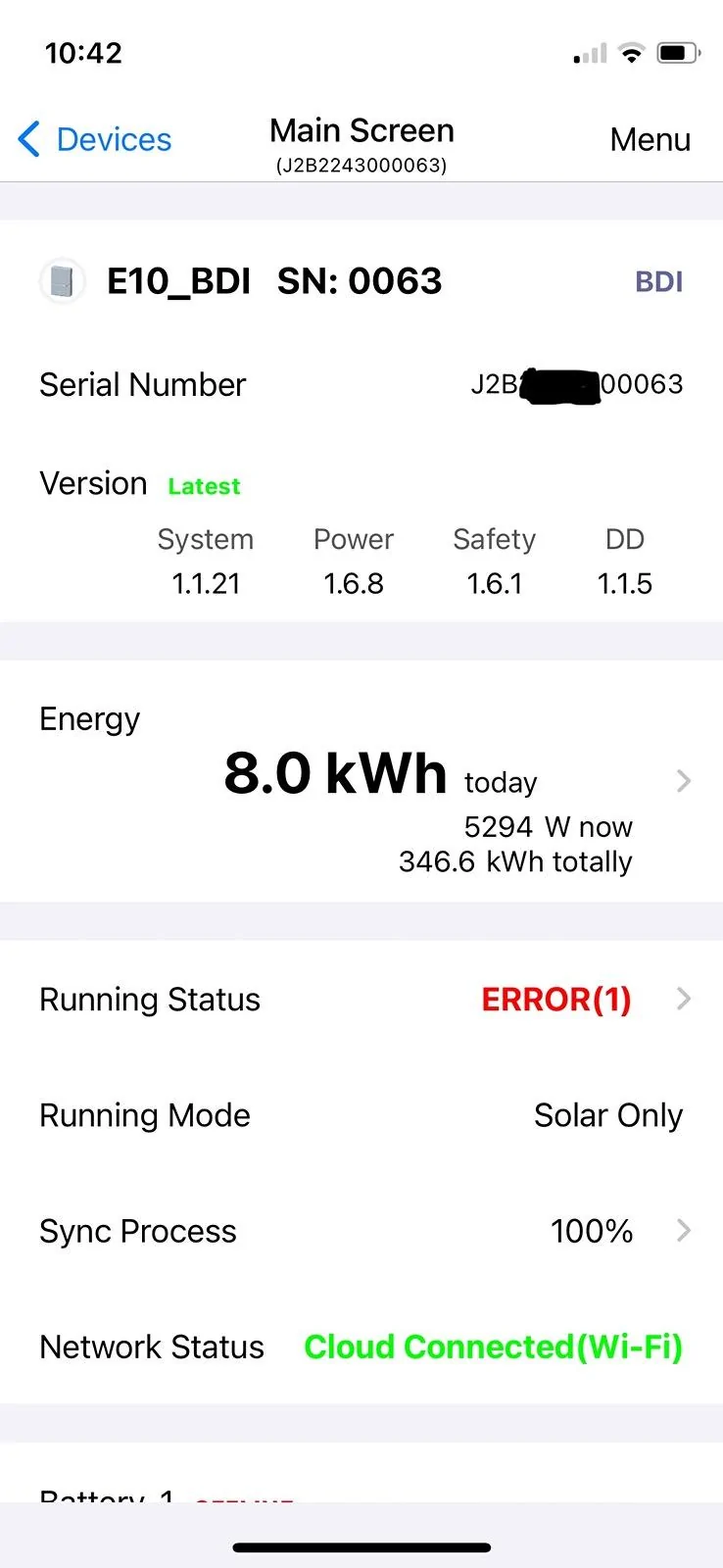

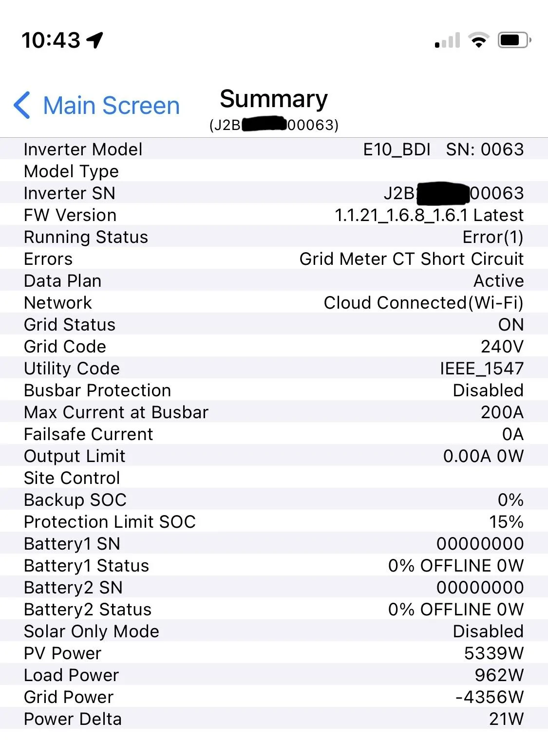

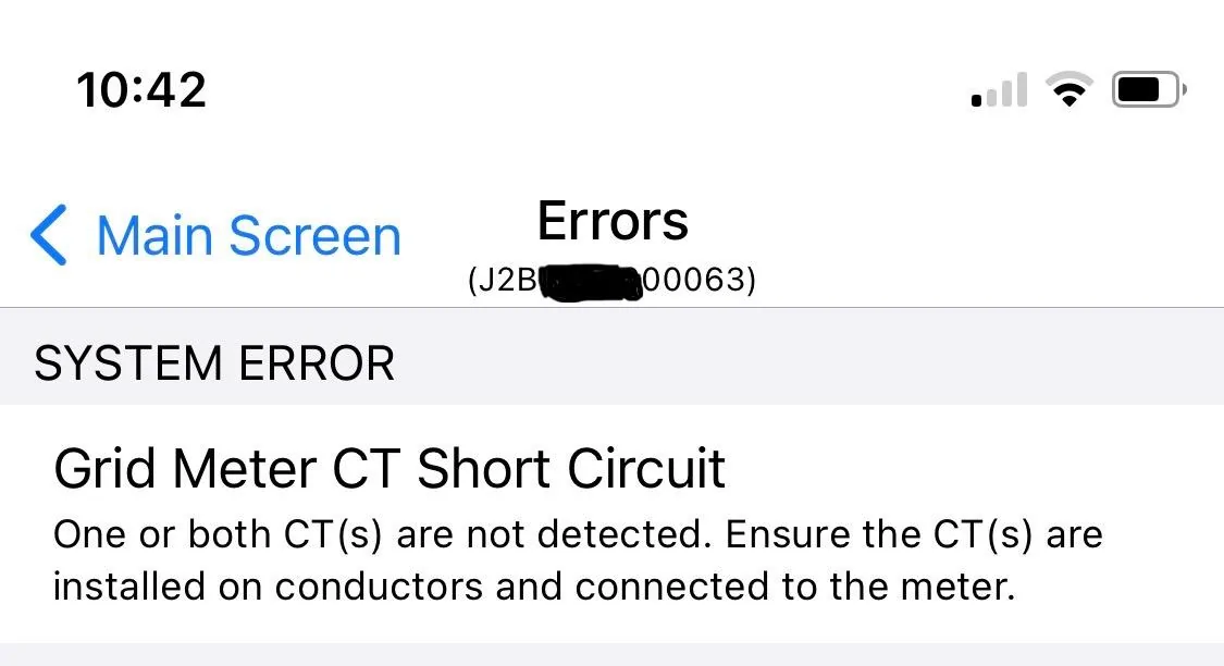

I have two questions regarding the CSP & HIS.
  1. Ever since the installation of my CSP and its subsequent replacement (due to an inoperable factory reset button) after all OTA software updates the current CSP has to be manually rebooted. Are any of you expecting the same or similar update issues?
  2. With regard to the Ford / Sunrun (Delta) bidirectional inverter I had installed on 3/1/23 to facilitate using the Home Integration System (HIS) in combination with my solar system and my 2022 F-150 Lightning I have been experiencing a peculiar failure. The M-Professional software that ultimately runs the bidirectional inverter indicates an “Error” usually 3 out of every 5 days. I’ll attach the screenshots that can best describe the issue. To that my question is once again have any of you had the same or similar issue, and if so have you resolved the reported “Error”?
I’ve posed the same questions to Ford, Sunrun, Delta and my electrician. To date none of them has solved either issue, or been able to direct me to a source that may be able to do so. Although my electrician and Sunrun have been here at my residence on multiple occasions to address complete HIS failure to provide backup power during grid outages, they have not seen the reported M-Professional error described here in person. I have however provided them with the same screenshots depicted here. Both my electrician and Sunrun’s technician have assured me that despite the reported M-Professional errors the “CT’s” are installed properly and at the time of their in person inspections no anomalies were detected.
So if any of you have particular authoritative knowledge in either of these areas of concern I, and probably many other CSP / HIS owners would appreciate your input.

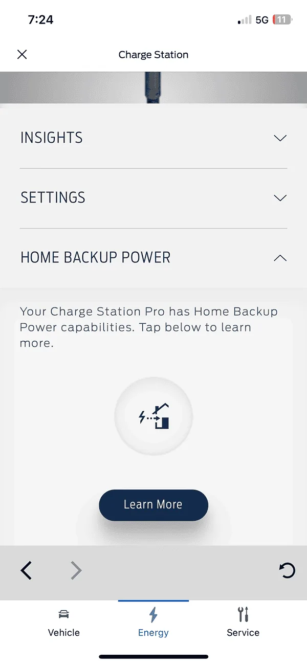

Edit: I did read through a lot of the early posts in this thread and assume it is basically the same issue as not having the green check mark on page 2 of the old Ford pass app...
Does the system need to be "turned on" externally by Ford? Even though I have paired the truck with the FCSP, and both app and truck showed it confirmed with a green check mark, in Ford Pass it doesn't show enabled like some others. It just says learn more. The in-truck HIS app shows that it is paired and shows status. When I turn off the breaker, the truck says preparing to backup, but does nothing (even parked with back passenger door a foot from FCSP).
Does anyone have a working system that is not showing as enabled in the Ford Pass app?
Does anyone know how or who gets this turned on? Does the phone number posted a while ago still work?

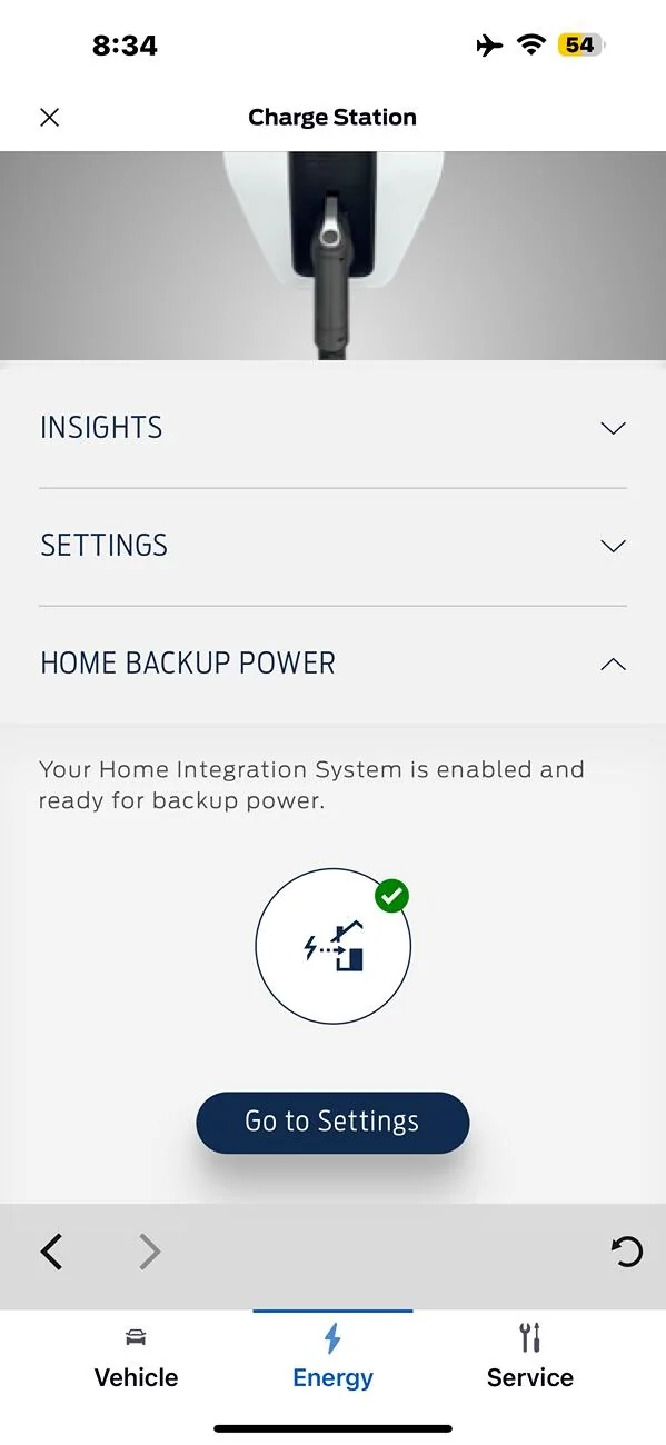

There is this series of posts earlier in the thread with a Ford phone number to call:
https://www.f150lightningforum.com/...backup-power-without-sunrun.12564/post-299655
My system was installed by Sunrun ~6/12/23. I seem to remember Sunrun saying it needed to be registered/activated, but that may have just been transferring the equipment/VIN information to Ford, as discussed in the post that I linked to above.
Even in the new iOS FordPass app v5.5, the green check mark shows up on the Energy tab under Charge Station, Home Backup Power:
Ford F-150 Lightning Installing a Home Integration System for Intelligent Backup Power (without SunRun) IMG_1054
With the removal of Home Backup Power controls from the FordPass app in v5.x, I don't know if the following Ford web page is still up-to-date, but here's what a search on Home Integration activation turns up:
https://www.ford.com/support/how-to...d-home-backup-power-on-my-charge-station-pro/

Do you have the phone number of who you contacted at Delta? IF so would you be able to send their information?
After installing the HIS system myself, I can pretty confidently say it is highly unlikely that any part of the Delta system is the issue, unless something was wired incorrectly. It looks like your system is working fine based on the solar going to the load as shown from M professional. Have you received the recent OTA's (6.14 or 24.2.5.6.2)? I am pretty sure one of those updates made my system start working.

Just for a reference data point, my system has began to work, and it is not registered with Ford at all. I don't have the green checkmark in the Ford pass app, nor do I see the HIS flash up on my energy.ford.com before going blank.
