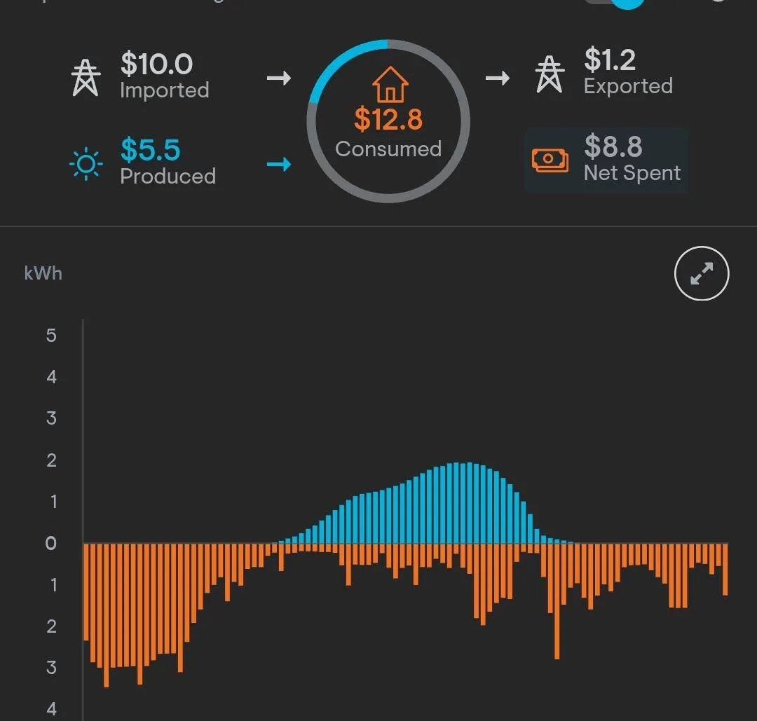

My house load, with literally everything on is not more than about 6-7K. I definitely make more than that at peak times. My solar array will generate upwards of 14K, but not quite what the charger will attempt to pull from the truck at full bore.
But as I mentioned before, the reason I got confused is b/c I can only read the meter and it's not in real time b/c it gives snapshots, and that's why at times I was seeing numbers that didn't make sense. . .
