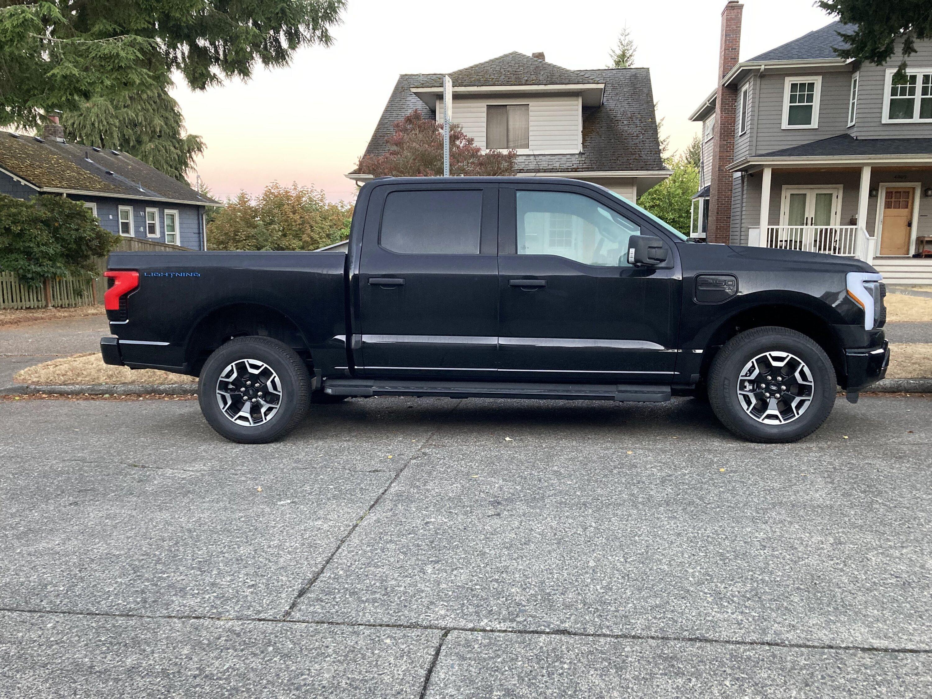

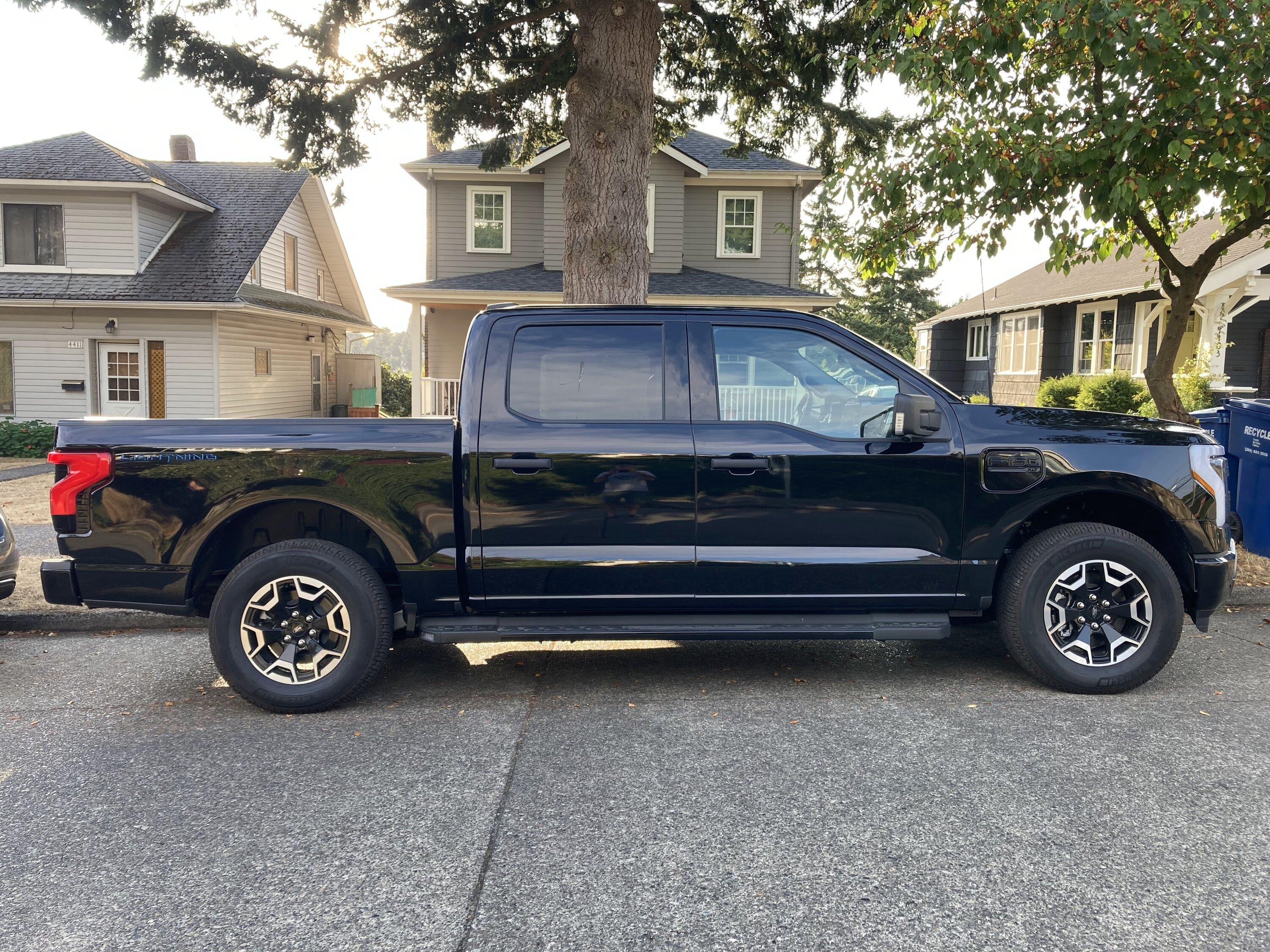

Ok - finally reporting on my experience. I had my local shop do this a few days ago and I have been testing it out since. Major findings:
  • Shop labor was 3.5 hours. About what I expected but I was surprised how much labor rates have risen in the last few years (used to be only lawyers could charge that rate!)
  • IMO, the ride is now decidedly more truck-like. I actually preferred the stock ride feel considering how bad the pavement is in my city - I really notice how bad the pavement is now.
  • Pictures don't do it justice- the look is vastly improved
  • I now fit into my 6'5" parking garage at work without worry
  • The truck looks really "long" now - probably due to the running boards. It's surprising how much difference this drop makes
  • My ideal look would probably be to drop the rear 2 inches (not 3) and raise the front 1 inch, but that would not have fixed my parking garage problem
  • There's still a small rake to the truck - but a good one instead of the ridiculous stock rake.
In all I am super happy.
Before:
Ford F-150 Lightning HOW TO DIY -- level / lower rear suspension on Ford Lightning using Belltech 25001 IMG_6525
After:
Ford F-150 Lightning HOW TO DIY -- level / lower rear suspension on Ford Lightning using Belltech 25001 IMG_6544

Glad you did it and glad you enjoyed it! Based on what you said though, it's not clear… Although the suspension (struts) are shortened 3 inches, the net result drop in the rear of the truck is *2 inches.* This is because of the geometry of the suspension. 2 inches of actual drop (3 inch suspension shortening) is a perfect level on this truck.
if you did this rear level and then raised the front, it would look like a Carolina squat and in my opinion, stupid. Also illegal :)
Yeah - I would not want the squat for sure. I agree that the rear is now about 2 inches lower. I was looking to reduce the overall height of the truck by at least 1 inch, which I achieved. I think the truck might look better if the overall height was a little taller than my currently modified setup - about 1 inch more both rear and front but not changing the current rake of the profile. Again, would not work for my parking garage situation

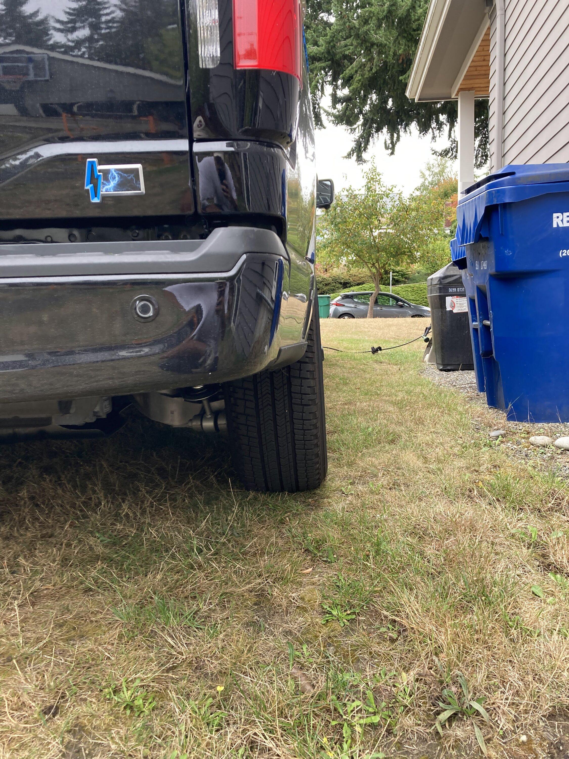

2) The negative camber is unacceptable. Mine was 2.5-3 degrees after leveling. There's no way to adjust it on Lightnings without frame modification. You have to remember that this suspension travels on an arc. The more the suspension is shortened, the more the control arm rotates around its axis and forward in the wheel well, and creates negative camber. It rode worse, was louder, and my efficiency took a hit by not riding on the tires square.
This. I've been surpised by the negative camber and tried to photograph it. I am likely to add the spacers as suggested by the OP and will report back afterwards:
Photo of negative camber after 3" strut shortening:
Ford F-150 Lightning HOW TO DIY -- level / lower rear suspension on Ford Lightning using Belltech 25001 IMG_6572

Pretty sure Ford did this to stabilize loads around corners. The control arm is set up to create more camber the more it's compressed. 1" drop keeps camber in check and looks/drives much better.
ICON has a camber Kit shipping in November but requires permanent frame modification. I'd be willing to do that ifdrop it all the away around with the full kit.
Another good thing about the 1" drop/1.5" strut shortening is that now the rear axles are perfectly straight, minimizing any possible wear and tear on the CV axles. Stock, they are cant down several degrees.
