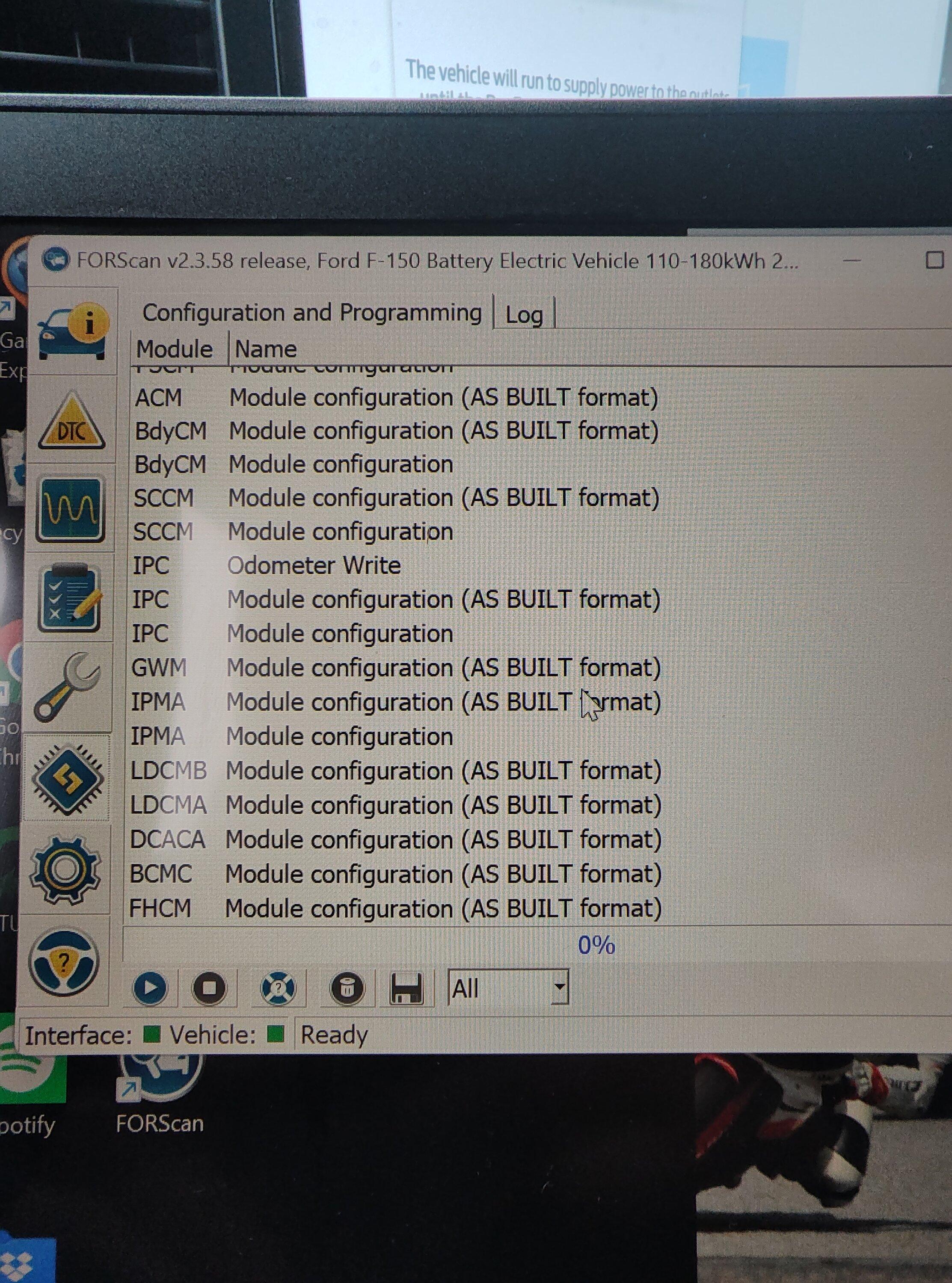

@shoopg and @KurtsRPMGarage , I don't see the module firmware update option listed in forscan. Am I not on the right screen or wrong version of forscan?
Looks like an older version of forscan. I had version 2.4.10 when I did it. See if you can update it. Should appear after that.

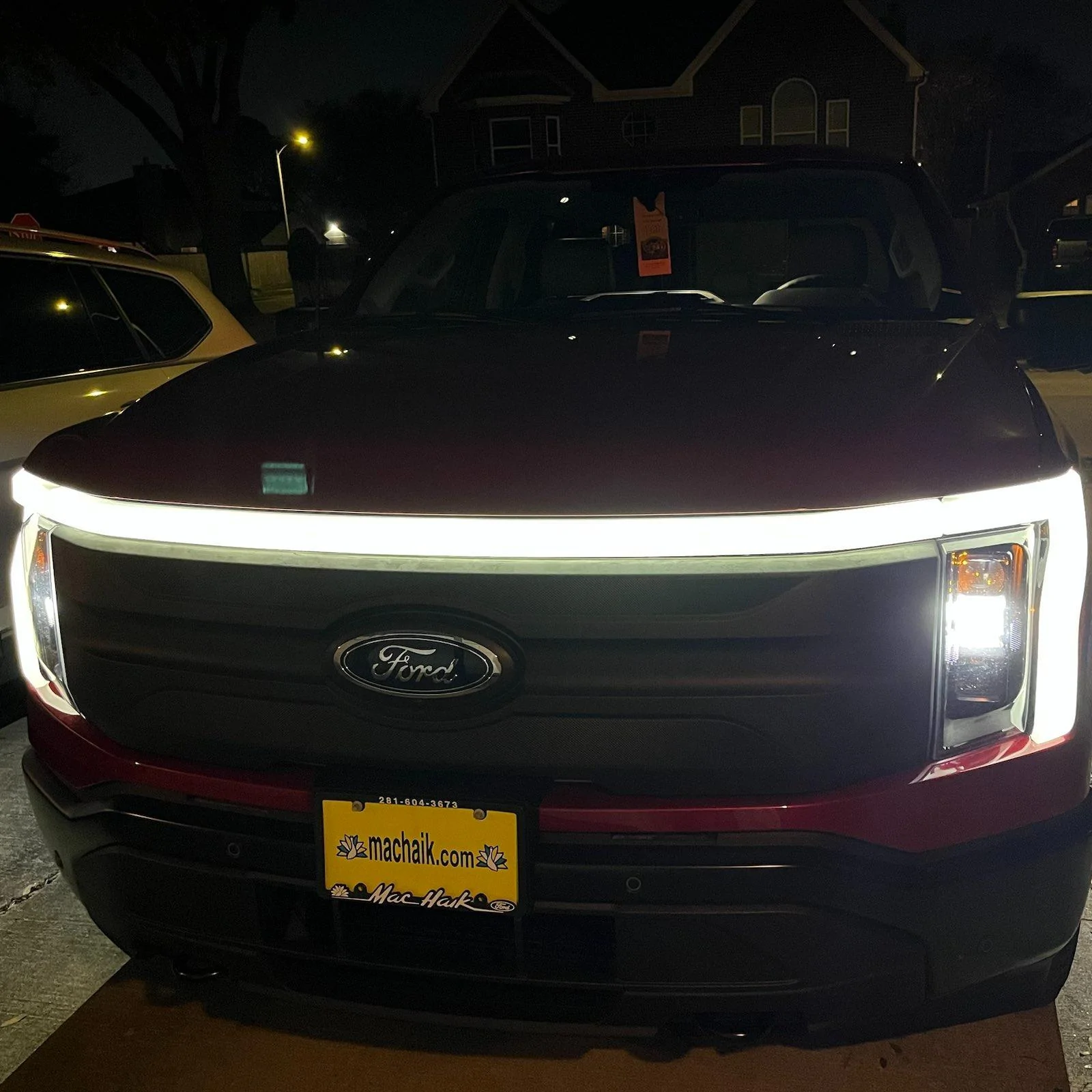

Finally! With the help of both @Livnitup and @Jesse-Infotainment we figured out why the light bars don't immediately light up when plugging them into a truck that isn't equipped with the light bar from the factory. As far as I can tell, every truck should be prewired, but its very possible that extreme base model Pros without any options might not be prewired. If you're worried about this, take a multimeter and probe the pins in the connector for voltage and ground. (There's a diagram further down in the post)
Shoutout to the thread by @KurtsRPMGarage - I learned a lot of things that set me on the right path to figuring this out.

Now on to the actual programming. If you suspect you have a low 12 volt battery, it may be worth your time to connect the truck to a 12v battery charger. If voltage goes too low during programming you risk bricking the modules. These modules don't take long at all to program but don't say I didn't warn you. Make sure you have the files I've linked above downloaded and extracted somewhere on your computer. Using Forscan, jump into the module firmware update section, and start with LDCMA. The screen will look like this. Switch the "Available" box over to custom, and using the boxes with the 3 dots, select the firmware file, one at a time corresponding to the correct number. Forscan should only show you compatible files, but I would double check everything. Once you have 3 green boxes hit the program button.

Now sit back and admire your work!
