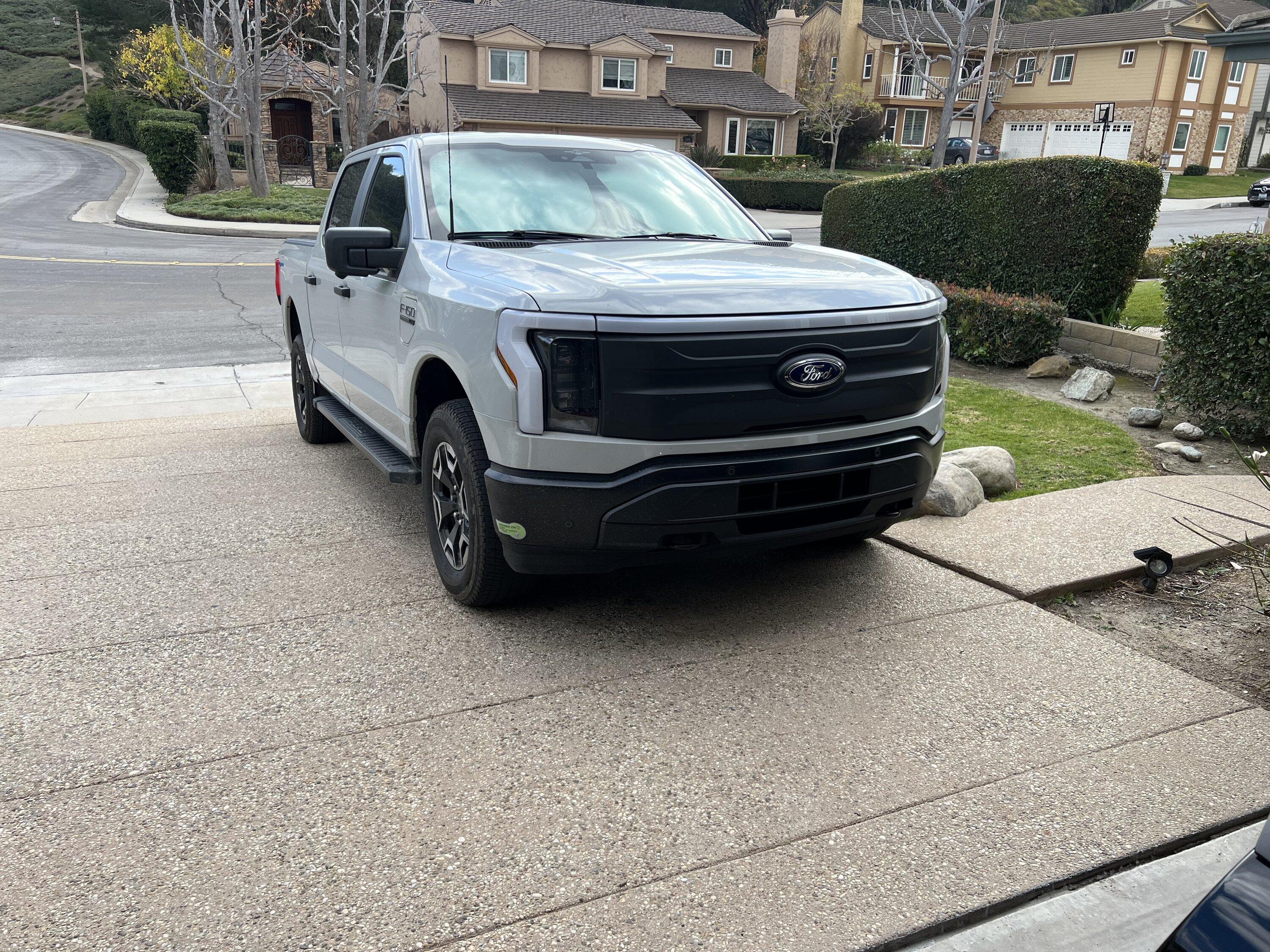

Ford F-150 Lightning How To: Front Light Bar on Lightning Pro IMG_4513
Got everything buttoned up on my end. Looks great on avalanche gray. I’ll post my install video this evening.
Issues I ran into. Programming the LDCMA and LDCMB kept failing. I got the LDCMA to work after I unplugged the level 2 charger from the charge port. Then I got the LDCMB to work after I cleared any existing DTC codes. After that everything worked great.
Thanks again Shoopg.
Good to know! I'll add this in the main post. The Ford workshop manual for programming says to make sure the truck is unplugged from the EVSE so it seems like there's a good reason for it.
Truck looks great!

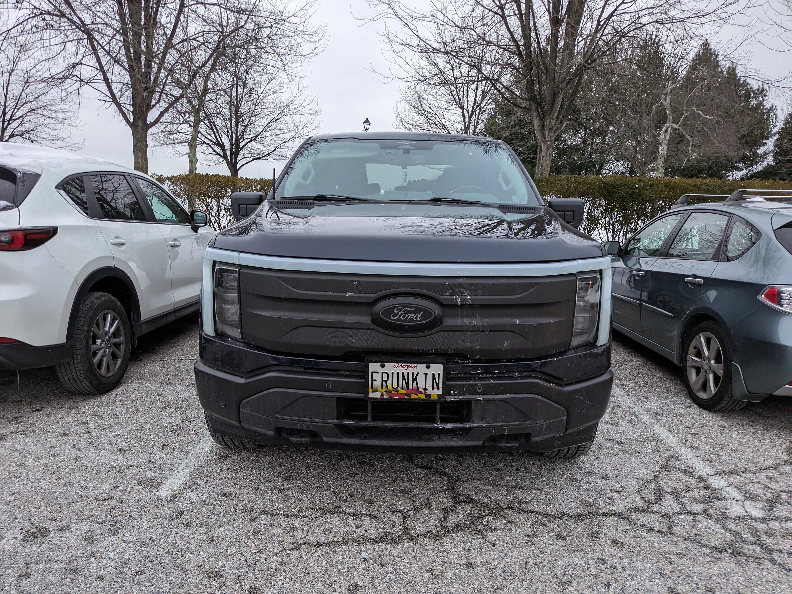

I had actually bought a lariat grill on ebay because I didnt want to bother cutting the old grill and thought it might look better, but looking at pics of lariats and pro's side by side, i noticed that the trim below the grill is the same color as the grill, so it might look weird to mix and match those. So I just ended up cutting my old grill and will resell the lariat grill.
