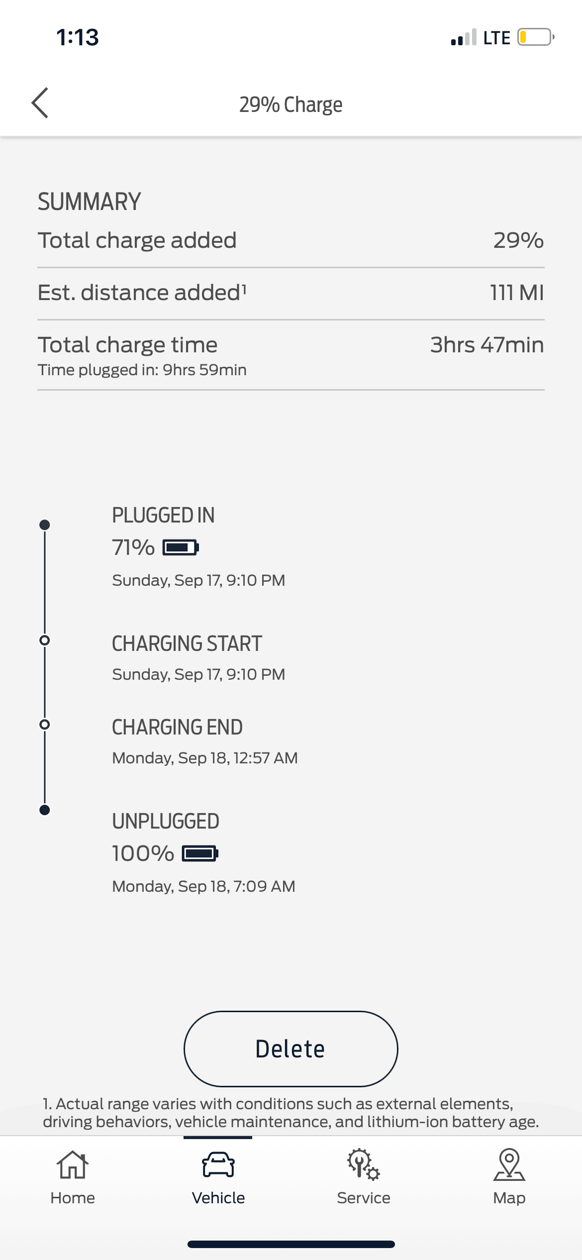

One other thing I realized today, if he’s calculating backwards from the app, it’s not going to be accurate. This is assuming the android functions the same way.
On mine, I get 16-17kW even at 92-93% SOC.
Last night I finished charging somewhere between 1-2am, only needed about 42kWh. I actively charged for less than 3 hours to get to my limit, but it remained on the charger until I left this morning. Yet my app shows I’ve been “charging” for over 10 hours, while simultaneously saying charging is complete.
I don’t think I ever realized it, but that means the app considers it still “charging” as long as it stays plugged in. I wonder if that is what the OP is experiencing. Everything is working as intended, it’s the assumption that’s wrong.
The FCSP is more precise about when the vehicle is charging.
It separates the charging time from the plugged in time.
I known nothing about other EVSE & App's
Oh you're right. If I go into my charge log, it'll show that same thing with the Tesla Wall Charger as well - along with various other L2s. Distinctly separating the amount of actual charging time and the time it was unplugged.
I usually just click the details button in the blue section on the Home Screen, and it'll only show "Time on Charger" instead of "Total Charge Time". Odd that they do it differently on two different screens.
