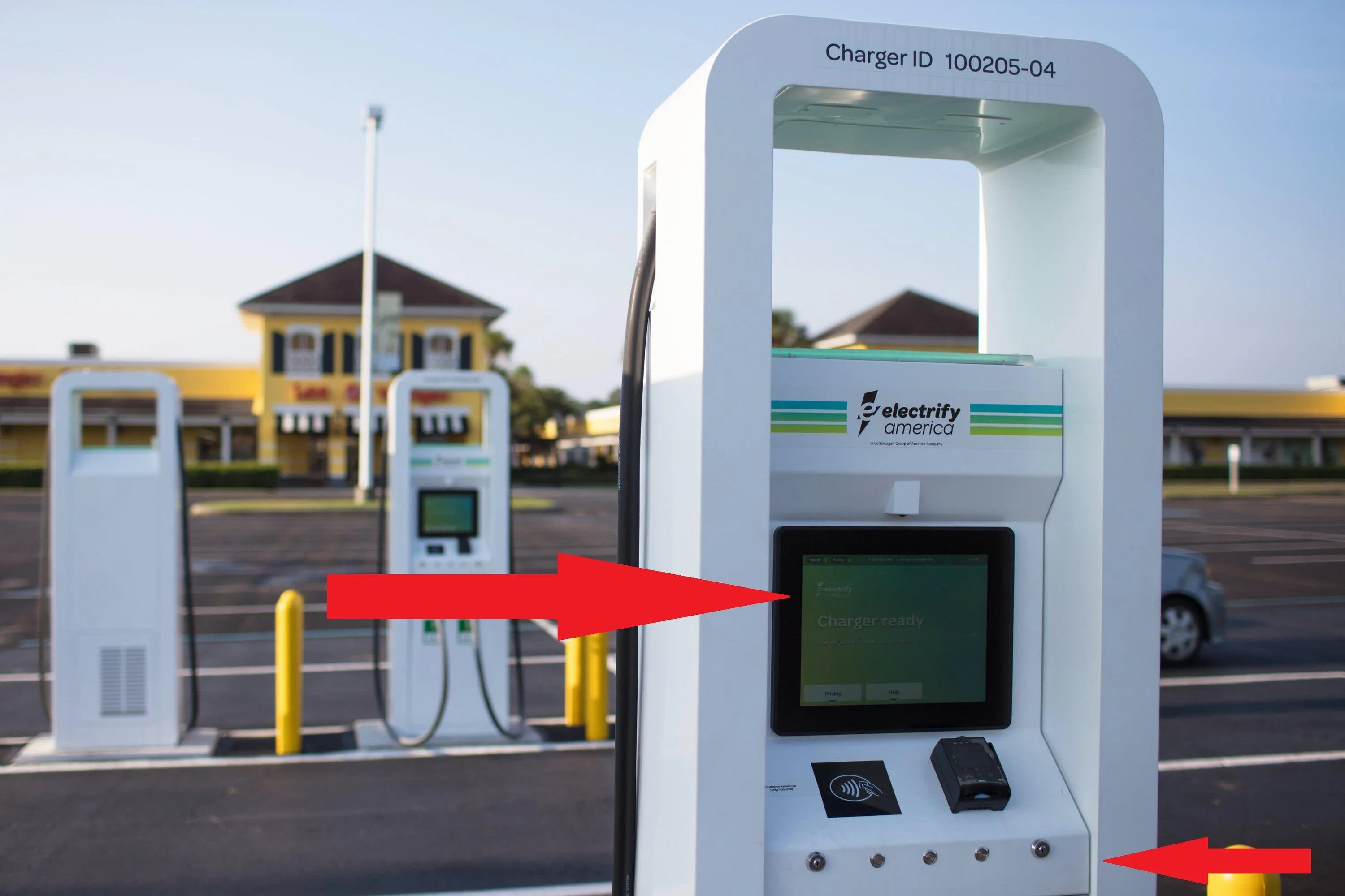

No, you stop charging on the vehicle by pushing the button - not on the pedestal.
Yes, the pedestal does have a button to stop charging... And it has a screen and it has buttons...

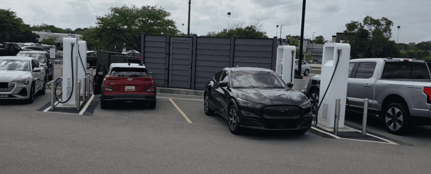

Also many DCFC stations are side access. take a look at picture below. Just imagine the cable strain if it was in front.
The Lighting has it in the only correct place IMO. I wish all companies put it there. In fact one of the reasons the ID-4 was crossed of my list is because it is in the rear, like my I3 which is pain in butt to charge.
