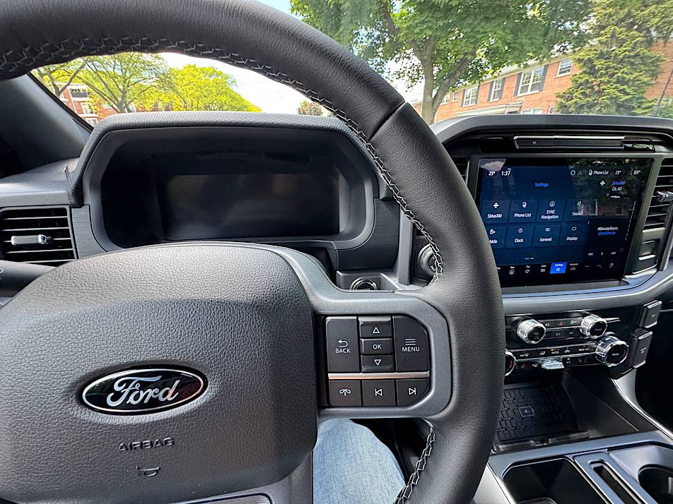

Glad I found this thread. I don't have a Lighting but just got a 2025 F150 Powerboost on Fri (5/23). Not literally 24 hrs later and at roughly 50 miles (TOTAL miles... truck is BRAND NEW off the dealer lot)... Black instrument panel. I was livid!!
Did some searches and most everything pointed me here. I had tried disconnecting the 12V battery for an hour+. Didn't do anything. Switching fobs. Nothing. Driving a bunch with it blank hoping maybe there was some other battery that had been drained low from maybe sitting. Didn't help.
When I first saw "Fuse 13" I thought that was a Lightning specific fuse. As the regular/powerboost F150 owners manual shows fuse 33 as being for the instrument panel. Pulled that and reinstalled (fuse was good btw). Nothing. Fuse 13 is labeled something like "steering column module" in the manual.

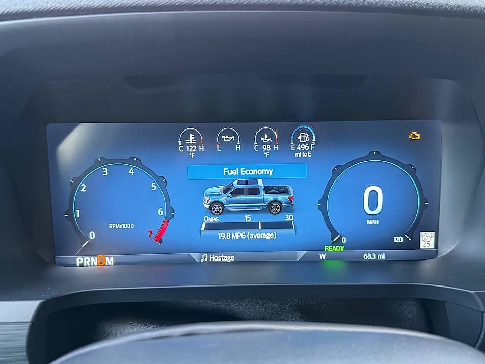

I was about to give up and drop off at dealer and tell them take it back, I have buyers remorse and it's already defective after less than 24 hrs of driving off. So with nothing to lose as it's the long weekend and dealer is closed anyway I gave fuse 13 a shot. Pulled it out... then upon reinstalling... ding ding ding - the door chime ran. Then to my joy the instrument panel came back to life!
I can at least avoid an immediate dealer trip Tuesday morning. However, to say I'm not disappointed would be lying. This didn't happen at 50,000 miles... not 5,000 miles... not ever 500 miles... 50 MILES!!!!!! Not to mention how much of a pain in the ass it is to get to the fuse box. What a stupid location. Already broke some clips and there was a bit of trim already broken there when I first took the trim pieces off... so seems to me this may have occurred also before delivery and someone knew exactly what to do. Shame on Ford for such a chronic problem (judging by all the posts here) without a permanent fix!!
Oh no check engine light is on because it think my fuel gauge was stuck and that I should "bring in for service". Hopefully goes away or I'll connect Forscan to clear it.
