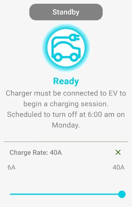

It locks very nice. It looks like it does not have physical switches to set the max amp (using WiFI through the app). I couldn’t figure out if you lose power in middle of a night while charging and it comes back, what happens. Does it go to a higher default amp rate or remembers the settings somehow.. I probably will set mine up at 24 amp and I understand you can’t set the limit in Pro and it will always try to pull 32 Amp.
3,734
6,775

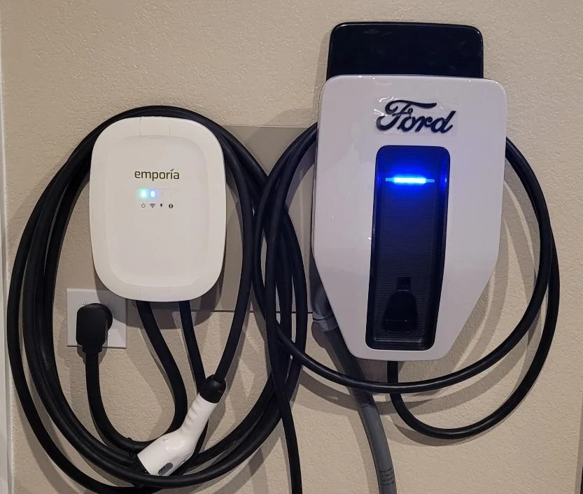

You set it up in the app. It will remember your max charge rate if you cycle power to it. Mine has a max of 40A because I moved it back to the 14-50 outlet after I installed my FCSP.

I was looking at Grizzle-e because I have to have mine outside but this looks like it is outdoor friendly with more features. If it has a good memory, it is hard to beat with the features it has.
I can't attest to the outdoor worthiness of it, since I have it installed in a garage. But they do say it is outdoor rated.
https://shop.emporiaenergy.com/products/smart-home-ev-charger-ul-listed?variant=42667854004479
Here it is on their website. Use the code 5%offmycart and you'll save ~$20 on it. They ship fast.
