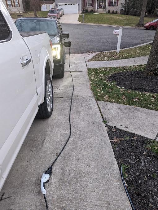

Instead of using an extension cord you can use this J1772 extension. It is waterproof, maintains 32 amps of current with no loss, and can easily be removed and placed in the frunk.
https://www.bestbuy.com/site/rexing...-cable-32a-17ft-black/6543370.p?skuId=6543370
Ford F-150 Lightning Extension cord for Ford Mobile Power Cord PXL_20240202_223350146
