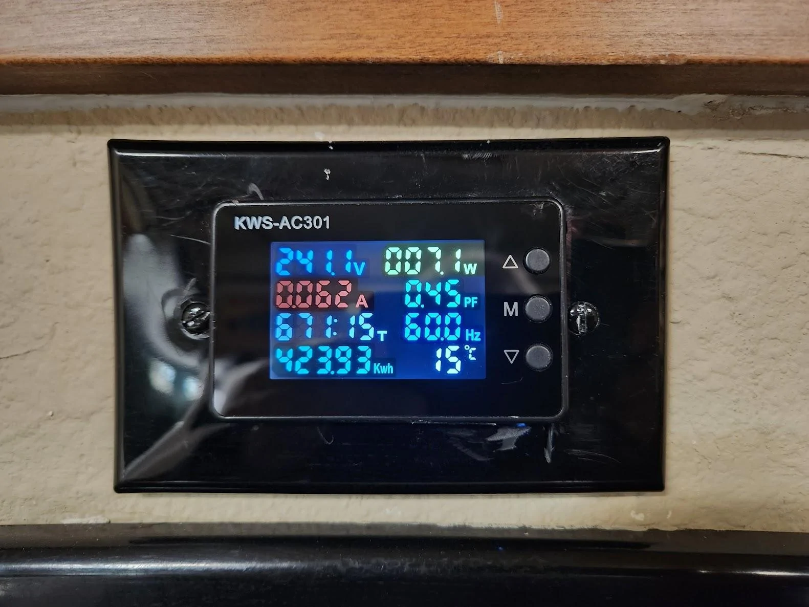

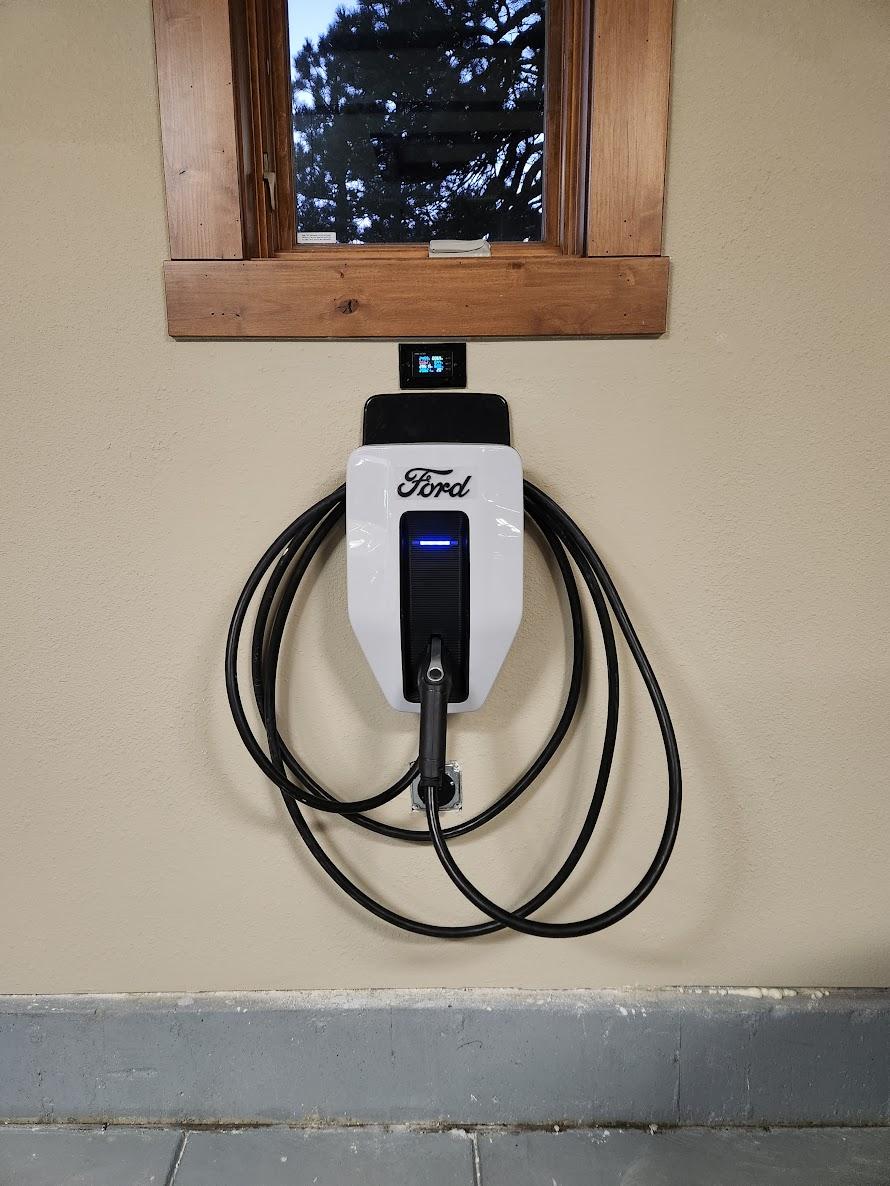

I have a 12 KW grid-tied solar array, and was curious when I installed my FCSP how much power I would be using to charge my F150L. The KWS-AC301 multimeter, available on Ebay for $15, gives a readout of a variety of parameters including cumulative KwH, and retains this value even when powered off.
Installation consists of two wires piggy-backed on the 240V connection ( A(L1) and B(N) ) to power the meter and an inductive coil to measure current placed around either of the 240V lines and connected via its two leads to the back of the meter. I cut a rectangular hole in a black blank outlet plate and mounted it to an old-work one gang electrical box mounted above the FCSP.

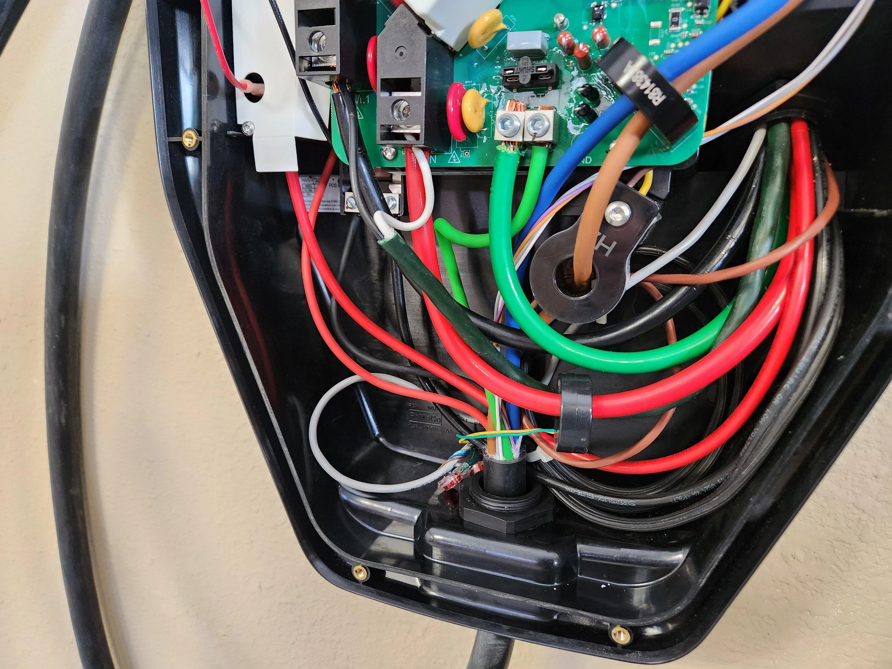

In the last photo, you can see the circular inductive coil placed around the red 240V lead, and its short green and yellow leads connected to a grey cable which runs to the meter. The dark green cable to power the meter enters with the 240V leads, and its black and white conductors piggy-back on the 240V leads.

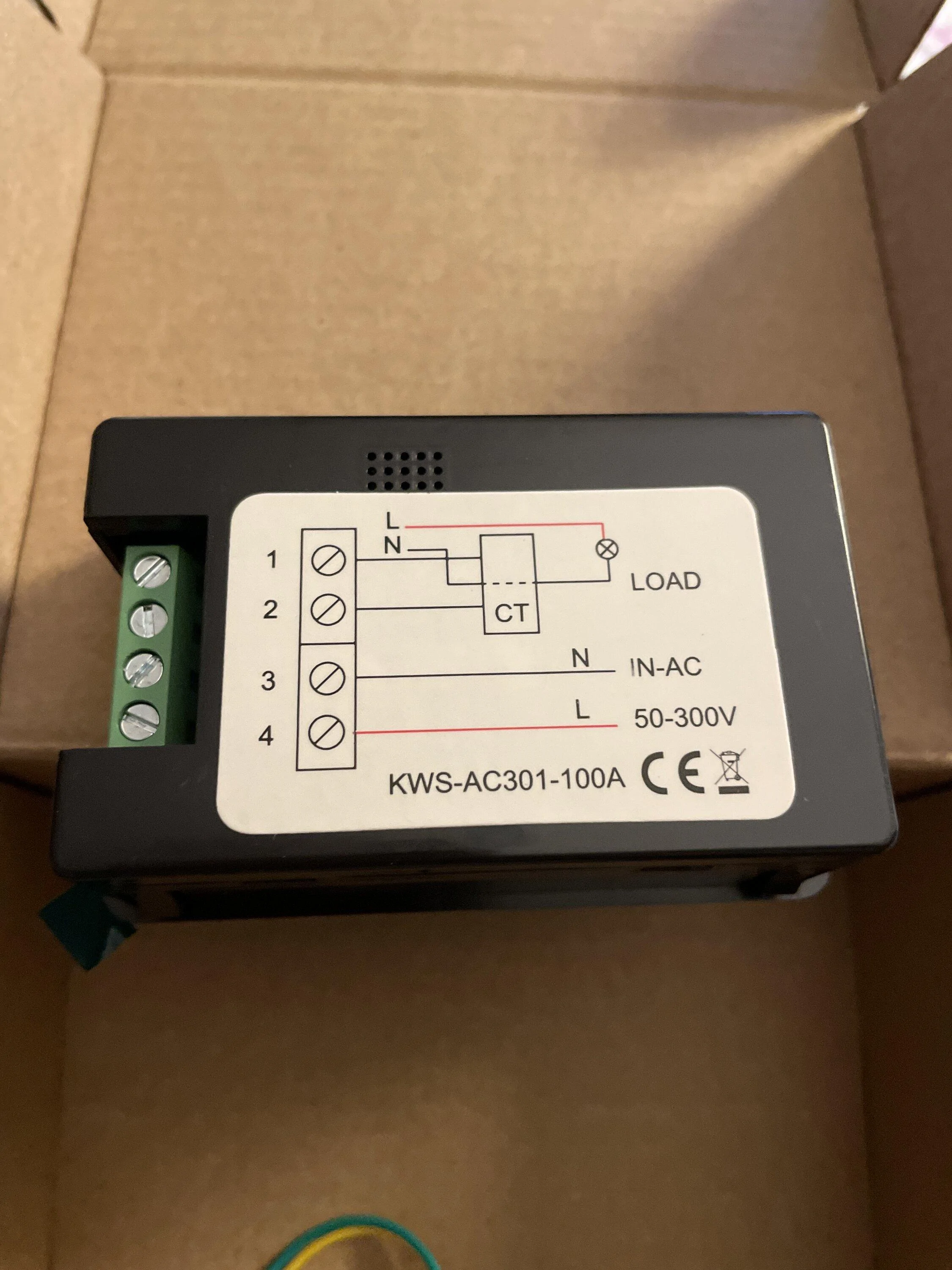

I just received my Monitor today and was looking for guidance on the wiring.
Just want to be sure and get it right the first time.
Here’s a shot of the connection diagrams and was hoping you might list your wire connections as they relate to the post numbers?

Terminals 1 and 2 connect to the round black inductor (current transformer), which is placed around either of the 240V leads (either A(L1) or B(N)) connecting your FCSP to your electrical panel (thick black and red wires in my picture above). The inductor senses the magnetic field generated by current flowing through the 240V lines running from your panel to your FCSP. Don't place the inductor around the ground wire from your panel. The leads from the inductor are very short so you will need to extend these with any small gauge wire you might have. CAT5 cable would work fine.
Terminals 3 and 4 connect to A(L1) and B(N) -- it doesn't matter which lead goes to which connection. These supply 240V power to the meter. I used a piece of 16 gauge extension cord to make this connection.
Please be sure to turn off power to your FCSP before opening it up. Good luck and let me know if you have any other question.
