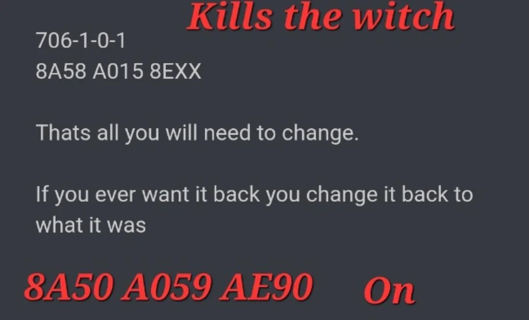

Polarized prescription sunglasses. Early on, with the Powerboost's original Bluecruise eye-scanning code, was quite frustrating. Enough so that I Forscan-disabled the "wicked witch".
But with the recent BC related updates that included CMR code, I turned her back on so that I could see for myself if Ford's claims had merit.
For my particular sunglasses, the reduction in nagging has diminished considerably in the truck. And with the recent acquisition of the Mach-E and it being already equipped with more mature software? I can't complain, to be honest.
Maui Jims, I think they are. With some kind of gold coating. I honestly don't know why they are so compatible, but I bet someone who understands the science could explain.
One thing for sure is that not all lens set off alerts equally. And Ford's updates are tweaking the CMR.
Could you expand on the Forscan change you made? I haven't seen the mod you are referring to.
