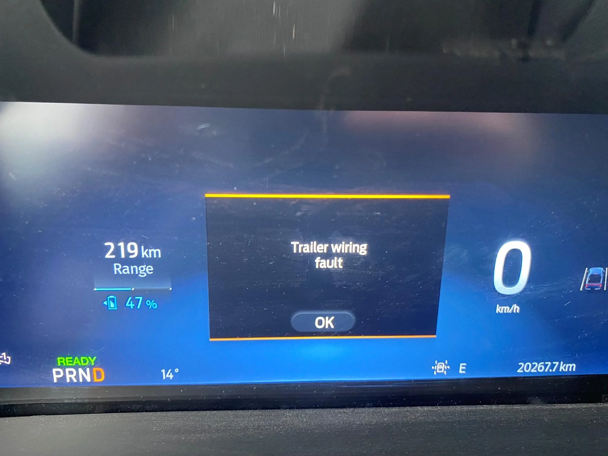

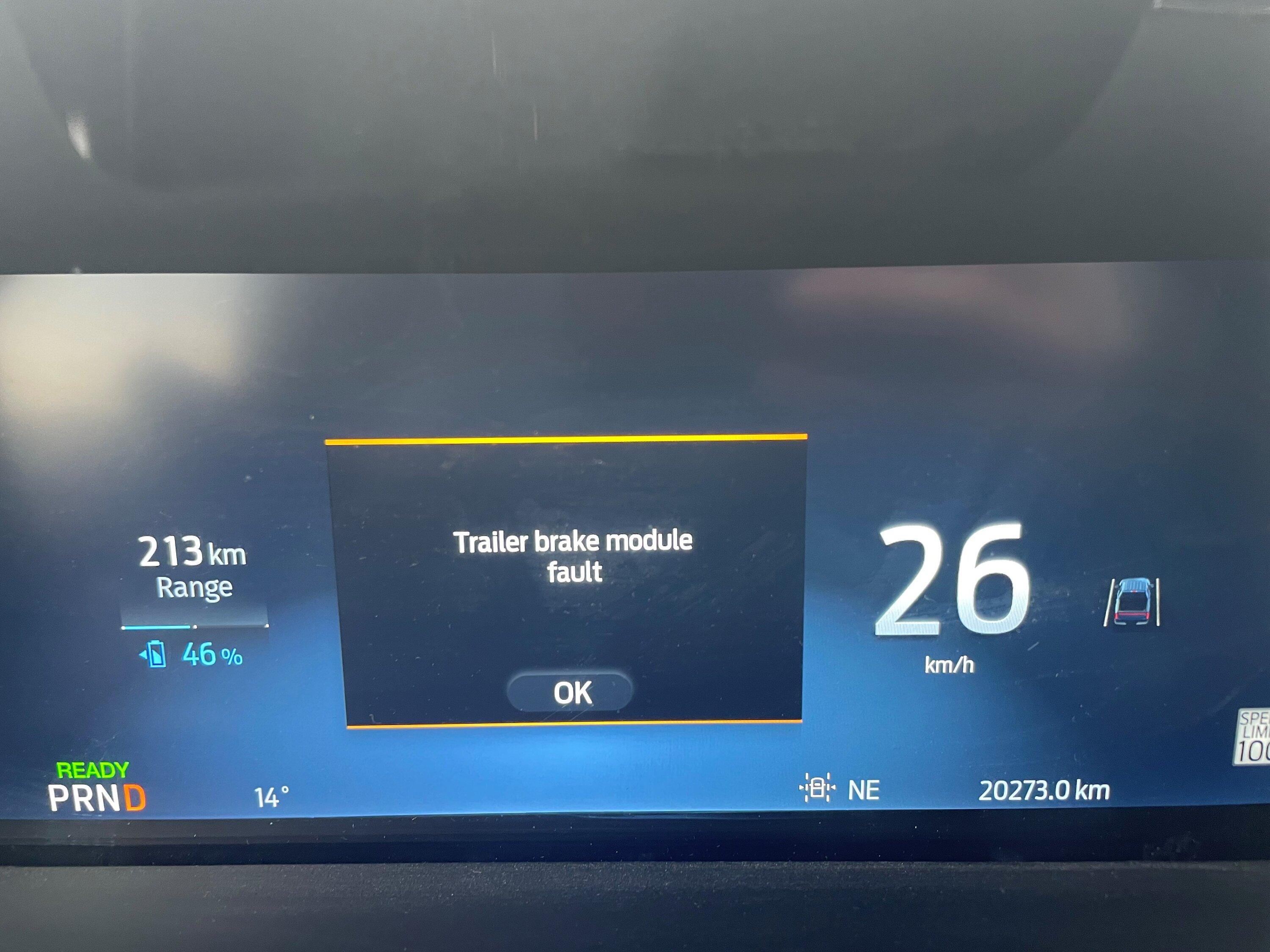

I finally took my truck to the dealer to try and program the trailer brake module after having trouble doing it myself in FORSCAN.... but they could not get it to work and now I have two faults pop up every time I start my truck. "Trailer brake module fault" and "Trailer wiring fault". I'm very disappointed.

But you are still using the original module that came with the truck right? And only added in the switch/gain controller to see if it would work? (Hoping that it would work) I wonder if that original module in trucks that shipped without trailer brakes only looks like a trailer brake controller and is more of a pass-thru solution in case you want to swap it out for a real one down the road.
Fwiw, I was able to purchase the "Trailer Brake Module" for my vehicle from https://parts.ford.com/shop/en/us/trailer-brake-module-14951227-1?pdp=y (Part #: ML3Z19H332AB). It is now installed and I had no issues enabling it with Forscan. This includes both the black controller box and the gain switch.
No startup issues, and it works as expected. It seems that part goes in and out of stock during the week. My suggestion is watch it... and then perhaps you can buy a module that would just work for you.

Or, another option would be to just remove the custom gain switch. Reset the Forscan settings you made and then I bet those errors go away.
And then just go with the Curt echo 3rd party brake controller. I don't think you are stuck here. Just have found out that mix/matching parts won't work for this.

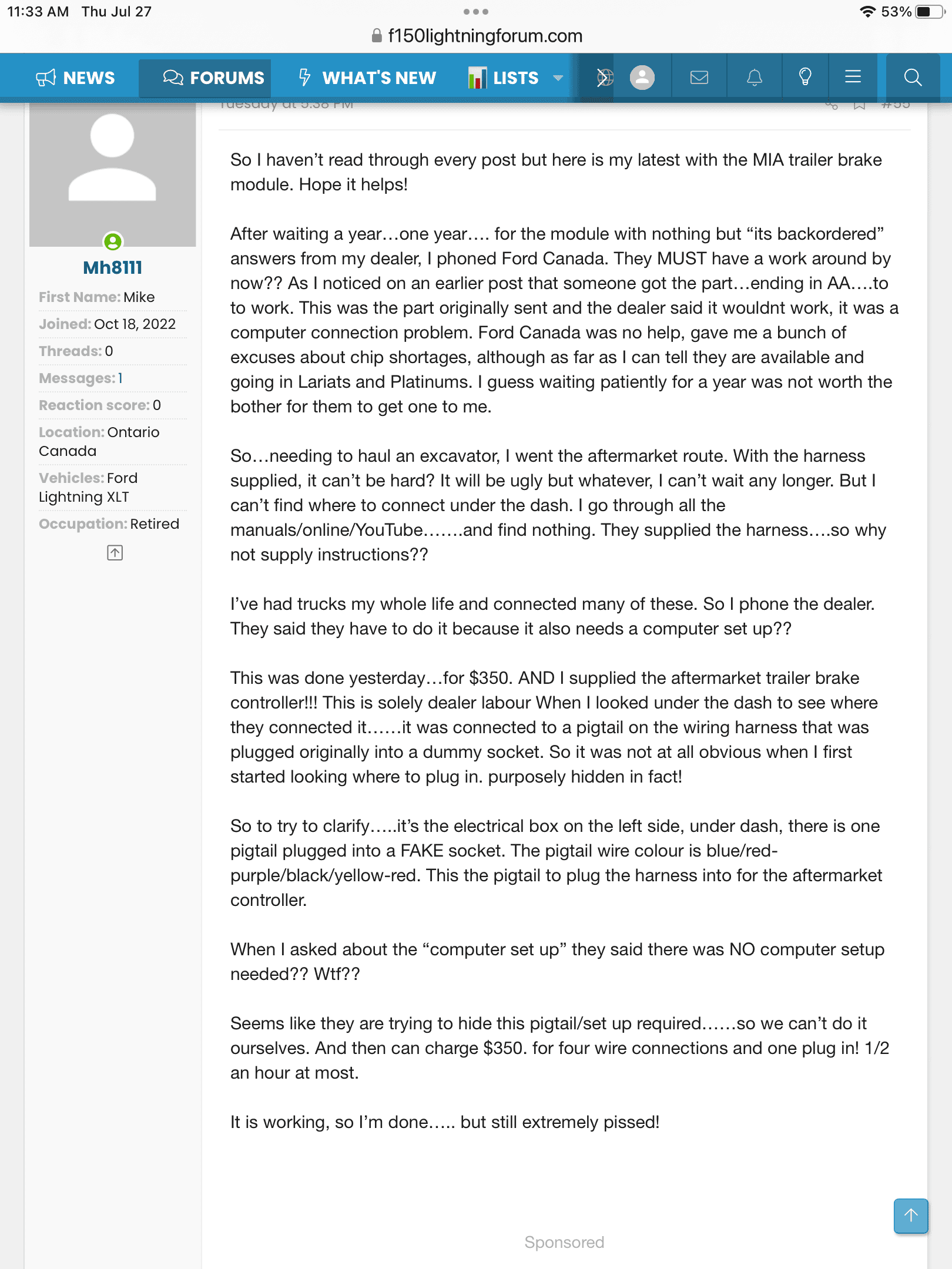

So I haven’t read through every post but here is my latest with the MIA trailer brake module. Hope it helps!
After waiting a year…one year…. for the module with nothing but “its backordered” answers from my dealer, I phoned Ford Canada. They MUST have a work around by now?? As I noticed on an earlier post that someone got the part…ending in AA….to to work. This was the part originally sent and the dealer said it wouldnt work, it was a computer connection problem. Ford Canada was no help, gave me a bunch of excuses about chip shortages, although as far as I can tell they are available and going in Lariats and Platinums. I guess waiting patiently for a year was not worth the bother for them to get one to me.
So…needing to haul an excavator, I went the aftermarket route. With the harness supplied, it can’t be hard? It will be ugly but whatever, I can’t wait any longer. But I can’t find where to connect under the dash. I go through all the manuals/online/YouTube…….and find nothing. They supplied the harness….so why not supply instructions??
I’ve had trucks my whole life and connected many of these. So I phone the dealer. They said they have to do it because it also needs a computer set up??
This was done yesterday…for $350. AND I supplied the aftermarket trailer brake controller!!! This is solely dealer labour When I looked under the dash to see where they connected it……it was connected to a pigtail on the wiring harness that was plugged originally into a dummy socket. So it was not at all obvious when I first started looking where to plug in. purposely hidden in fact!
So to try to clarify…..it’s the electrical box on the left side, under dash, there is one pigtail plugged into a FAKE socket. The pigtail wire colour is blue/red-purple/black/yellow-red. This the pigtail to plug the harness into for the aftermarket controller.
When I asked about the “computer set up” they said there was NO computer setup needed?? Wtf??
Seems like they are trying to hide this pigtail/set up required……so we can’t do it ourselves. And then can charge $350. for four wire connections and one plug in! 1/2 an hour at most.
It is working, so I’m done….. but still extremely pissed!

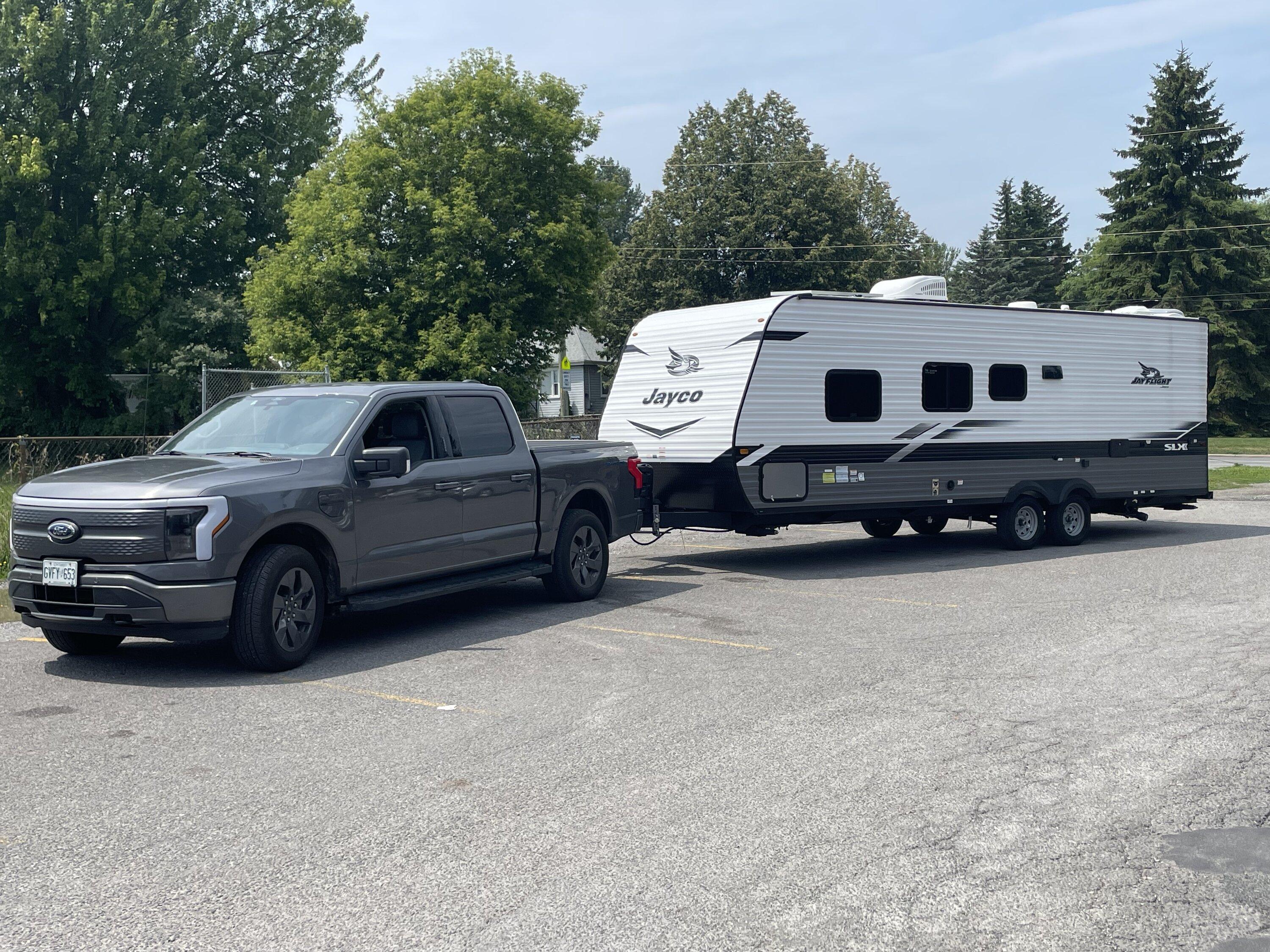

I was able to fully test the brake controller this weekend with this 26’ rental trailer. It worked great. The only downside I noticed was using cruise control on hilly roads, it would activate the brakes on downhills… it was a lot smoother to drive without cruise control the hilly sections.
