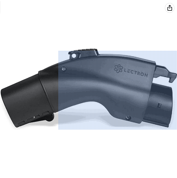

Has anyone tried out this Lectron adapter? The adapter plugs into the truck and the Tesla mobile adapter with a regular amount of force, but starts blinking red immediately and doesn't charge. The adapter works fine on my electric motorcycle, so I think the issue is the connection with the Lightning.

I'm using this adapter. So far it has been connected to the Tesla Corded Mobile Connector, which is like their normal mobile adapter, but hard-wired with a 14-50 plug and charges at 40A. It works with my Lightning just fine and charges at 40A. As to why it won't work with your truck, I'm not sure. Do you get any errors in the truck or in the FordPass app?
Screenshot 2023-01-15 at 14-17-47 Amazon.com Lectron Only for J1772 EVs Tesla to J1772 Chargin...png
Been using this plug for 4-5 months now. SOLID. My Tesla wall charger is on a 60A circuit breaker, so gets 48A to the vehicle and this works 100%. Checking your picture... there are a few models. Ready the details. I bought this one.
Working fine for me, though I've only used it for 120V so far.
Yes, I get a charging station fault error in the truck - but maybe I'm not seating it in far enough. I'll try again in the daylight.
https://www.amazon.com/gp/product/B09DCTJCTV/ref=ppx_yo_dt_b_search_asin_title?ie=UTF8&psc=1
Yep, that's the same one I bought. Glad to hear others have had success, and seeing that it works with my other J1772 vehicle I'm thinking maybe it's just not seated far enough in the Lightning.
