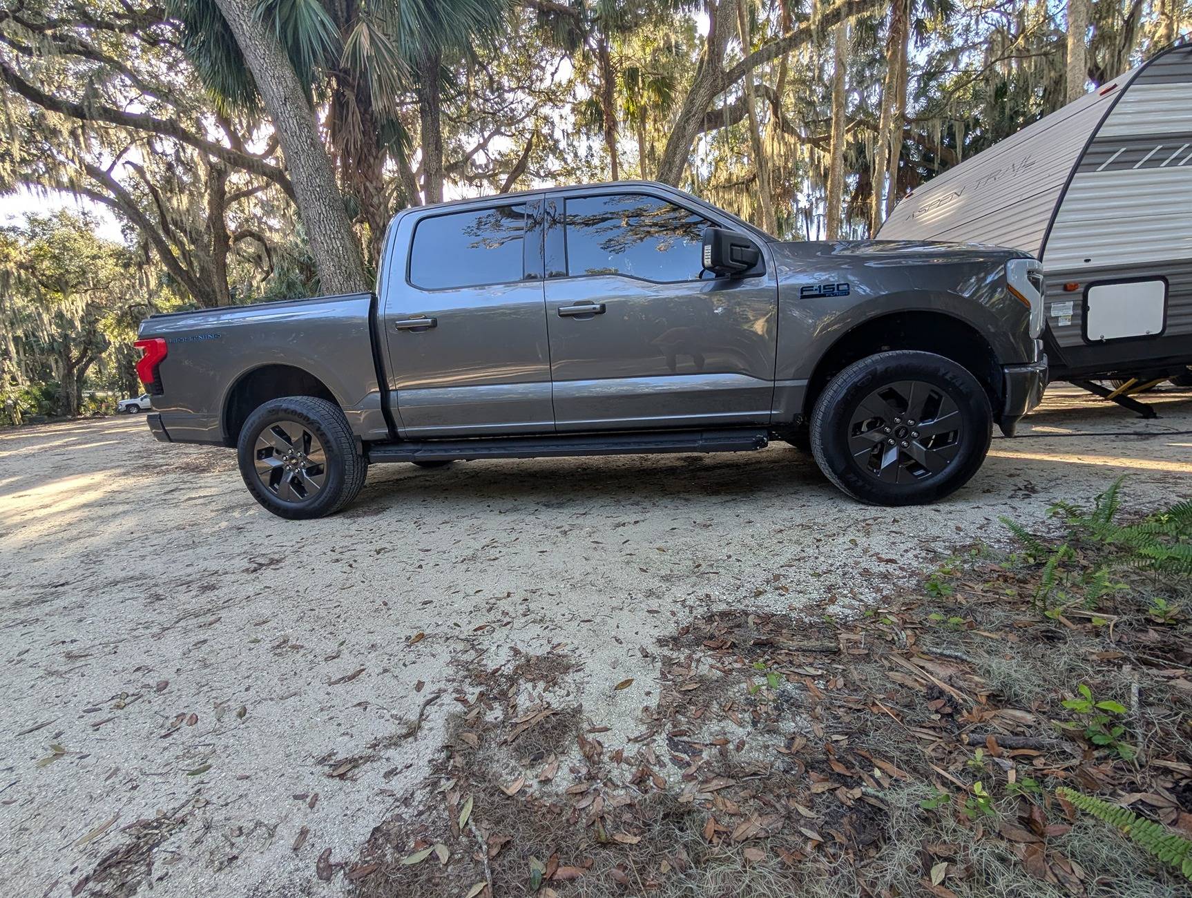

Had the 2" RC level kit installed earlier this week. Love the new stance. No real noticeable impact to the ride. I'd say range is about the same.
Ford F-150 Lightning Level kit installed - better range? PXL_20241110_134822872
