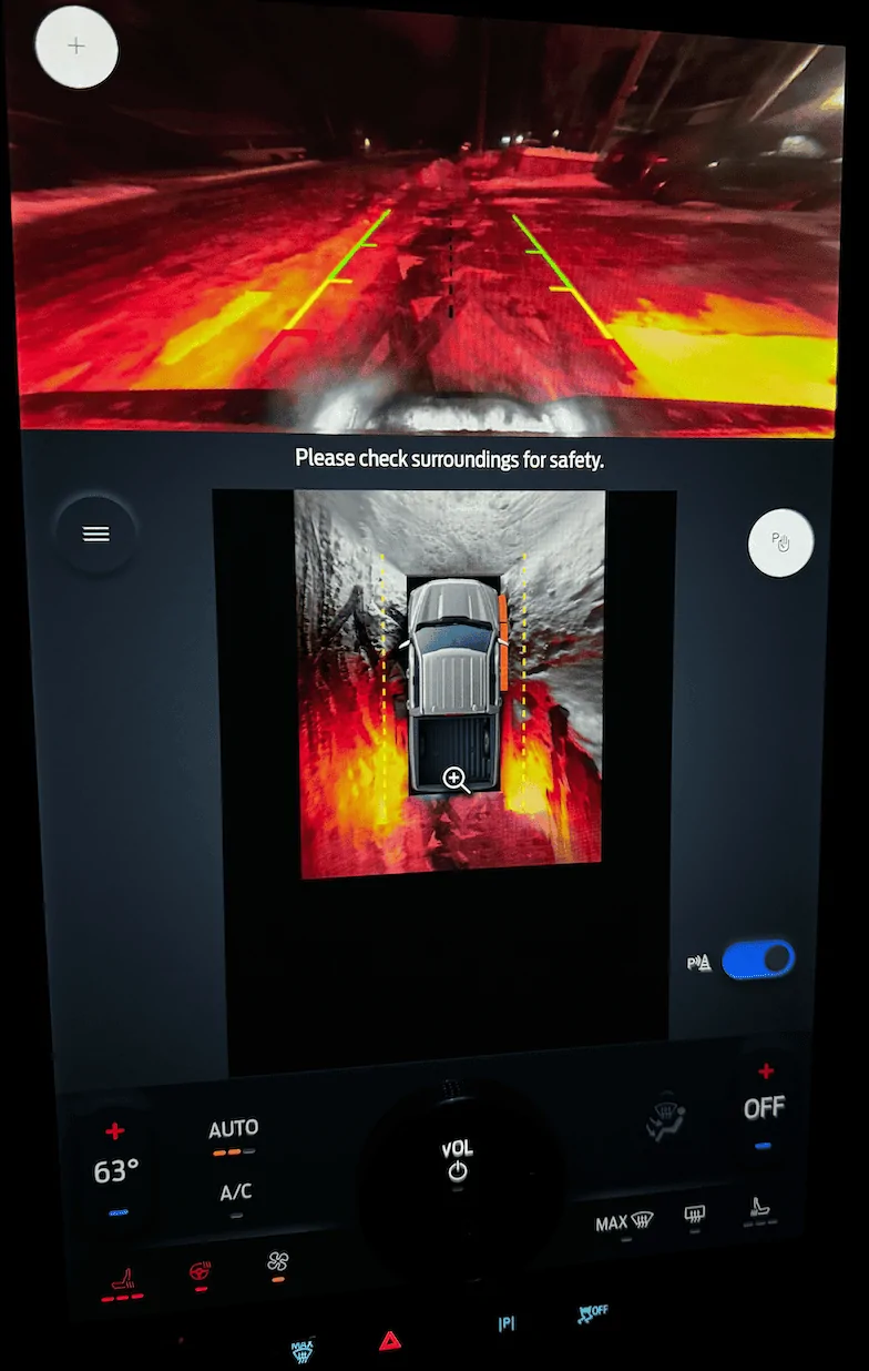

Yeah crap halfway through my update one of my 30A chargers blew a fuse and it was a bit of a pucker moment with just 30A, but I got through the update. It seemed like whenever voltage dropped to around 9V, I heard an electrical noise inside the truck and something kicked on that bumped it to 10-11V and then back down.
PSCM did need a PMI like Mike G mentioned for it to disappear from the update list. Other than that I didn't have any other faults or issues.
I am seeing this bug though where the 360 top down view appears to be undersized. The image itself shows correct alignment of the cameras and is otherwise correct, just somehow really small. Reverse lines are correctly drawing too. No DTCs. Not sure if this is an IPMA - APIM incompatibility that needs a future APIM update? I hope this isn't something that involves a PMI of IPMA....

@chillaban Called in the calvary to check on the issue. Trying to figure out what the issue is. Stand by.
This issue seems to be within the update itself. @ChrisCon reported the same thing when he did it to his truck here:
https://www.f150lightningforum.com/...programming-guide-using-fdrs.8249/post-360165
@MickeyAO Also reported this happening. I don't think that this is a change Ford wanted to execute as part of this update. You didn't do anything wrong and the update installed fine. There is no way to "fix" this because nothing is broken. Looks the error is on Ford's side.
