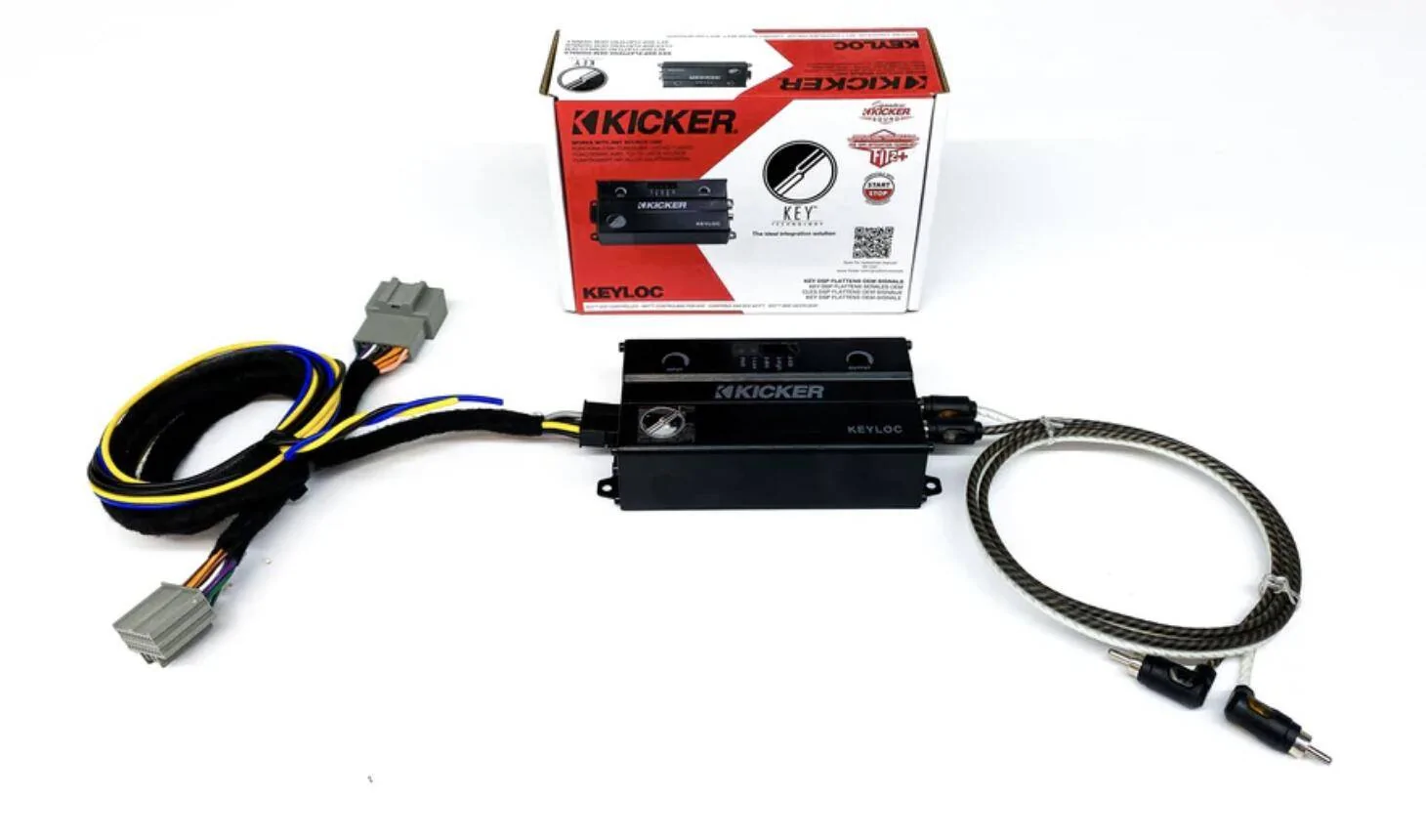

With my setup I didn't use it. The Keyloc uses side speakers input rather than the subwoofer to avoid the bass roll off
So in the picture below, the 2 RCAs are for the powered sub...what are the 2 gray molex for? Do those plug into the amp? Or do I have to splice into the side speaker output coming from the amp?

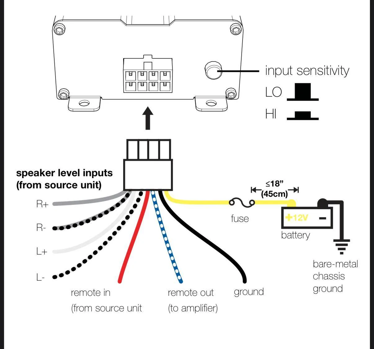

Regarding the KeyLoc, where is that image from? According to the manual the connector on the left is remote in and out, power, ground and stereo speaker level inputs. RCA on right go to an amp (or powered sub).
